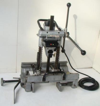

Does anyone know if their might be a supplier of used portable hollow chisel mortisers? I would be looking to use it for timber framing and a typical section of wood it would have to clamp to would be an 8"x8". I used a Hitachi once upon a time but it was a tad too small to handle an 8" section. I find them to be slower than a chain mortiser,( i have two of these and sold a third ) but more accurate and they leave a very clean mortise unlike the chain variety. A lot of the cutting will be done in cedar so i think that the chisel type mortiser could handle that. Also wondering if bits can be obtained as well? Thanks, John.

If you look at buying a new one, Makita makes a model, the 7305L, which can fit onto a 14.25" (363mm) timber. I could order one for you from Japan.

I imagine you could have one to your front door for around US$2000~2100, and I imagine Canada Customs will take their piece on top of that. A lot of machine for less than half of a Mafell. I think it comes with a 30mm chisel, which, to be honest, it has to work hard to push. A better choice for all-around use is the 24mm chisel. If you were to order the machine, it would make sense to pick up a few chisels to go with it, and these could be stuffed into the same shipping box as the mortiser.

The machines only come 100v., which works fine on 110~115v.
