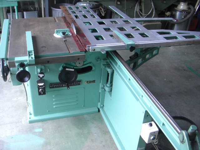

While I was visiting a shop in Long Island recently I noticed a couple of small jewel-like sliding tablesaws. The shop owner and his helper both remarked about how useful and well used the saws were. I was impressed and am now looking to obtain one of these saws. I think it would be the perfect choice for the majority of furniture work, and a good portion of architectural work as well. They are called 'Petty Work', which I guess is an attempt to render the term 'petite work' as the pronunciation between 'petite' and 'petty' probably sounds very close to a Japanese ear.

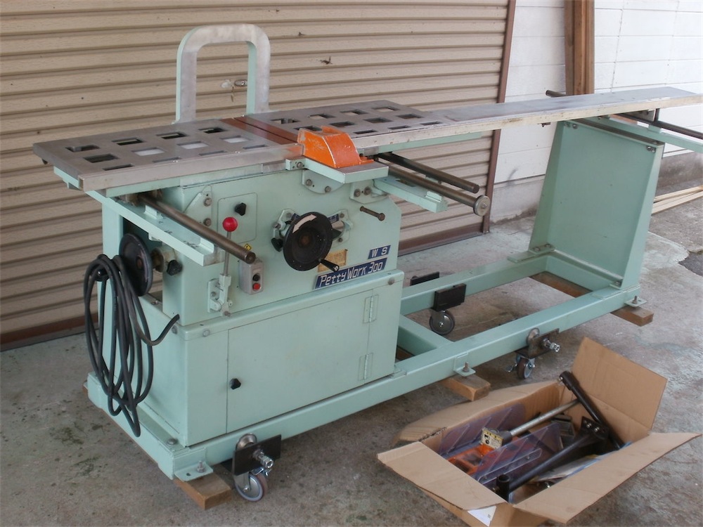

Here's one of the models, the PW300 WS:

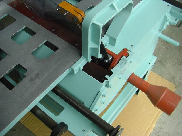

This saw weighs about 130kg. The entire table slides around the blade - essentially what you have here is a 'perfect' crosscut sled. There are phenolic inserts around the blade which can be replaced, and the saw is direct drive so it is extremely smooth in cutting. The handle on the front is a manual brake.

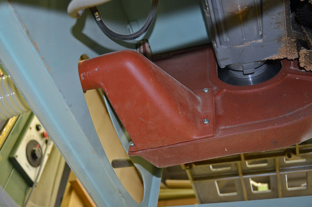

The saw blade is fully enclosed and thus dust collection is very good:
A view of the outlet side of the dust port:

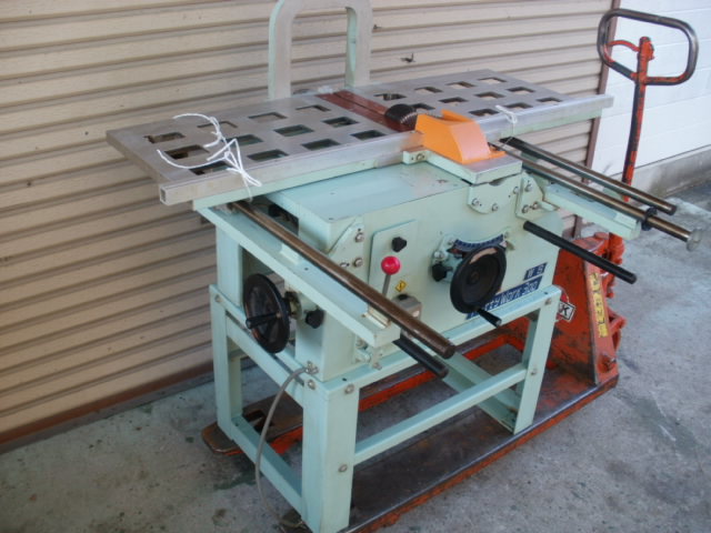

They also have a basic model where the sliding table is only on one side of the blade.

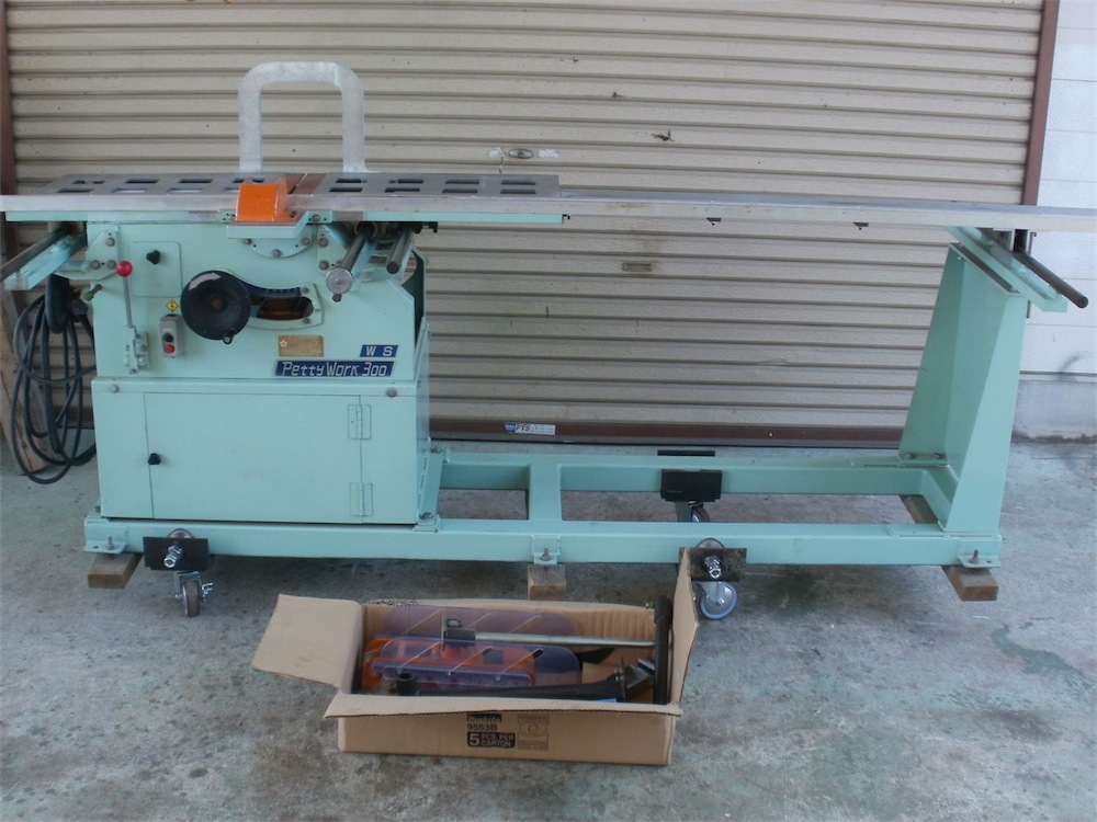

The model shown above can be outfitted, much like a sliding compound miter saw, with outrigger wing, also sliding, to handle longer stock:
There is another model with a sliding wing also out to the left side, giving a total cutting capacity of 4.2m.

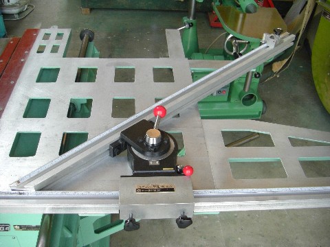

They make a fairly nice miter gauge for the saw:

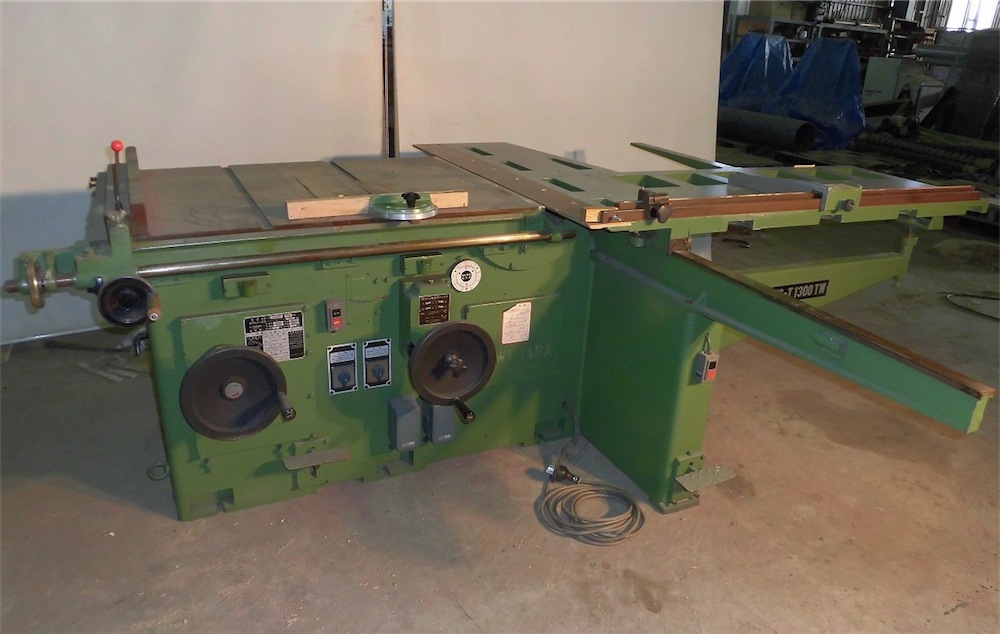

Ya got me - no idea. There are some Japanese tablesaws I have seen with two blades mounted, each with their own raise and tilt mechanism. One associates to the cross-cut slider, while the other presumably is for ripping. Like this Kuwahara for example:
Judging by the rip fence, the ripping is taking place to the right of the fence. Curious.

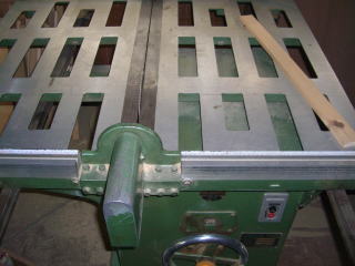

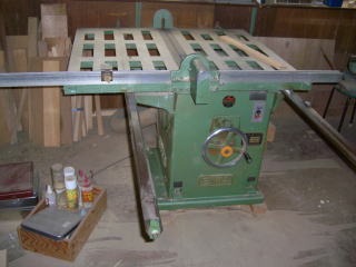

A related type of saw to the Petty Work 300 models, with a sliding table around both sides of the blade, is this Eiwa SCB-G14:
