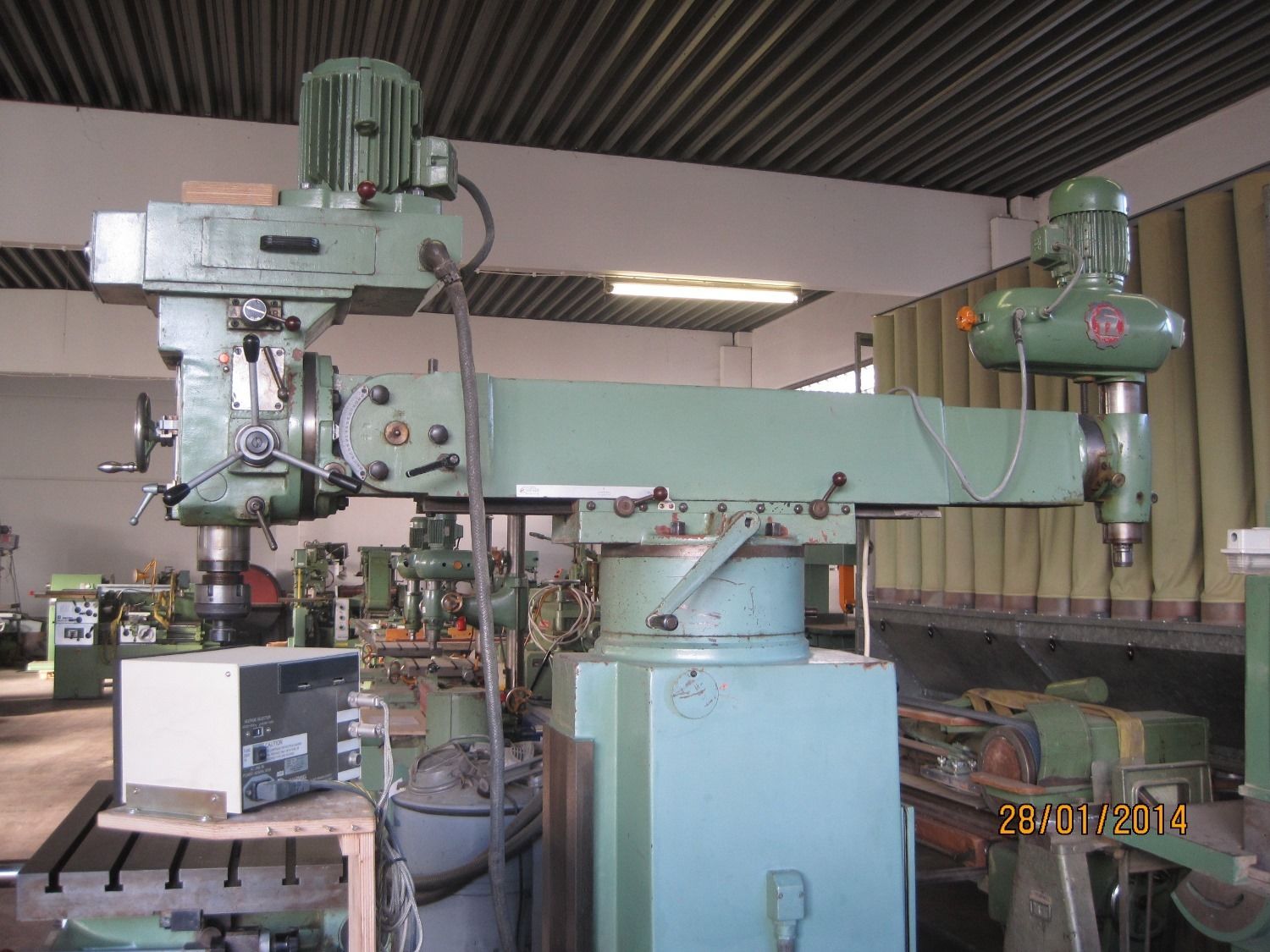

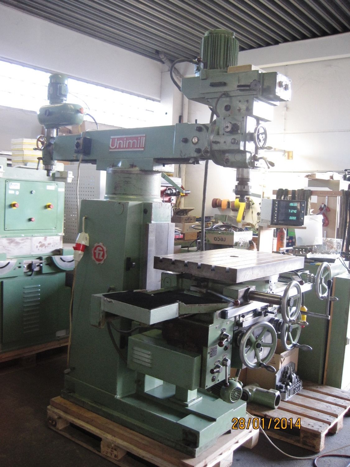

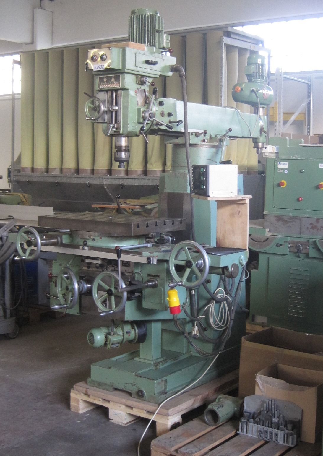

Currently drooling over this machine, 1971 vintage pattern maker's milling machine with dual heads:

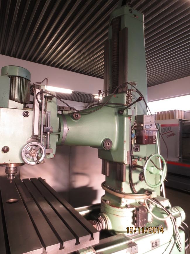

The rear head allows for high speed cutting, up to 14,000 rpm.

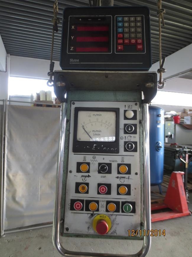

The DRO is mounted with some plywood, which is a little cheesy, but the rest of the machine is very nicely made.

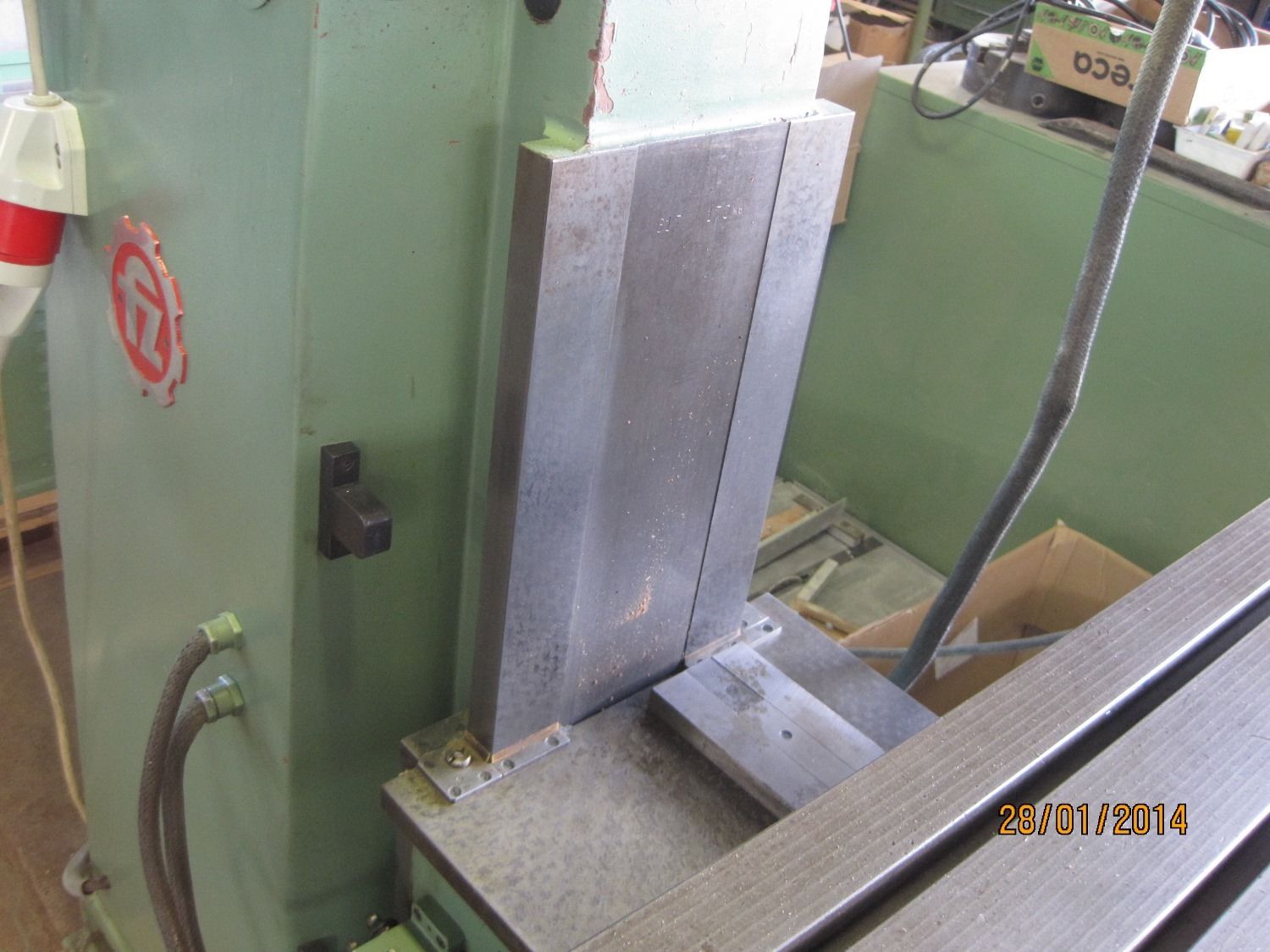

Scraped ways and planed machine table - marks of quality:
I can think of lots of things I could do with this machine, and I think it would work fine for metal too, up to a certain size. It's about $6700, so it is far from a casual purchase. It's been on the market a while.
Zimmermann made a series of pattern maker milling machines, of which the FZ-5V is the largest. Most of them do not come with the dual head however. they're still in business making woodworking machines, however the current version of the above machine is fully CNC now.

If I was back in toolmaking/diesinking and was outfitting a shop with manual machines, at that price, I would jump on that in a heartbeat. The way scraping looks very fresh and probably from original manufacture. Machines that had extensive use would show quiet a bit of wear there with exposed ways if it had been subject to metal cutting. That looks to be the same quality as what Deckel put into their machines, of which I ran a Deckel GK12 pantograph copy machine for 20 years. That machine was approx. $20,000 in 1980. It looks to be on the size of a Bridgeport Series I mill which has plenty of muscle. This machine looks to be quiet a bit more solid built than a Bridgeport and of typical German Quality. The high speed head on this machine is very desirable. The DRO has XYZ of which the Z axis doesn't have a cable attached. I would be asking information about the DRO if it is a retro fit or was installed by Zimmermann. I found Z axis on the knee very useful and productive. The integral rotating feature would be a plus for what I would be doing. I would guess that machine would have cost above $25,000 in 1980. Don't have a guess for 1971.

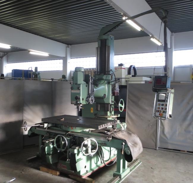

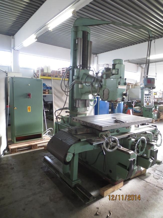

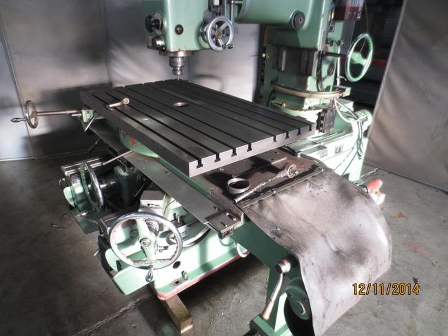

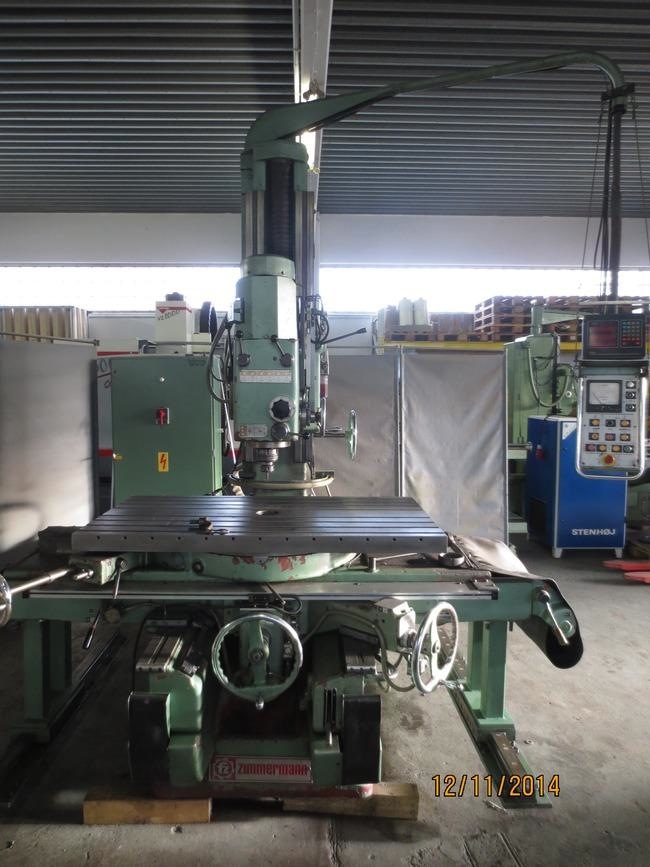

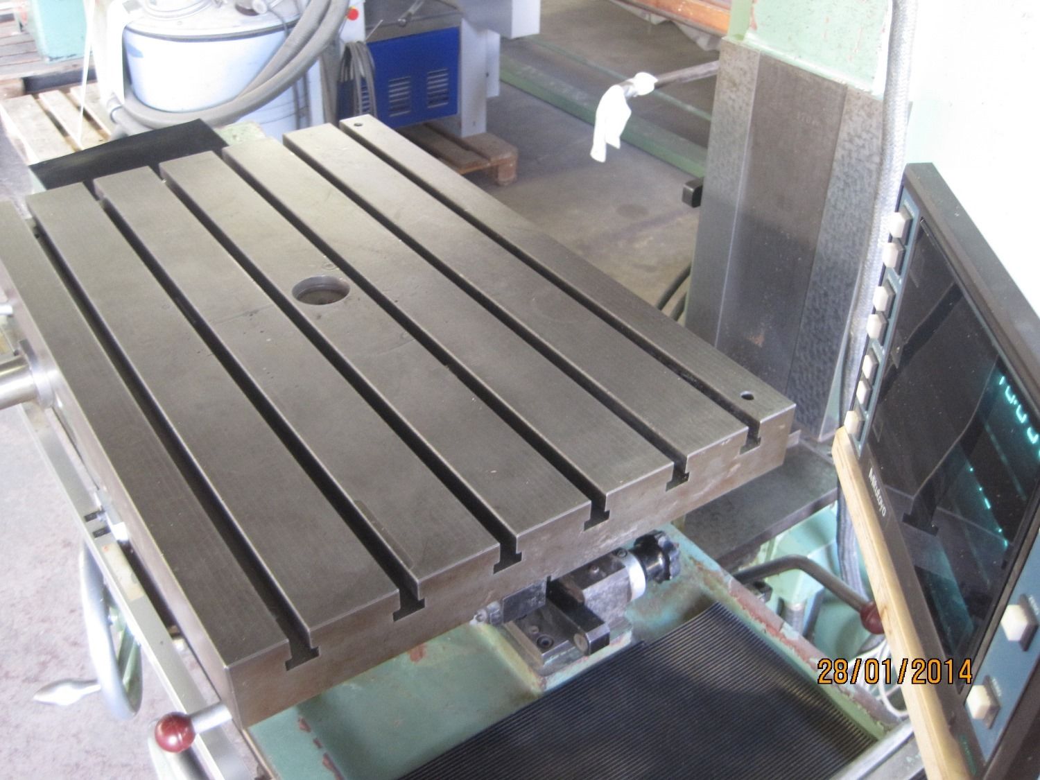

Here's another FZ-5 for sale, a 1980 model no high speed head, but huge vertical clearance, DRO tacked on top of the control panel, and only 3300 euros - that's just $4082:
That's a screaming deal as far as I am concerned.

Jack_Ervin. wrote:Chris,
If I was back in toolmaking/diesinking and was outfitting a shop with manual machines, at that price, I would jump on that in a heartbeat. The way scraping looks very fresh and probably from original manufacture. Machines that had extensive use would show quiet a bit of wear there with exposed ways if it had been subject to metal cutting. That looks to be the same quality as what Deckel put into their machines, of which I ran a Deckel GK12 pantograph copy machine for 20 years. That machine was approx. $20,000 in 1980. It looks to be on the size of a Bridgeport Series I mill which has plenty of muscle. This machine looks to be quite a bit more solid built than a Bridgeport and of typical German Quality. The high speed head on this machine is very desirable. The DRO has XYZ of which the Z axis doesn't have a cable attached. I would be asking information about the DRO if it is a retro fit or was installed by Zimmermann. I found Z axis on the knee very useful and productive. The integral rotating feature would be a plus for what I would be doing. I would guess that machine would have cost above $25,000 in 1980. Don't have a guess for 1971.
I am a bit familiar with Deckel machines. There are a few for sale on Ebay, and they have some wild accessories. I agree that the FZ-5 looks to be in excellent shape. I've noticed most older German machines are in similarly decent shape. Run by skilled tradespeople for years and looked after with proper maintenance.
I'm sure the DRO was added by the previous owner. Zimmermann would never set things up like that.

My observation is by the photos since both are FZ-5's. The second machine has outrigger table supports which will need to be floor mounted and leveled to the machine (three pieces of equipment and on a stable floor). This being said longer work pieces needing support would remain static in the Z. Also the Y travel definately has more capacity. The second machine definately has a larger XYZ envelope. I can see the scale for the Z travel though is mounted on the head and not on the column so there is a shorter measured travel at the DRO.
The Z positioning on the first machine is on the knee and the table has to move in relation to the floor. Any overhanging workpiece needing support will need adjustment on the outboard support as the Z table movement changes.
The high speed spindle is definitely a bonus though. Collet sizes for those quick change holders are usualy universally available to suit cutters both metric and inch.
