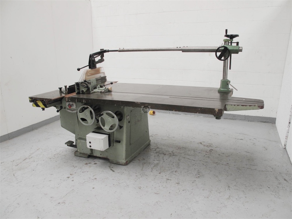

I'm back from vacation now, and while I was away I managed to acquire a table saw from the UK:
It's a Wadkin PP 450mm dimension saw, probably made in the 1960's. The long table is supposed to have a couple of support legs, included with the saw, but they left them out for the photo shoot. This is a traditional joiner's/pattern-makers saw, and has a tilting fence with micro-adjustment. So, the blade tilts, the rip fence tilts, and the miter fence can be angled, making it quite versatile.
I was not heading in a direction towards buying an older saw, however this is where I ended up. I'll post more on the Carpentry Way blog in a few days about the process and rationale behind the purchase.
Another photos - this machine has the extra long sliding table and extra long main table. The arbor is 1.25" and it can accept up to an 18" (450mm) blade. It has a max depth of cut of 5.5" and no scoring since it is not intended for sheet goods:
I am expecting that it will work decently upon arrival, and plan to do a bit of refurbishment when time allows. At long last I have a table saw!

I look forward to seeing your refurb and I'm interested in hearing why you chose this one. It looks like a great saw, I wish they could be sourced in the states.
Re: Wadkin
Well, i'll explain more in my upcoming blog post, but these machines were exported to the US and Canada, though not in large numbers it would appear. I actually became more aware of this machine after one was posted up for sale in Indiana a few weeks back. I decided to pass on that machine as it was not in the best condition. Anyway, these machines are out there, and in any case, the issues involved in getting one from Britain (they are not exactly abundant there mind you) to the US are not insurmountable by any means.Chris Pyle wrote:I look forward to seeing your refurb and I'm interested in hearing why you chose this one. It looks like a great saw, I wish they could be sourced in the states.

Wadkin 450 Dimension saw is crated and will be shipped from the UK on the 14th. Arrives in New York on the 22nd, and Boston on the 28th. Hoping to have it in my shop shortly after that.
I have been impressed with the seller, Scott and Sargeant Woodworking machines, based in or around London. By all accounts they've done a thorough job getting the machine ready to ship.
