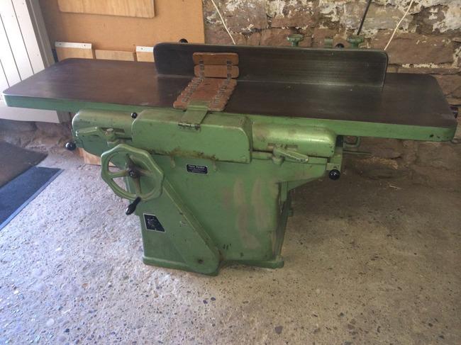

To play off Chris' recent A New Combo post, here's a combo that seems far more plausible in practice: the Wadkin over/under patternmaker's jointer-planer.
Wadkin RM 26" over under jointer demo (video)
The video's a touch long, but has a nice walkthrough of this machine and some discussion of its restoration. From skimming through the video, the over/under setup here seems nicer than many of the modern convertible jointer/planer combos. If the ideal of the combo machine is two machines in the same space, but as convenient to use as separates, this hits closer to the mark than most I've seen.

Yeah, i'm familiar with that machine and have read Jack's rebuild.
The stumble-down point for me with that particular over/under is there is no chip collection. The planer will just spray chips everywhere. After you use the jointer, the planer tables will be covered with chips and have to be swept off before use. That would get old after a while I think.
Wadkin made good equipment, but I think there are better designs out there for jointer/planer combo machines.

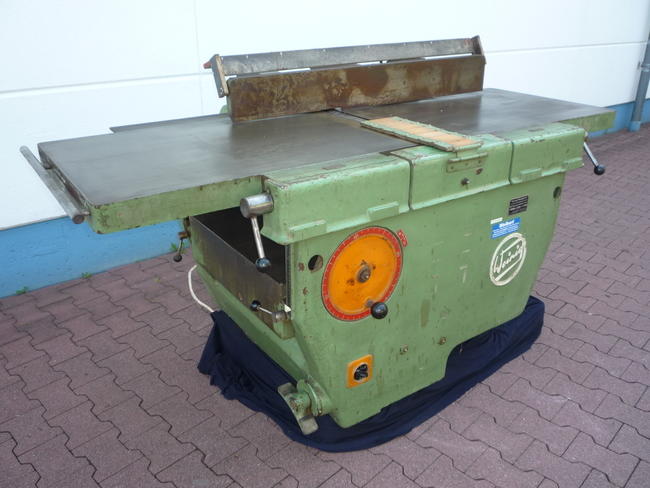

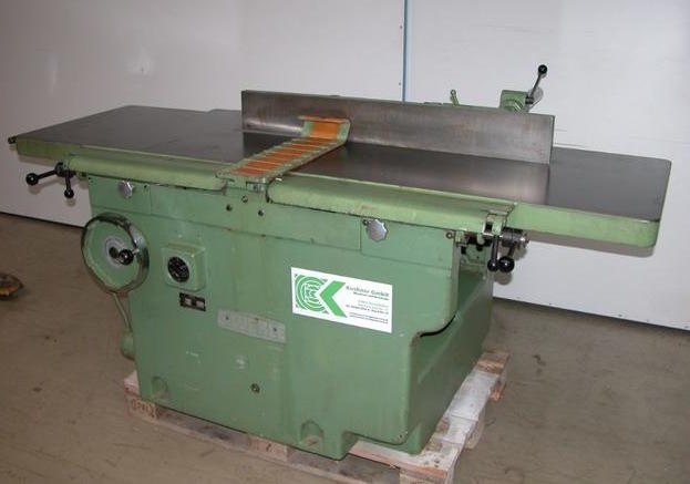

If you're looking at jointer planer combos, Germany produced various models:
Baeurle:
Loewer:
Weinig:

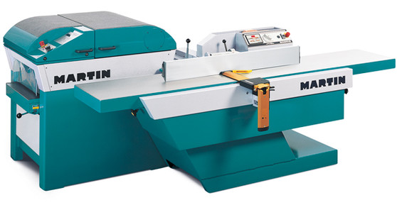

Having had a combo machine before (Felder) and used a Japanese combo planer jointer, my thought is that of the two main types of jointer/planer machine, the side-by-side type offers certain advantages (chip collection, not having to worry about losing previous settings with the planer when changing between functions), however side by side always means a wider machine than the over/under type of machine. If space is at an absolute premium, then the over/under type would be the route to take.
But if a wider envelope is okay, then one could also look at nesting a separate jointer with a separate planer in the same arrangement - -at least with Martin, where they are designed to nest back to back and offset:
Of course, that isn't going to be an option for too many people given the sky-high cost.
