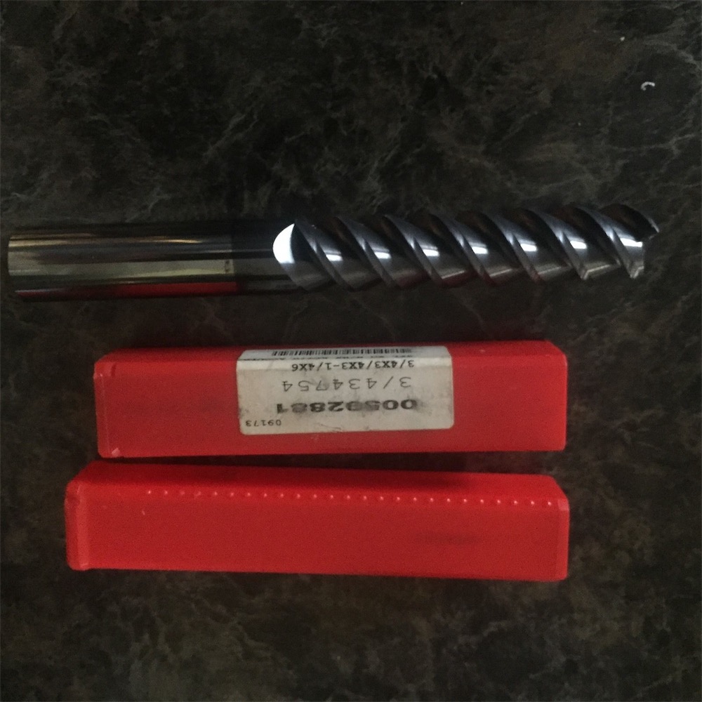

It did occur to me that those high helix mills, like this...
...would be poor for wood routing in most grain orientations, save for one: end grain. It should work very well for that.
