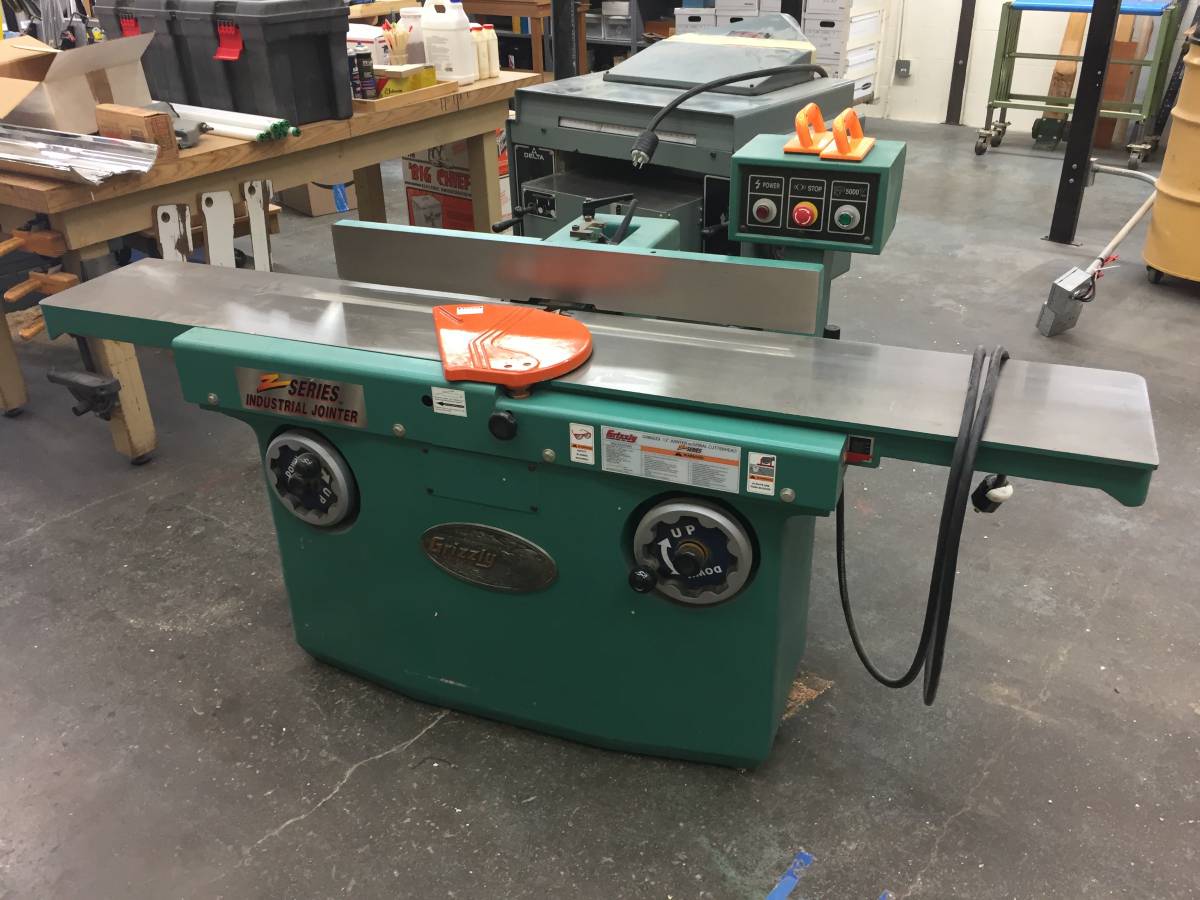

Round One: Ye Olde Craigslist has borne fruit, by way of a 12" jointer with a helical head, shown here in its old location. I'm now officially safe from accidentally getting tangled up with a J-P combo machine.
Due to time constraints (i.e. be first in hand with cash), I ended up paying a bit more than I would have liked for a crane truck, but still no complaints about the overall deal.
It's currently sitting on pipes in my rather disordered shop. I'm looking into options for moving it around. An engine hoist may factor into this, and/or some Zambus casters. Fortunately, the bottom castings have slots for casters which are easily accessible from the sides.
