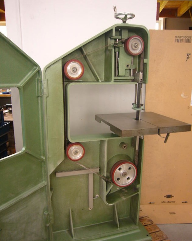

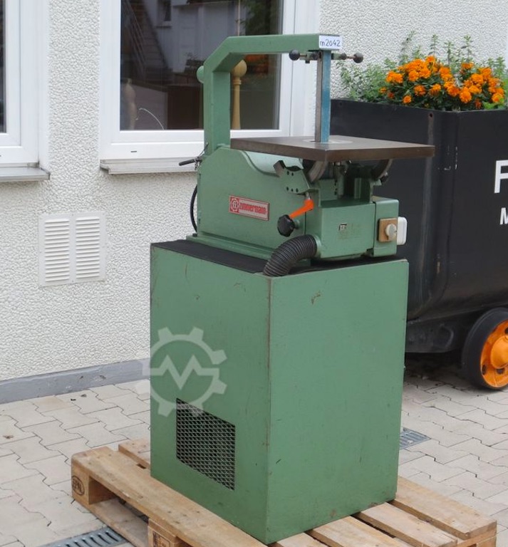

With the many months of working bubinga and shedua on the cabinet, and more work on teak wheelbarrow #4 coming up, I've come to be interested in getting a small sanding machine for curved parts. For the longest time I have been looking at oscillating spindle sanders, aka bobbin sanders, however in the past half I year I have become aware of a type of Zimmermann sanding machine for shaping and profiling curved parts - the 'PS' for Profile Sander. They made a few different models of it. The smallest is the PS-0, which mounts atop a table. Then there is the PS-R, which is the same machine on a cabinet with vacuum built in and with switchable oscillation of the belt.

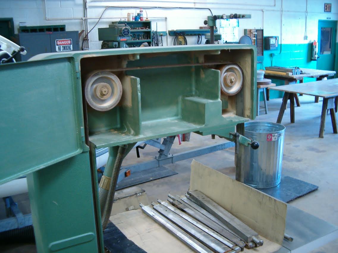

With the door open, you can see how the belt is routed - note that it goes up and over and down the bar fitted vertically to the work table:

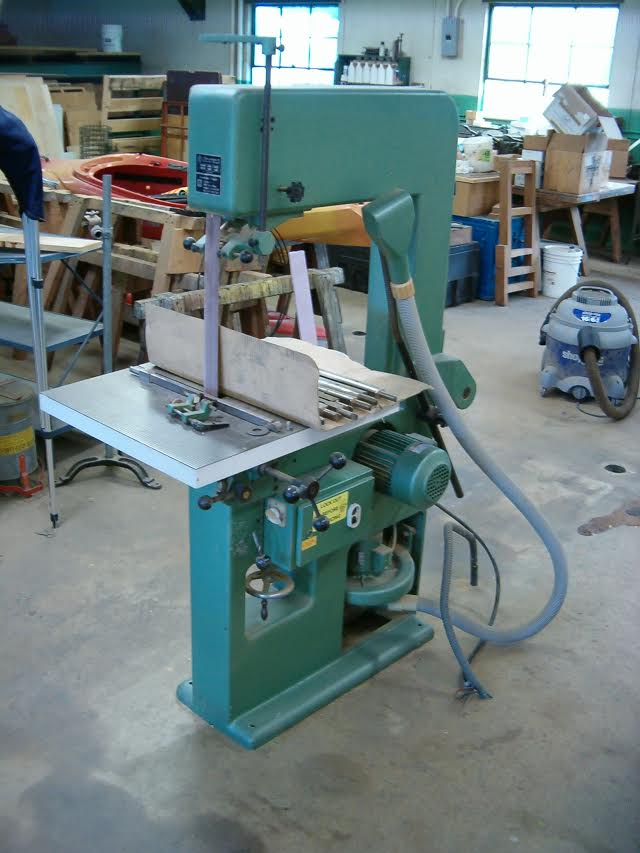

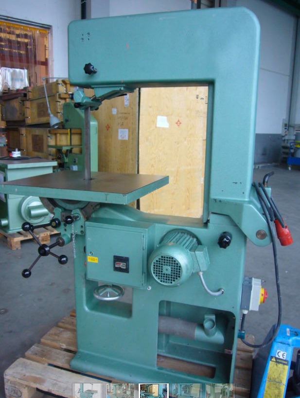

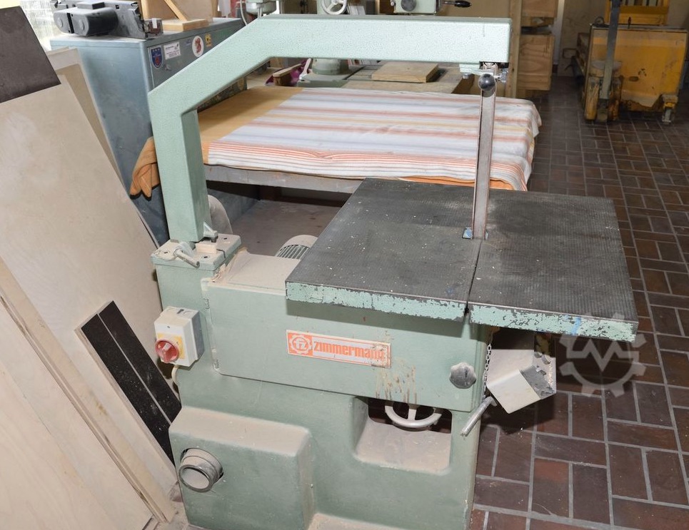

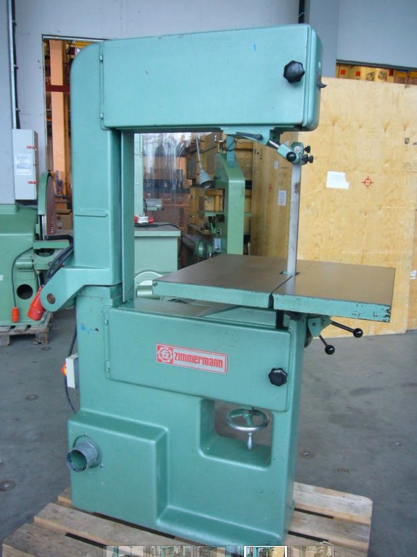

The next largest machine in the PS lineup is the PS-S (Standard), which has all the appearance of a bandsaw:
Zimmermann PS-S.jpeg (47.6 KiB) Viewed 54014 times
Clogging of a sanding belt, by the way, is one of the reasons this sort of machine may be preferred to a bobbin sander. Having a much, much greater abrading length means the belt on the larger PS machine runs cooler and lasts much longer:
Zimmermann PS-S (II).jpeg (86.79 KiB) Viewed 54014 times
Notice that the dust cover for the machine internals is cast iron.

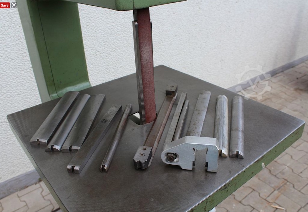

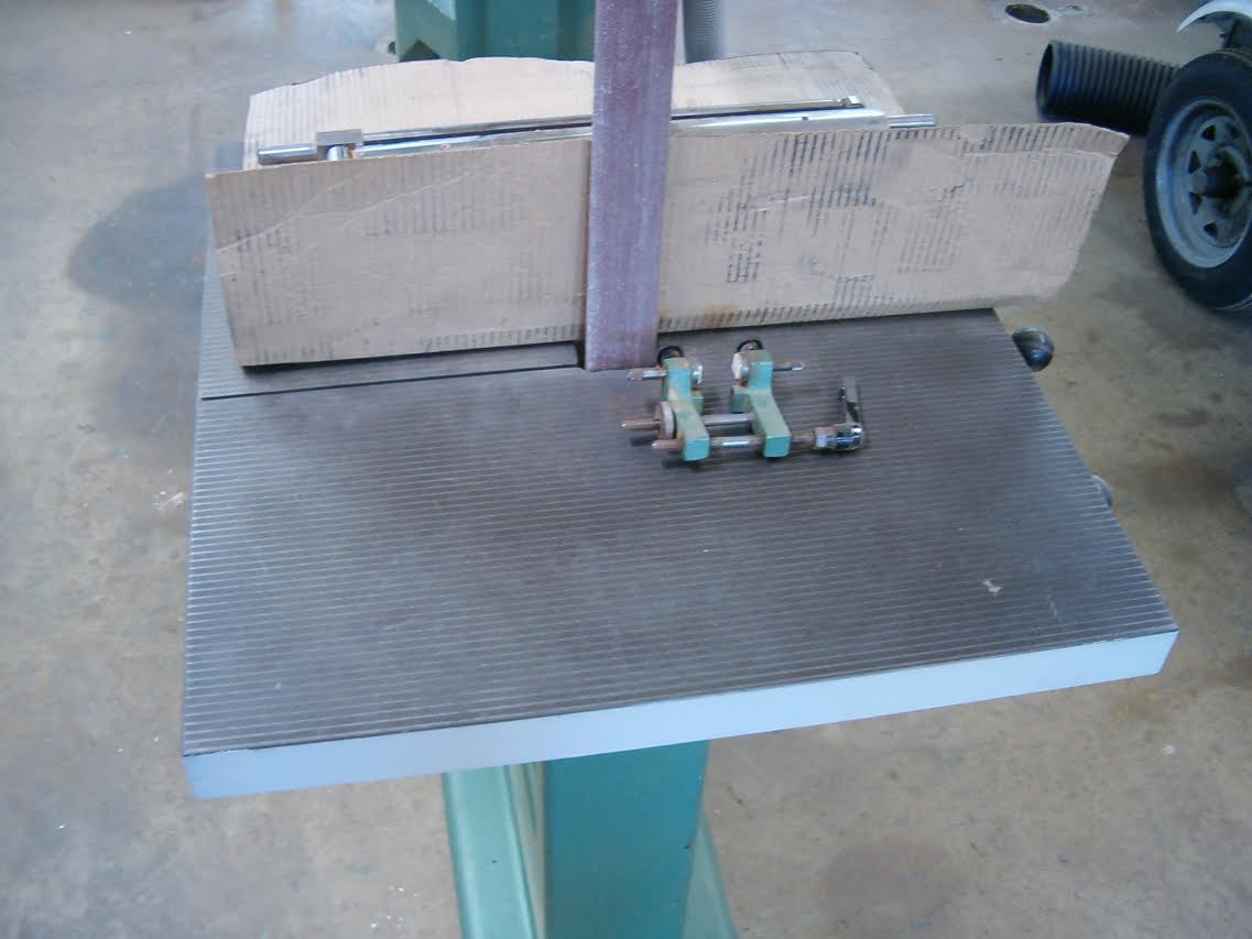

Here's a detail showing a selection of different profile bars - many of the machines i have seen for sale in Europe however do not come with the different bars:

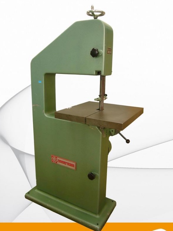

Then there is the PS-1, which only routes the sanding belt from below, however the overhead arm can be swung back, so as to allow the sanding of inside curves:
At the top of the range is the PS-1/2, which is a heavier duty version of the PS-1:

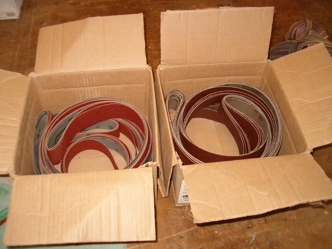

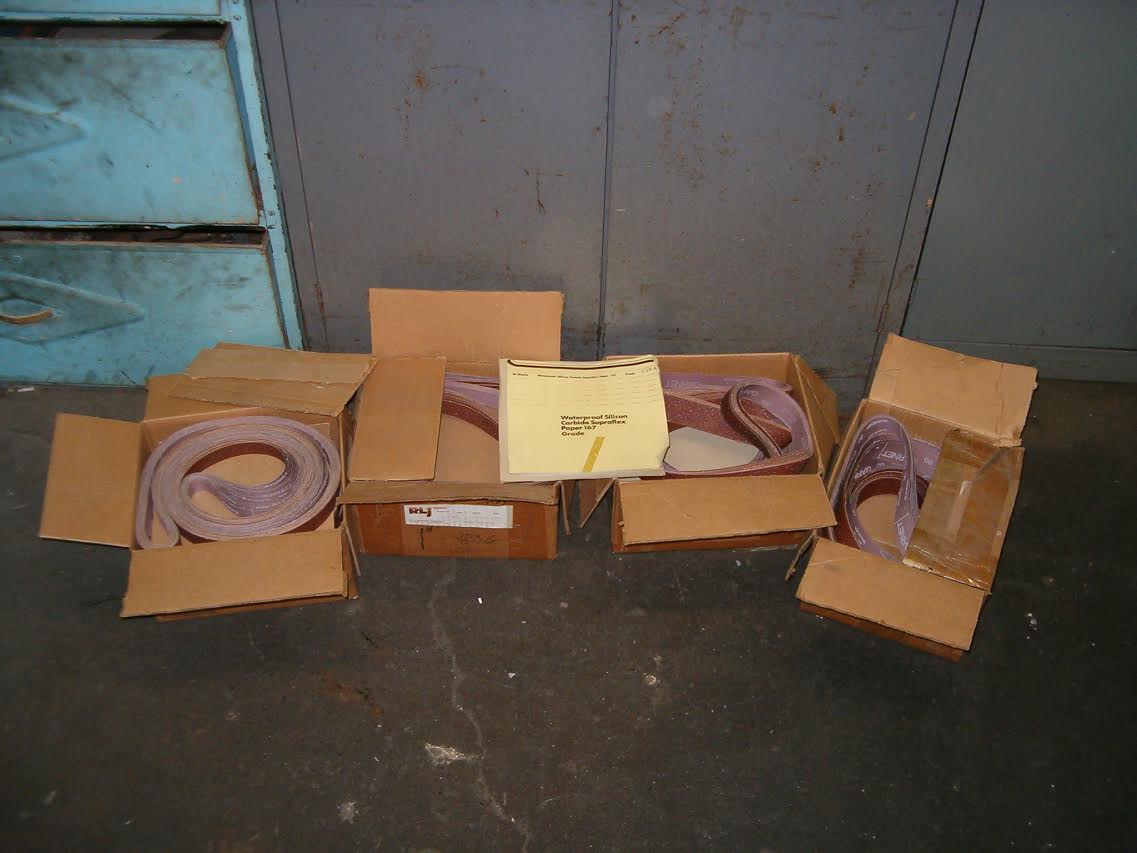

Believe it or not, I have made arrangements to buy a very nice PS-1/2, and it doesn't even involve importing from Europe. I found one down in PA, and it was purchased new in 1977 or so by a pattern shop, used only on one job. And it is loaded with accessory bars, and many many spare belts:
The table has a perfect planed finish and next to no wear:
I am not exactly flush with cash at the moment, however this is the first one of these I had ever seen come up for sale, and the price was reasonable at $3000, especially considering it's mind condition and that it would cost me twice that to import one from Europe (which effectively means I would be unlikely to ever make such an acquisition). So, I felt I had to find a way to swing it or I would likely never get the chance again. The seller, who was retiring from the business, agreed to a payment plan, and I have sent him a deposit, and hope to have it paid off in 3~4 months.

Thanks for posting about these, Chris. The pics of the profile bars are quite interesting, and answer a question which came to mind along the lines of "how does this differ from a belt grinder" re: the platen arrangement.
Re: Another Zimmermann
Wed Jul 26, 2017 5:41 pm
John Whitley wrote: ↑
Wed Jul 26, 2017 4:00 pm
Yes, the different profiles of platen that can be fitted is one thing, plus the longer length of abrasive belt than most vertical belt grinders, and the capacity, with the PS-1/2, to be changed between 'bandsaw mode' and having the upper half swung out of the way, the belt running up and over the platen, so as to allow shaping the inside of circular objects.
And it is made very nicely, as the cast iron covers over the machine internals, and planed work table suggest.
