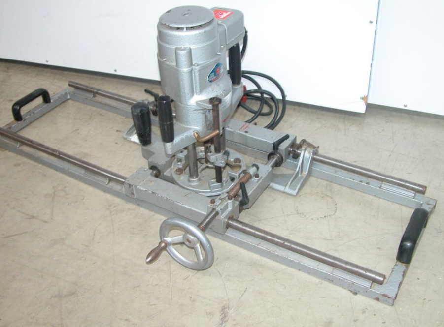

Are you only considering handheld power planers for this task? I think there are better options - something like this:
You have a milling machine, and know how to use it. You can readily buy extrusions, aluminum billet and linear slides online...
