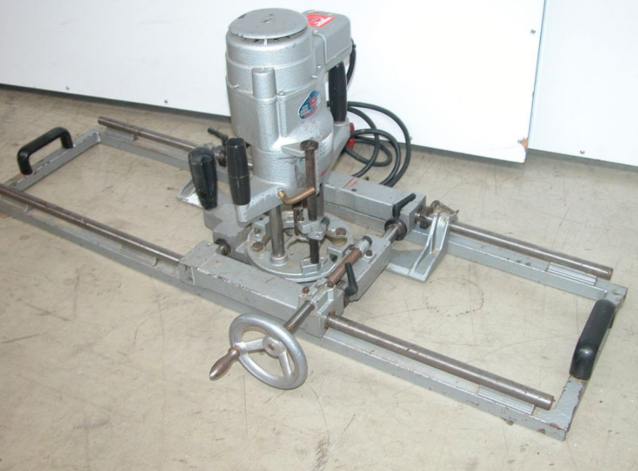

Are you only considering handheld power planers for this task? I think there are better options - something like this:
You have a milling machine, and know how to use it. You can readily buy extrusions, aluminum billet and linear slides online...

Thanks for the suggestion Chris! I thought to use the router sled, but there is a place near me that surfaces slabs with a router sled pretty regularly and they seem to be moving away from it. There is another that uses CNC and also complains that when the slab releases tension it can make the job a bit of mess and quite long, which is why I assume the router sled guys are moving away from it. I do the work by hand currently so I'm comfortable working with winding sticks and straight edges and so I was thinking just speeding that process up a bit might be the ticket.
I don't work so many slabs to the point where I really want dedicated equipment for it, so I had thought the power planer seemed like a handy thing to have.
