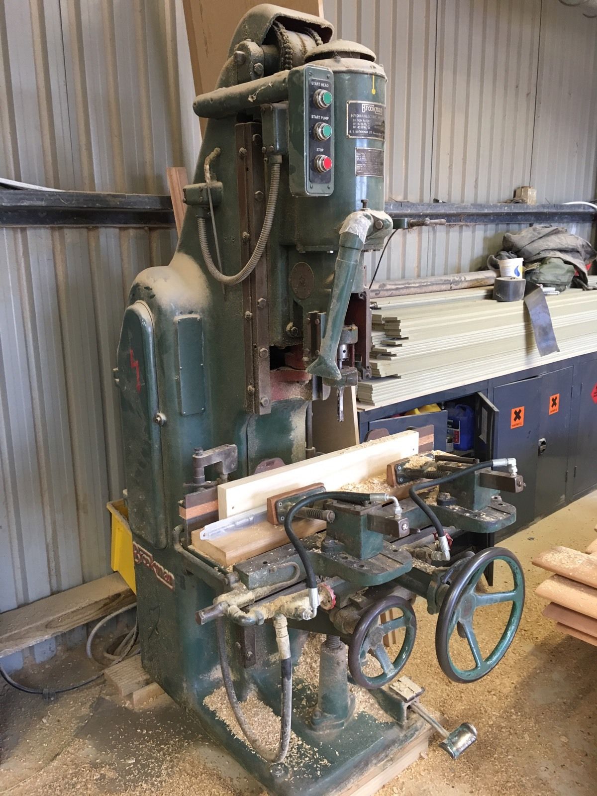

There's another British machine though, made by Brookman, a company otherwise known for their dovetailing machines, and that is the ULH 'Hydraulectric' mortiser. This machine is very heavily built and I find it quite appealing.
Here's a nice looking example listed on a British used machinery site:
This one is fitted with the 'electromatic' device fitted to the top of the head, and optional extra. Otherwise, mortising is controlled via the 4-position foot pedal, which can swing to left and right modes. The wood clamping is hydraulic, as is the head raise/lower, and for some reason this one has just a single table clamp, when there are supposed to be two horizontal ones and two vertical ones. The cap covering the top sprockets and chain appears to be missing as well.
I've asked the company selling the above machine several times for a price but they never reply.

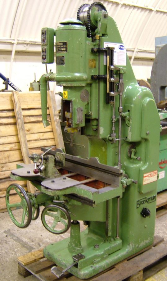

Today, while searching for the machine again, I came across one which had been on Ebay.uk last year and had not sold:
This machine looks quite original, unmolested, and complete. I took a chance and contacted the seller to see if he had sold it or not and he replied and still has the machine, having only tried once with an Ebay auction. So, we're discussing further. He runs a joinery business but their business has shifted over mostly to making European-type windows, which use bridle jointed corner joints instead of mortise and tenon, so they just haven't been using the machine at all and it takes up a lot of room. We'll see where this leads. He asked me to make an offer - how much do you think it is worth?

I have looked in vain to find any sort of recent sales history for the Brookman, and I guess they are very uncommon. All i know is that the fellow with the machine for sale had only received bids up to 500£, and that had not met his reserve.
And yes, shipping and crating are going to take a bite.
At this point the machine looks great, however i notice it does not seem to have any provision for doing angled mortises, which I do make from time to time, however 90% or more the mortising tackled is 90˚ of course.

I'm still waiting on pictures and a video from the seller of the Brookman, but I'm starting to think that the lack of a table which can be inclined is going to be too much of a negative in regards to that machine. I've contacted the distributor for Hofmann machines in the US and have asked them to ask the company if they would provide a hollow chisel attachment for their slot mortising machine. I reckon they make the best slot mortising machine. Buying a new machine might be the way to go for peace of mind.

And with the Brookman, besides the purchase price - which I kinda hope would be in the 1000~2000£ range, is that crating and shipping will be on top, so it is likely to be costing over that $5000 mark when all is said and done. I'm still interested in it though, nothing has been ruled out yet.

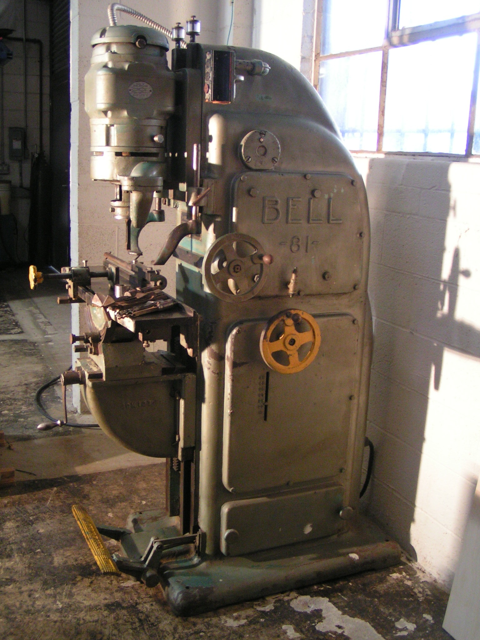

Another conventional chisel mortising machine I have thought looked good is a Bell#81, but these seem to be quite rare:
How's that for stout?! I've only ever come across one of these for sale, and of course didn't have the money at the time. Can't find any info on the machine otherwise.
