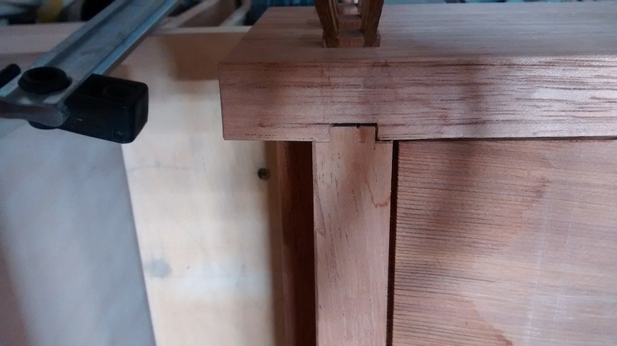

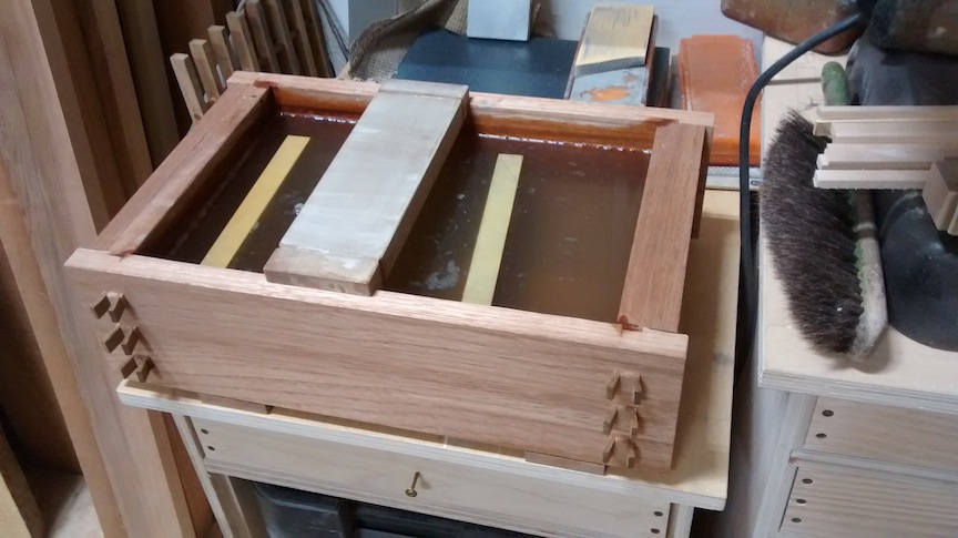

Well I'm on to version two of my sharpening pond with a few improvements over my previous attempt. I used to spanish cedar that I milled to 7/8 thick. The thicker sides allowed me to increase the depth of the dado in the long sides that the short sides are let into. I also did a better job with the joinery, and made the joints on the tight side, getting a good interference fit between the side connections as well with the fit of the bottom. And I went with 1:10 wedges this time, per Chris's recommendation. The wedges look extra fat in the photos since I haven't cut them flush with the tenons yet, and I made them extra long in case I felt the need to disassemble things.

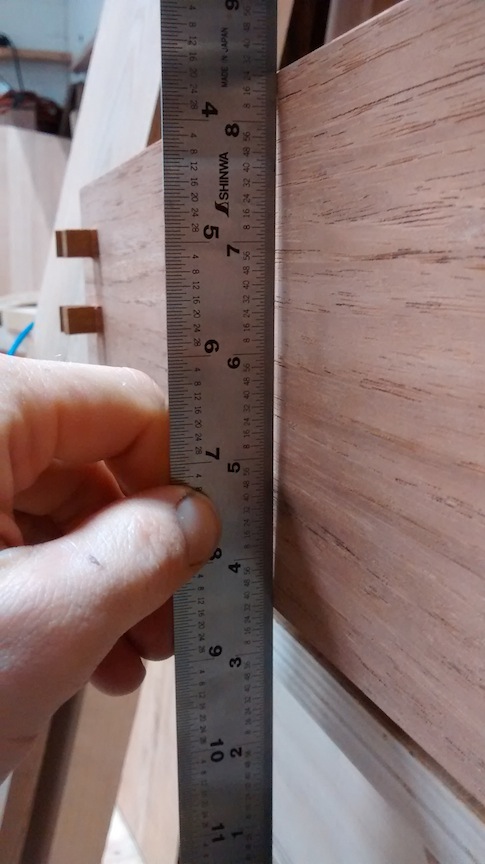

Initially after assembling I had a really solid water tight box, but after four days the sides began to cup noticeably, resulting in the joints opening slightly and now I have leaks
I'm going to keep using it for now, and see if it gets much worse... or hopefully stops, but I'm beginning to question the validity of making a box to hold water using wedged tenons, and can see how a box made with sliding dovetailed sides would have some big advantages. Namely the fact that when the sides start cupping on a box with wedged tenons, even when let into a dado as I did, the joints naturally open up. Whereas the same situation with cupping sides locked together with sliding dovetails should just further tighten the joints... or that's what I predict anyways.
I may be on to round three at some point here in the near future, and if I get there I'm going to give the sliding dovetails a try.

- This joint was tight after initial assembly.
