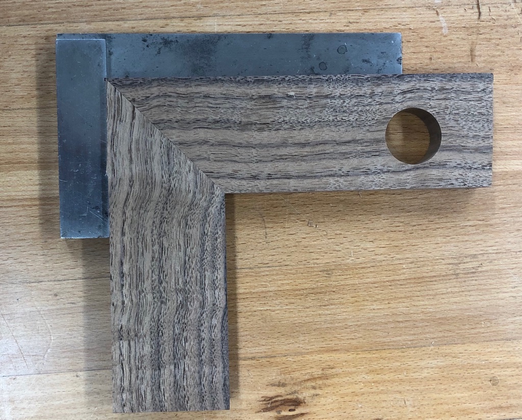

The key to using it efficiently is to make sure the 90 and 45 degree surfaces are dead accurate, level, and flat since they are the reference surfaces for paring or planing. I had access to a vernier protractor to check within 12 minutes of a degree but other tools or methods might work as well.

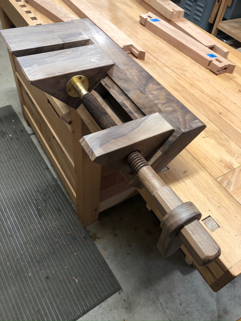

Set up for 45 degrees.

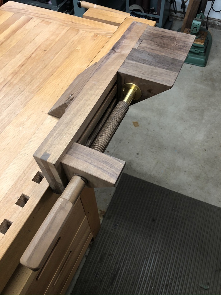

Flipped over for 90 degrees

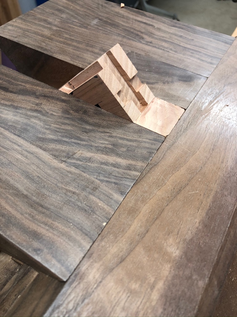

Paring a miter:

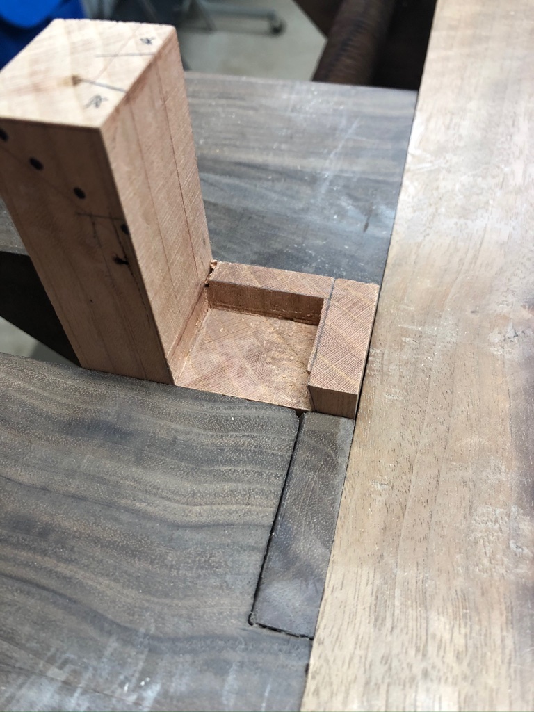

Paring into a blind pocket:
