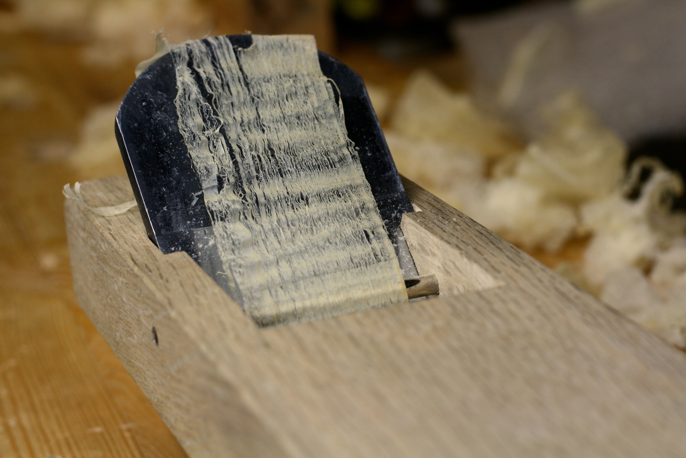

Still lots of tuning and no chip breaker yet, but getting there. Sharpening needs to be a lot better.
