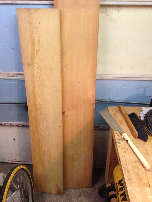

I used pine, 1/2" rift sawn on the left and 3/4" quarter sawn on the right.
hopper 15.jpg (102.32 KiB) Viewed 30678 times

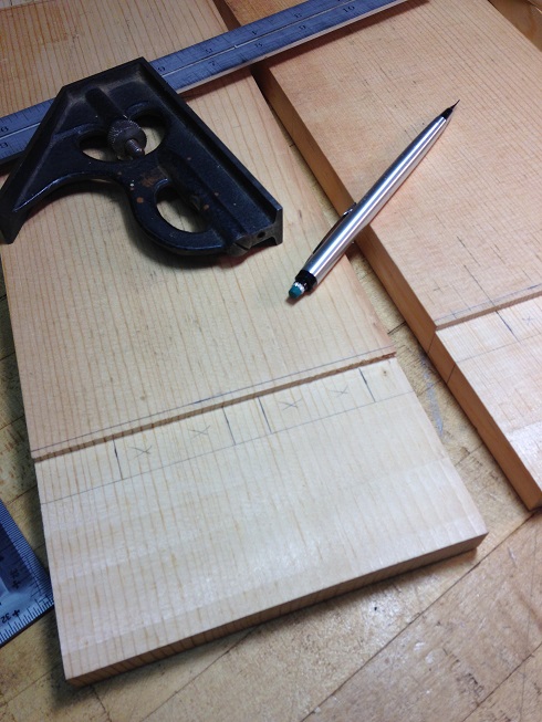

Tenons marked.
hopper 14.jpg (81.29 KiB) Viewed 30678 times
Mortises marked.
hopper 13.jpg (124.72 KiB) Viewed 30678 times

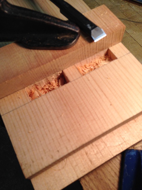

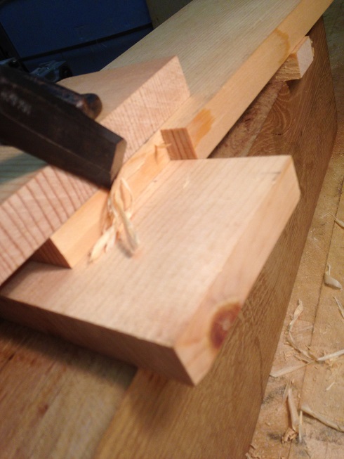

Using a chop block to true the tenons.
hopper 12.jpg (86.2 KiB) Viewed 30678 times
Chopping the mortises.
hopper 11.jpg (83.03 KiB) Viewed 30678 times

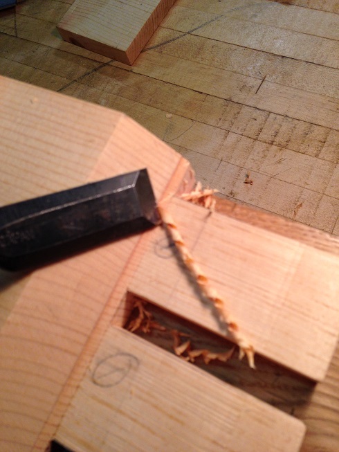

Using 45 degree block to cut mitered portion on both sides of joint.
hopper 10.jpg (99.64 KiB) Viewed 30678 times

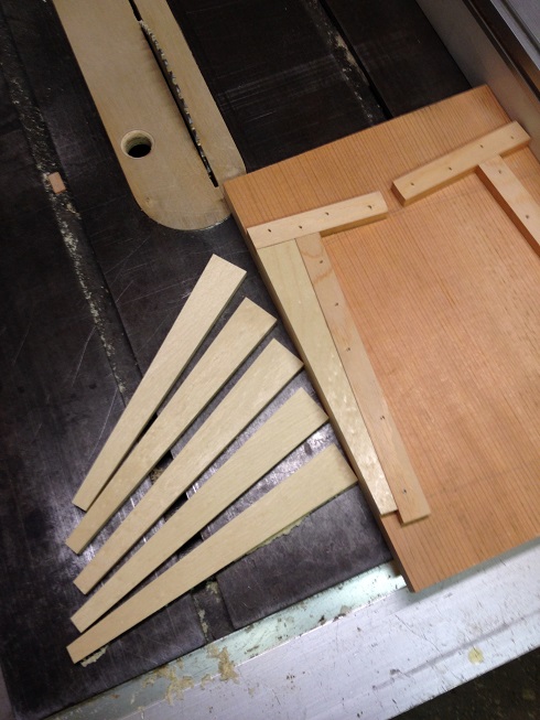

Using a quick sled to cut consistent wedges.
hopper 8.jpg (115.54 KiB) Viewed 30678 times

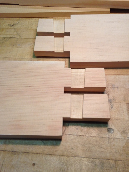

The wedge side of the tenonned half.
hopper 7.jpg (94.64 KiB) Viewed 30678 times

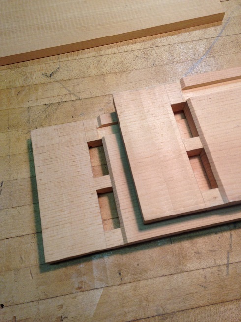

The wedge side of the mortised half.
hopper 6a.jpg (116.83 KiB) Viewed 30678 times

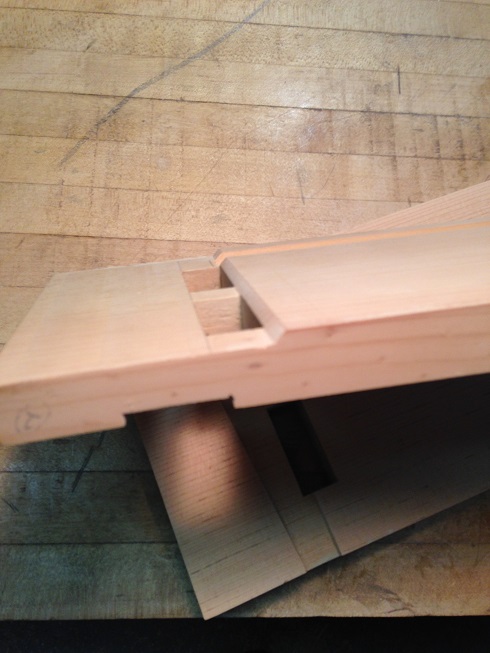

The mitered section of the mortised half .
hopper 6.jpg (87.75 KiB) Viewed 30678 times

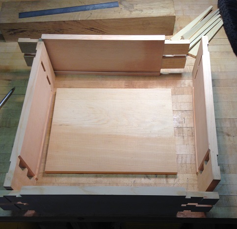

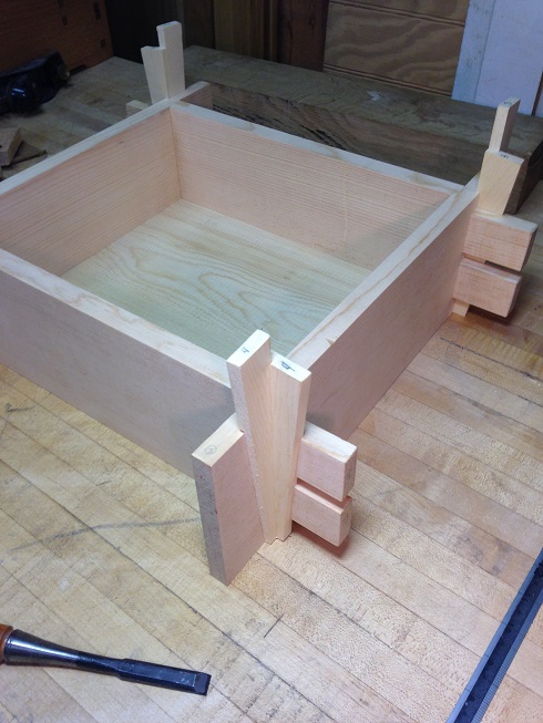

The pond went together well and held water. I would not use pine for the wedges again, instead I would use a harder wood for the wedges because I experienced some crushing on the pine wedges. I don't want to cut off the wedges yet because I like the way they look. I may use this pond for something completely different and make a future version for sharpening.
Parts ready to assemble, a total of 8 wedges.
hopper 5.jpg (84.34 KiB) Viewed 30677 times

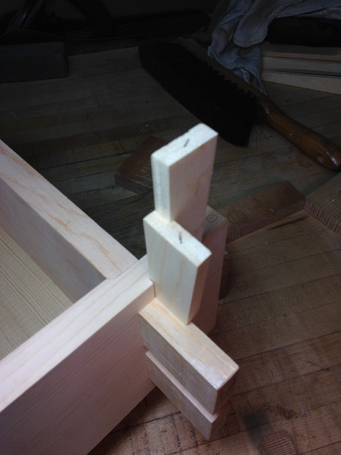

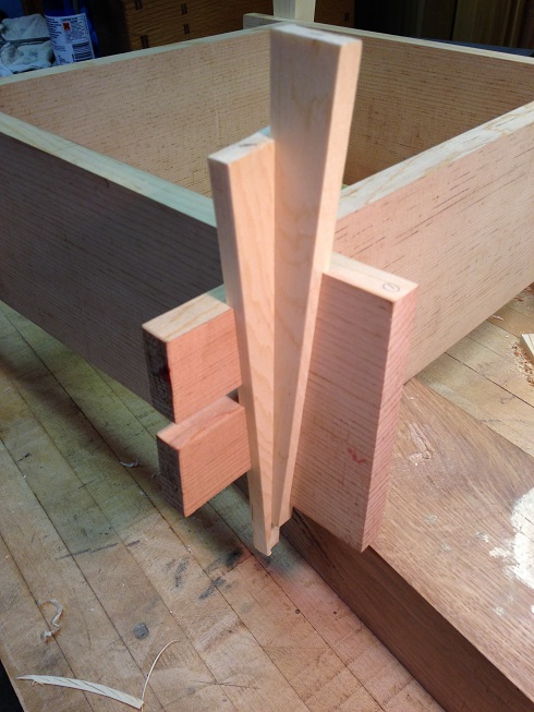

Wedges in place with out trimming.
hopper 3a.jpg (115.02 KiB) Viewed 30677 times
Wedges in place.
hopper 3.jpg (81.45 KiB) Viewed 30677 times
Completely assembled.
hopper 2.jpg (115.29 KiB) Viewed 30677 times
Finished pond holds water without any leaks at all.
Hopper 1.jpg (103.72 KiB) Viewed 30677 times

I still need to trim/plane a lot to finish this. I also need to make movable platforms for the stones.

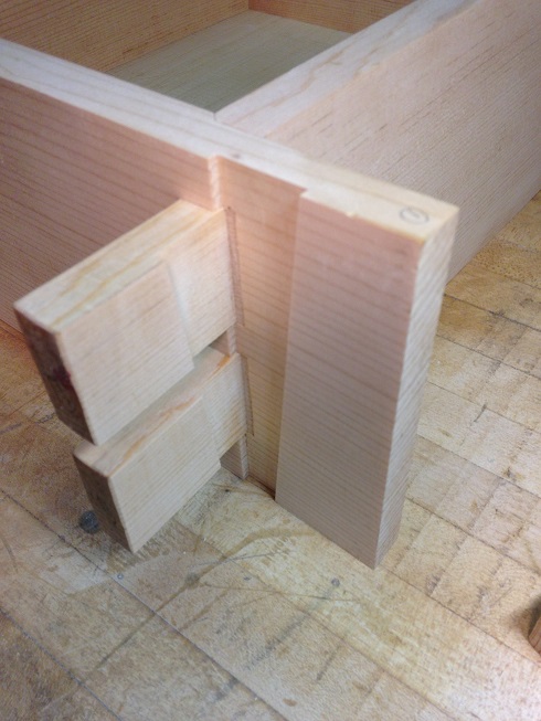

assembled joint prior to placing wedges.
hopper 4.jpg (100.24 KiB) Viewed 30677 times
