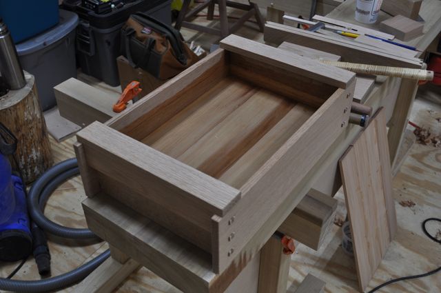

Thanks for the words of wisdom on the wedges Chris, that's good to know for the next round. I actually tried to make the wedges a 1:6 slope, which I guess is still pretty steep. The tenon was let into a dadoed side, leaving 3/8" wall thickness. Then I widened the mortise for wedges by 1/16" on each side. But I failed to account for the saw kerf when calculating the size of the wedges so I ended up needing to make them a bit steeper yet.
I also made the panel too-fat and went for ki-goroshi, which worked great, but I was over enthusiastic with my plane on one corner when I was final planing the bottom....It's hard to be patient sometimes when a project is getting close to completion

Yeah Jon, 1:6 would be a 9.46˚ angle.
1:10 or 1:12 is more suitable.

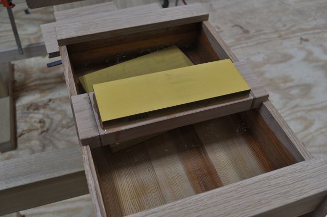

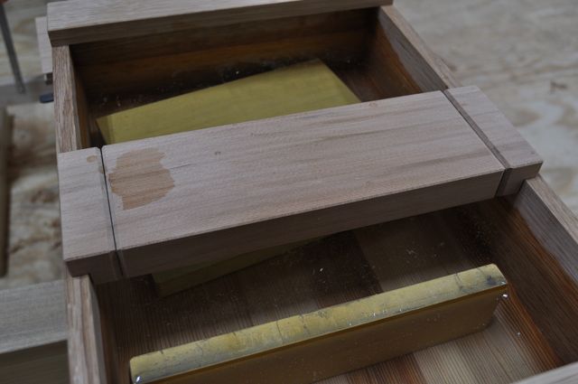

Well I still had a slow leak in the bad corner today so I ended up using Chris's suggestion.... and now no leaks! So I trimmed the tenons and wedges, and glued on some handles and caps. Still have to make a top, but I couldn't resist putting it to use today.
I made up a platform for the stones to sit on and cut a channel on each end hoping to reduce excess water from spilling over the side of the box when sharpening. I'd like to apply something grippy to the platform, such as a piece of rubber to grip the stones. But in use today, with nothing on the platform, the stones actually held in place quite well with a little suction between the stone and wood.

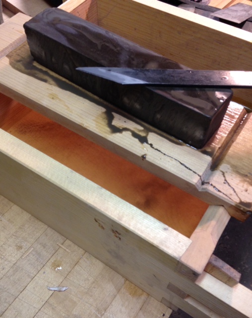

I put my new water pond to use today. There were no leaks. I am also using a "new" stone for the first tiime. I found the stone in a box at an estate sale. There are saw marks on three sides of the stone and a smooth top side that was dished from use. It is about 1.75" square X 7". I flattened the stone with a cheap diamond stone. The stone produces a slurry readily and leaves a very nice matte finish on the blade. I think the stone is a medium to fine stone. The stone also produces a prominent "earthy" smell when in use. Even though I only sharpened the knife in the picture, the stone stayed flat. I am no expert in natural water stones as all my stones are man made except 2. I do like using this one so far.

Looks like your pond is working well Paul. I can't offer any info on the stone as I have pretty limited experience with natural stones, but if you're getting good results thats great. Seems like a cool find to come across at an estate sale!
