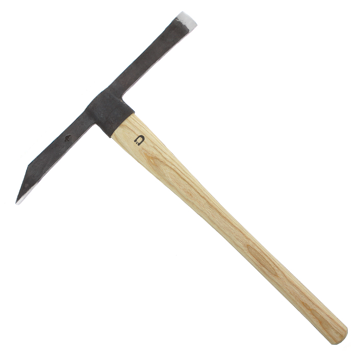

I was not sure where to post these photos.
I wanted to introduce an antidote to all that heavy-weight electrical stuff over on the Japanese Heavy Metal section.
I give you: French Heavy Metal - la bisaigue

Shown here is only one end of the tool in action. This end is always used as a slick, the other end has the shape of a mortise chisel to chop the mortise. No hammer used for mortising, only this tool.
I tried it once and found it very akward to use since my lack of experience with it and therefore lack of skill. The owner was very efficient and fast with it.

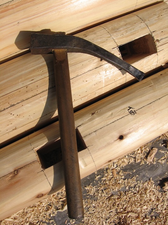

As promised the Chinese version. This tool is used to remove the majority of material when chopping mortises.

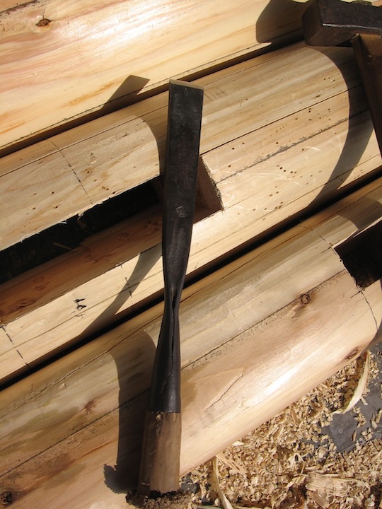

The chisel used to clean up the mortise.

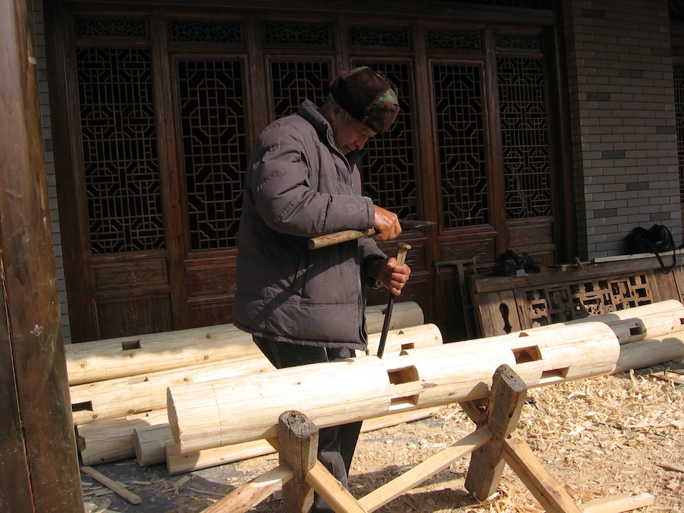

In full action, using the axe as a hammer.

Thanks for the pictures - as I thought, the axe is the main tool. were the chisels laminated from what you could tell?
Those tripods are interesting too!
Re: The French have a way
Posted: Fri Feb 10, 2012 11:30 pm
by Mathieu
Yep the chisels where laminated and forged by the local blacksmith from his home village, located in the north of Yunnan province. These pictures where taken in Yangshuo.
Posted: Fri Feb 10, 2012 11:36 pm
No striking hoop on the top of the handles?
Posted: Sat Feb 11, 2012 8:11 am
by Mathieu
Nope no striking hoopes. I was under the impression that the handles where easily replaced and at least one of his chisels had a fairly new handle on them but it was obvious that the blade itself had seen many years of use.
