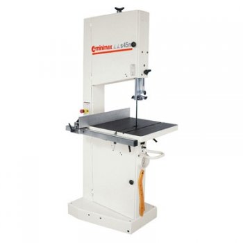

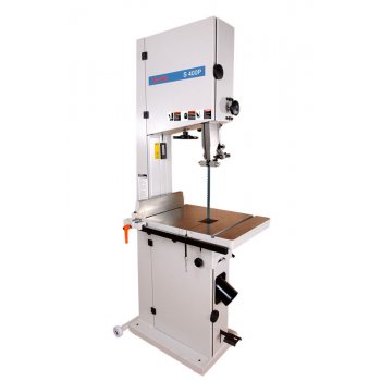

The second hand market for bandsaws is pretty slim so I have decided to probably buy new. I don't want Chinese/Taiwanese and the only european brands available here are Hammer and Minimax. The minimax bandsaws seem to get good reviews and I have been looking at two in particular; the S45n and the S400P:
The S400P is the more serious machine and this is reflected in the cost. It has a much higher vertical cut of 400mm and a throat of 380mm, whilst the S45n has a max vertical cut of 300mm but a throat of 440mm. There are other differences of course. I hope to make the trip down to Sydney over the next couple of weeks and see them in the flesh. Until then I would be interested in the thoughts of others more familiar with machinery. Is my space large enough to fit the machines I eventually want to have? Is the bandsaw the logical first purchase? What's more important for most work; cutting height or throat capacity? Anyone prefer Hammer?

Thanks for your comments. I had decided to steer clear of jet and the other Chinese/Taiwanese manufactured stuff - I've heard only bad reviews. Your Felder is bigger than what I was looking at. I believe that the Minimax S400/500/600 is similar in quality and has the much beefed up spine to handle the blades that need the higher tensions. I guess bigger is always better but I have a vertical space limit of about 204cm. How tall is the Felder out of interest?

I have a friend who owns a MM16 (S400p) and is quite happy with it. He got a good deal on it ($1000 US from original owner with light use), and says that he would not have spent full retail price if he had to. My impression is that it is well built but not a truly 'high end' machine. Certainly a step up from Jet, etc., though.

Thanks for your comment. It's interesting to hear that feedback. Their prices in Australia at least make me think that they should be high end!

I think Matt is correct in his assessment of the relative quality of Minimax compared to other commonly available bandsaws. A step up, but not top of the line. I understand prices in Australia are high for most items which are imported, due to tariffs slapped on.
