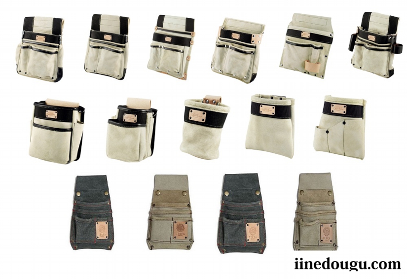

The general Japanese term for the carry bag is '道具袋', read dōgu-bukuro. It means 'tool bag', surprise-surprise.... This comes in a wide range of forms.
Another term, for the type carried on a belt, is '腰袋', koshi-bukuro, meaning 'hip bag'. There's a wide range of configurations of those:
