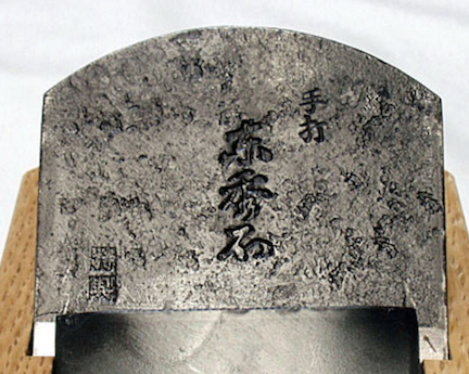

I got this in the mail today,
Sorry for the poor photo. I'll try to get better ones if any one wants.
I have no idea if it's a good plane or not, the dai looks to be in good shape and the blade seems to be in good shape as well. I plan on letting it sit in my shop for awhile to acclimate before trying any thing.

You might post up additional photos like laying the blade flat out of the dai and photographing with raking light to show markings better and one of the sole or bottom. Here is a screen shot of an "Azumashoseki" Kanna, 70mm. -Blue steel-. Maybe you can make make a comparison.

Jack_Ervin. wrote:Ken,

I'll see if I can't get some better pictures tonight. Thanks for the link, it looks like there will be some good info there.
One thing I did notice, and I'm not sure if it's right or not, is that the blade seats in the dai very tightly. I know it would be difficult on the Internet, but could any one say roughly how tight it should fit?
