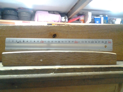

John, I took my cheapest regular kanna, the koyama brand from toolsfromjapan, and modified to dai to make it convex. It was a nice experiment. The more you plane, the more shape you loose, so you gotta stop when it feels just right. I got some tear out around the knots though, and couldn't acheive the best result. Next time I'll try with a yari kanna, but clearly I have to find some higher quality wood to work with.

I'd like to see a pic of that modification on the plane if you dont mind

Sure. I'll be back in my shop tomorrow, I'll send a pic.
2015-02-05 14.05.39.jpg (143.18 KiB) Viewed 7359 times
As you can see, the first few cm after the blade are flat, like the pressure point on a regular kanna, then the curve begins.

Okay, i see how that works. Thanks for that and a handy adaptation, smart.
