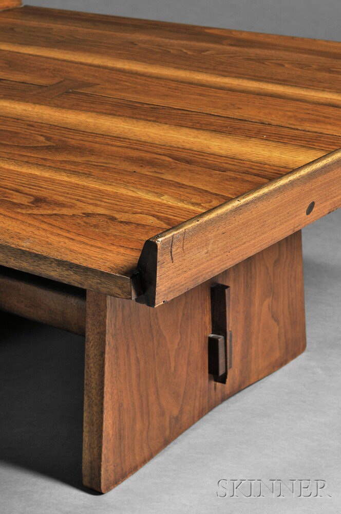

Brian wrote:Sorry Chris, I thought you were comparing to the wedge tenons in the top of my bench.
Yes the grain is running in that way, however it doesn't put much pressure (if any) outwardly on the long grain in practical use. It's main function is to capture the upright and help it to maintain it's position.
The wedge in this case is seated when the upright meets the shoulder of the through tenon and not forced beyond that. If one were to drive it home they would likely split the tenon prior to splitting the upright.
It's function is the same as that of a tusk tenon more so than that of a wedged through tenon.
I love this joint. Nakashima used it on his early Milkhouse coffee table:
[img]image.jpg[/img]
Re: Bench build
Sat Dec 13, 2014 1:21 pm
I am particularly fond of early Nakashima pieces. I enjoyed his applications of the joint, in fact he uses it fairly commonly. I think I tend to gravitate toward early work because a great deal of interesting accomplishments are made early in careers when an artist is making great leaps in their design abilities to satisfy the needs and expectations of clients.
Re: Bench build
Sat Dec 13, 2014 6:07 pm
Still a crappy joint. You're in love with the appearance of the thing more than the reality of how well it performs mechanically.
I've seen plenty of Nakashima pieces and I don't care for them. I don't like the way they are built. For example, in the above picture the everted table end is clumsily done and appears to be fastened to the end grain of the board with a screw and plug. I liked his book though, and at least he uses solid wood.
