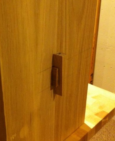

Your work is clean and attractive, however this connection is a bit problematic:

It's hard to tell from the photo but that is a double taper, it locks in nicely. What gives you pause about that connection?

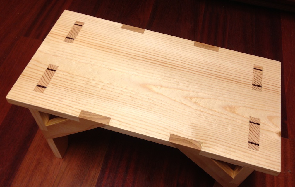

There are a couple of issues. One of them is in common with this piece which was covered in FWW several months back:
The through tenons on this bench are not done correctly - here's one of those Shaker stools built by someone presumably from the FWW article:

I'm again confused however, the mechanism of my through tenons is done in a manner that the wedging force is applied against the end grain. When I apply my wedges it's quite a violent act, if they were going to fail they would do so at that point.
The shaker bench's failure in design is that the tenons work to split the top since the wedge is directed with the grain of the rather than perpendicular to it. I suspect it's saving grace is that they were put in delicately (I presume).

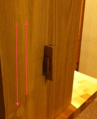

Okay, maybe I'm seeing it wrong. Could be.

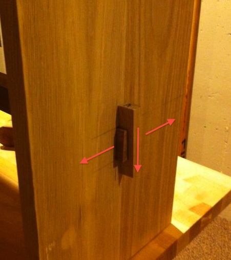

To clarify then, the grain in the receiving piece runs like this, yes?:
The portion which rests upon the floor would be the end grain.

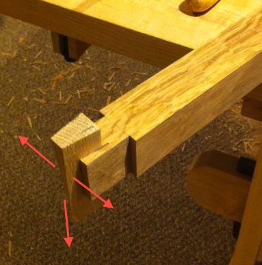

When the wedge is driven down, the stretcher portion of the connection, which has a tapered trench for the wedge, will spread like this, yes?:
Therefore, as the wedge is fitted at final assembly, the outward force on the stretcher portion will push outward, like this:
The portion of the stretcher being pushed outward is not bearing on end grain in the receiving leg. This situation is analogous to the wedged through tenons on Becksvoort's stool.

Yes the grain is running in that way, however it doesn't put much pressure (if any) outwardly on the long grain in practical use. It's main function is to capture the upright and help it to maintain it's position.
The wedge in this case is seated when the upright meets the shoulder of the through tenon and not forced beyond that. If one were to drive it home they would likely split the tenon prior to splitting the upright.
It's function is the same as that of a tusk tenon more so than that of a wedged through tenon.

My point exactly. In order to make the connection work, you cannot drive it home very tightly. That will be fine until the leg and stretcher and wedge all shrink a bit when humidity is low for an extended period, at which point the connection will be loose and the joint function will decrease somewhat. If the bench were loaded laterally at that point in time, then only the corner dovetail joints between top and legs would resist the load to any significant degree.
There's more to it though. Let's say you rotated the wedge and stretcher 90˚, so that when the wedge is driven in the load is taken up onto the mortises end grain portions. This seems like a better solution, however the joint's design mechanically is such that as it is loaded it becomes weaker. Allow me to explain if I may....

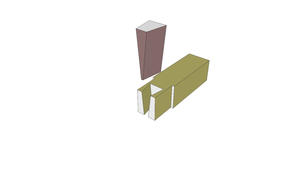

This is the form of the joint - please correct me if I have missed something:
wedgie a-small.jpg (21.85 KiB) Viewed 10486 times

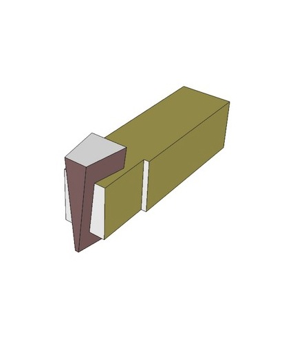

Then with the wedge inserted until contact:
wedgie b-small.jpg (15.69 KiB) Viewed 10486 times
At this point, the sides of the wedge fit against the cheeks of the half dovetail mechanically (i.e, there is some degree of friction).

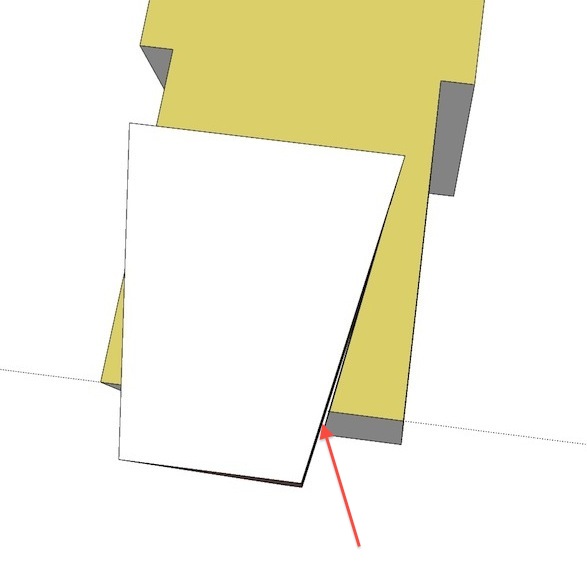

What happens though when you try to drive the wedge further however is that the wedge shape of the wedge, in the horizontal cross section) will push the stretcher's half dovetails apart, and immediately there will be gaps at the ends and the mechanical friction between the parts will be lost:
wedgie c-small.jpg (24.78 KiB) Viewed 10486 times
What happens next is the wedge will want to squirm outward, away from the stretcher towards the opening in the half dovetails. The joint doesn't tighten well. It looks like it would, but in reality it won't. I know this from having cut one of these a few years back, thinking to myself it was a cool kind of form. In the end it had no mechanical strength.
