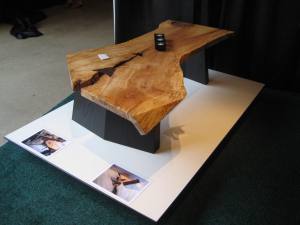

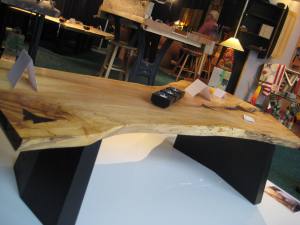

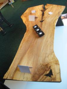

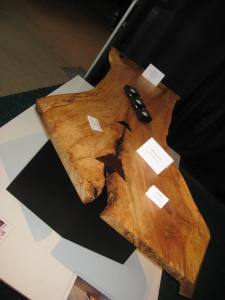

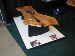

This table is made of Spalted Maple & ebonized Ash, butterflies are Rosewood & Ebony.

Wood oragami, indeed.
Nice werk, Timberwerks.

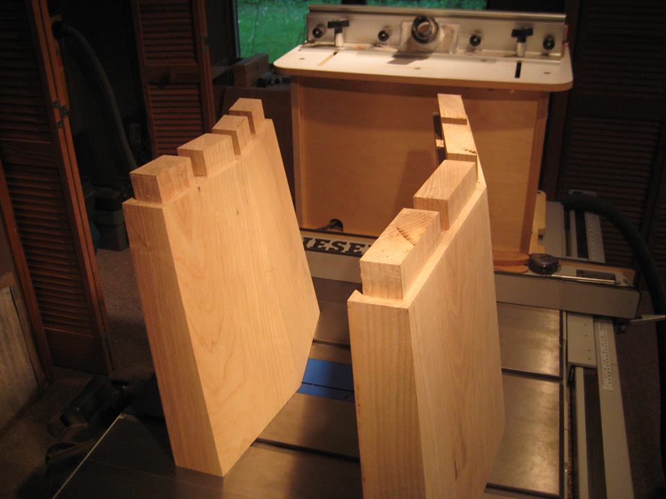

Good stuff! I like the butterflies.

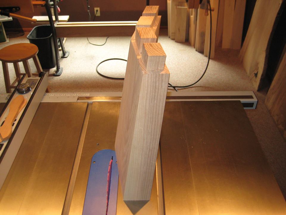

How are the legs connected to the slab?

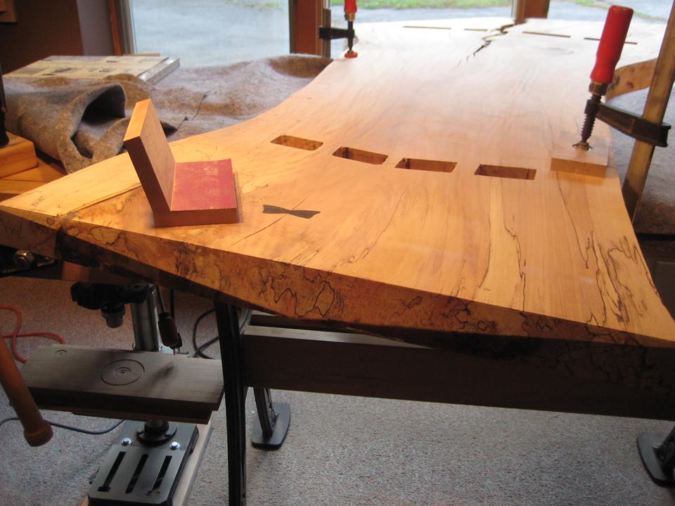

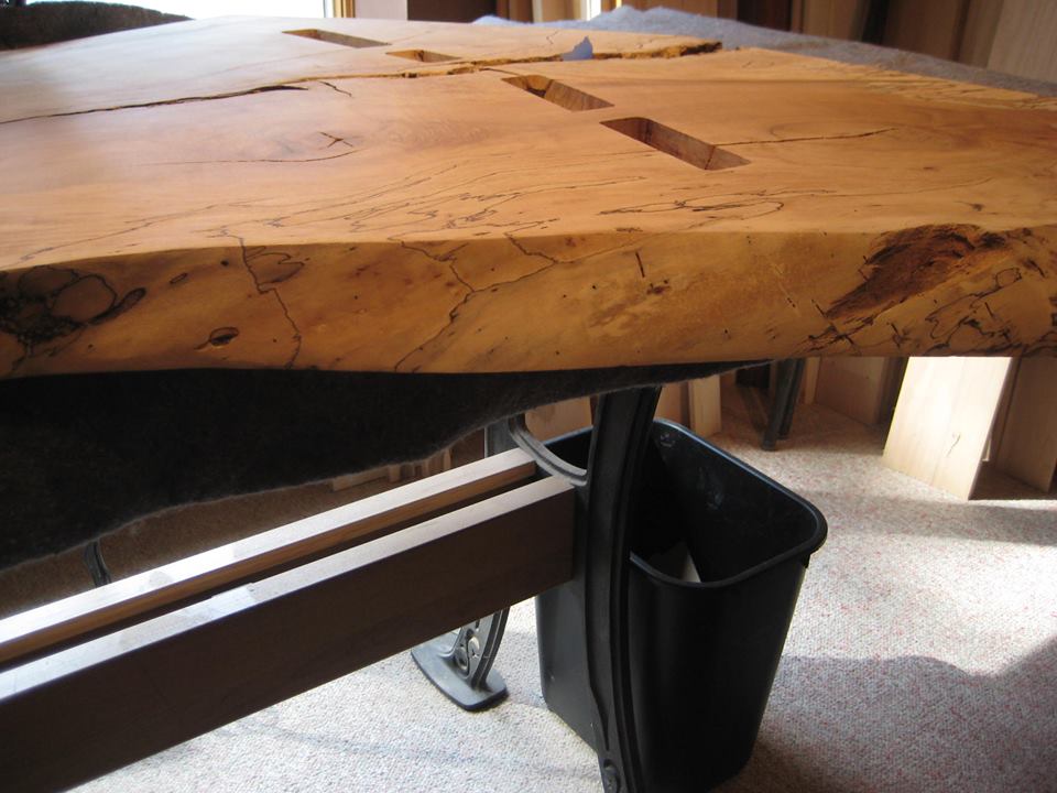

Thanks! I used fox wedged tenons. Shown are the tenons & mortises roughed out.

I love this piece! First, it's a BEAUTIFUL piece of wood and then the through tenons on the angled slab legs . . . it is wonderful. Thanks for the pictures. (I know you can't see me - but I am bowing to your greatness!!)

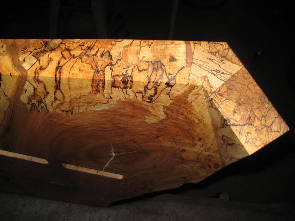

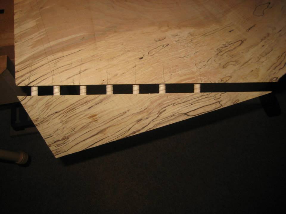

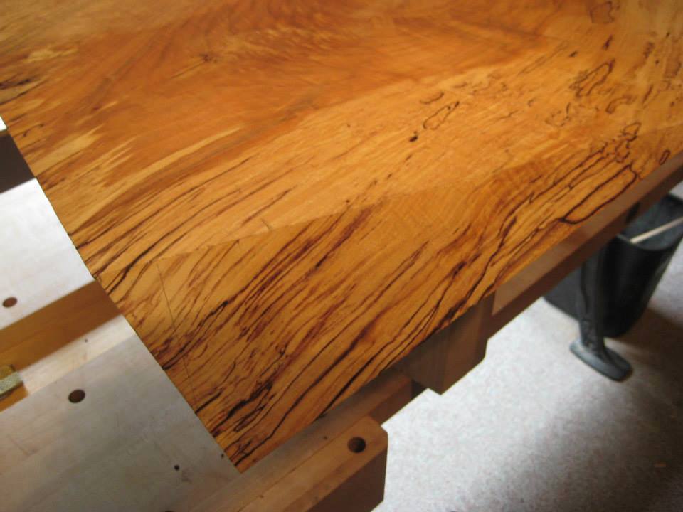

Here are a few photos of the folded edge & a incognito butterfly.

WHOA! Nice work.

:o Pretty nice job! Love the balance between natural wood shape and " man made origami folds".
