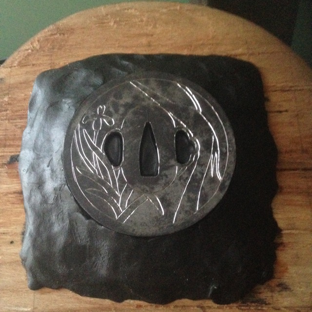

The scribed lines defined by chisel (kebori tagane - new terms for the glossary, Chris?) before cutting out the negative parts to leave a positive silhouette (the drill, saw, file part).

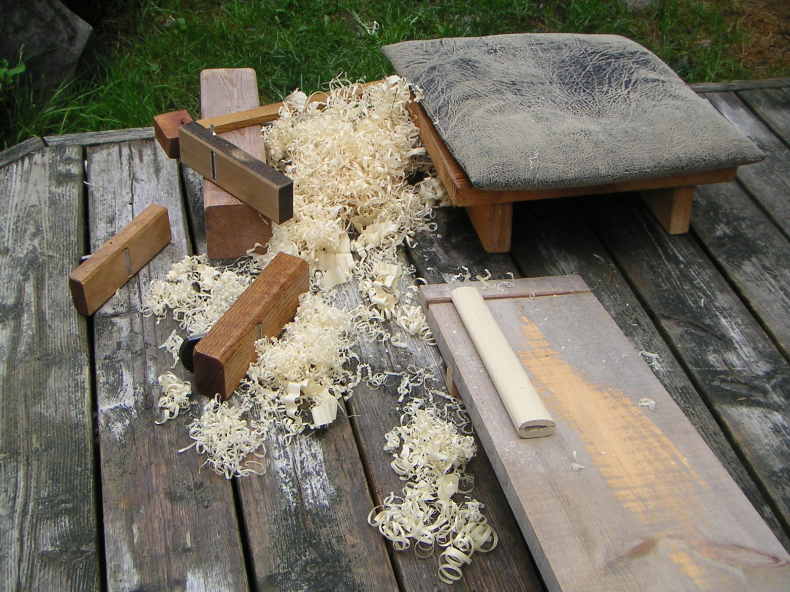

Lovely work. Interesting kanna – the mouths look quite close to the middle of the dai.

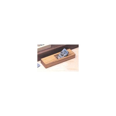

dmccurtis wrote:Lovely work. Interesting kanna – the mouths look quite close to the middle of the dai.
That's one of these (pic from Japan Woodworker)
42mm Kakuri which Lee Valley used to carry. Quite the workhorse for me, it works very well. But I see the price is $50 USD now. For that much money, I would opt for something more traditional on eBay.

Oh I've looked at those. Fifty dollars is a bit much for it, I agree. Is the ura hollow? I've never noticed.

dmccurtis wrote:Oh I've looked at those. Fifty dollars is a bit much for it, I agree. Is the ura hollow? I've never noticed.
No, the blade/chip-breaker are not traditional. The blade is not laminated and is of uniform thickness, rather than wedge shaped. The blade is held firm by the screw thumb-wheel of the chip-breaker under the pin. Not sure what type of steel, but doesn't hold an edge as well as white or blue, but being small, takes little time to sharpen. When I bought mine, they were something like $35 Cdn? (maybe even less), so not a bad deal, as even small laminated kanna were quite a bit more expensive new and somewhat harder to come by used (eBay didn't have the selection/quantity they do now). But its a nice size.

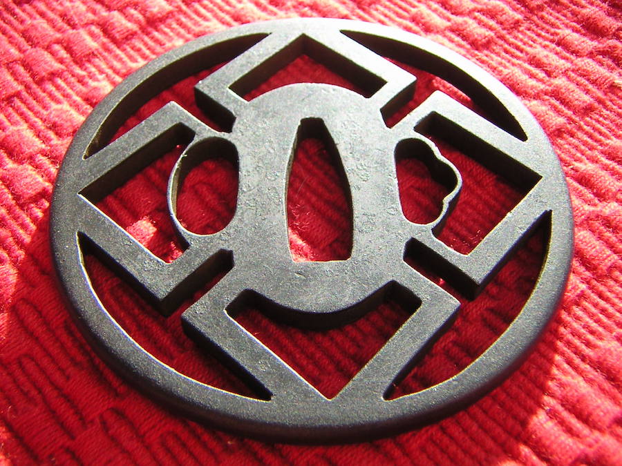

Some tsuba I've made for mounting; I study Iaido - Japanese swordsmanship, so I've put one on my own sword
this one:
* edit. I should point out that this tsuba is "Basic Tsuba Project #1" over on the Following the Iron Brush forum. Its a good learning project for those new to the craft.

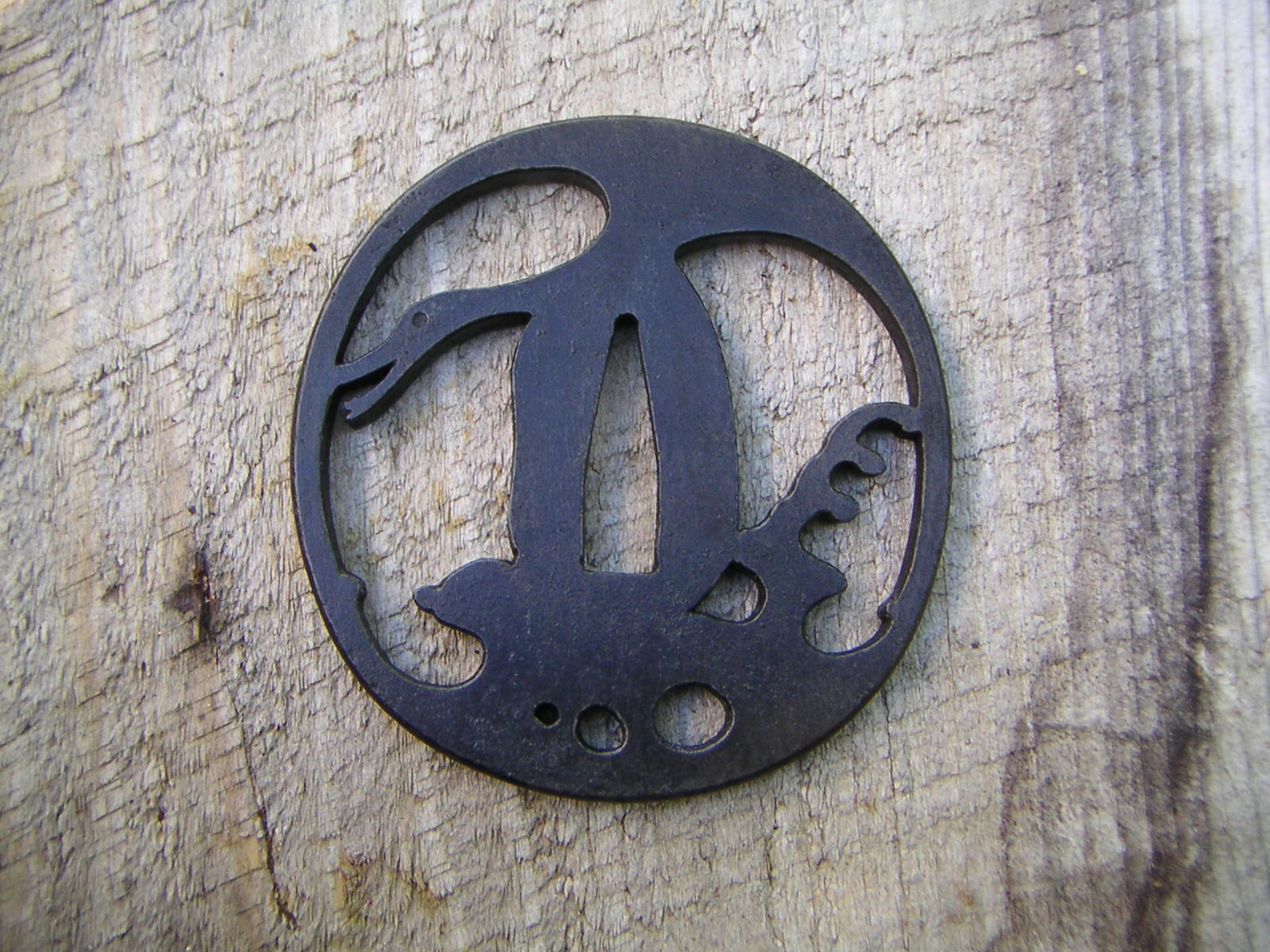

and also given one to my sensei
this one, which I've since done a better job on the patina:

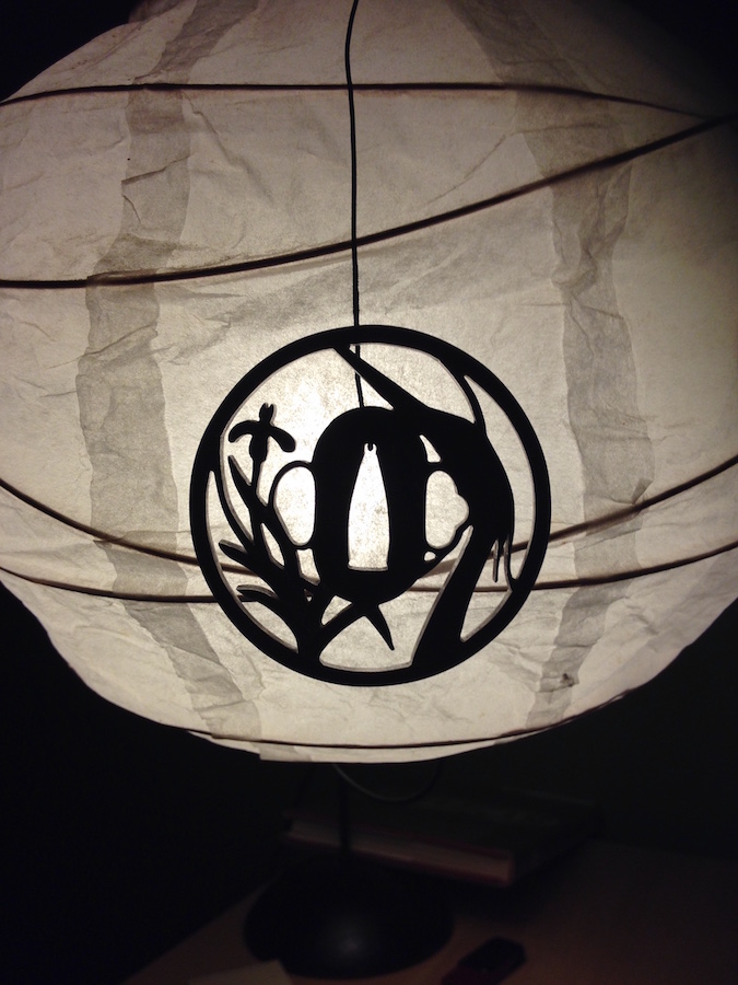

Progress on the tsuba. Most of the shaping is complete, now I need to clean some lines and get ready for texture/patina.

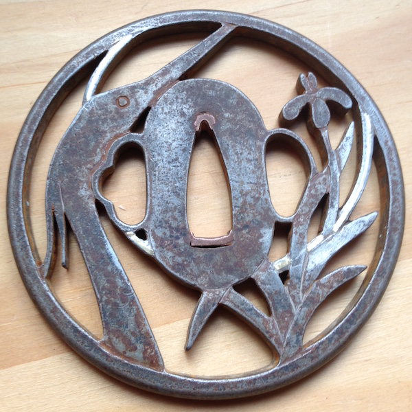

It's been a while since I posted anything here - I've been working on this and a couple of other tsuba as well - I'm just pretty slow. Anyway, I decided to try and add some colour contrast to this tsuba by inlaying some brass wire. I'm not good at this sort of thing (yet), so needed to make some practice pieces first. At this stage, the wire is just inlayed and brought almost level with the surface using chisel and scraper, and then roughly ground with stones. I'll polish it smoother later. The tsuba had been tumbled in a can of wet rocks to impart a texture to the surface, so there remains remnants of rust and staining which eventually will need to be cleaned off before I try the patination process (something I'm also not good at yet :( ) Once completed, it should be easy to see the colour of the brass against the (hopefully) dark brown/black steel.
