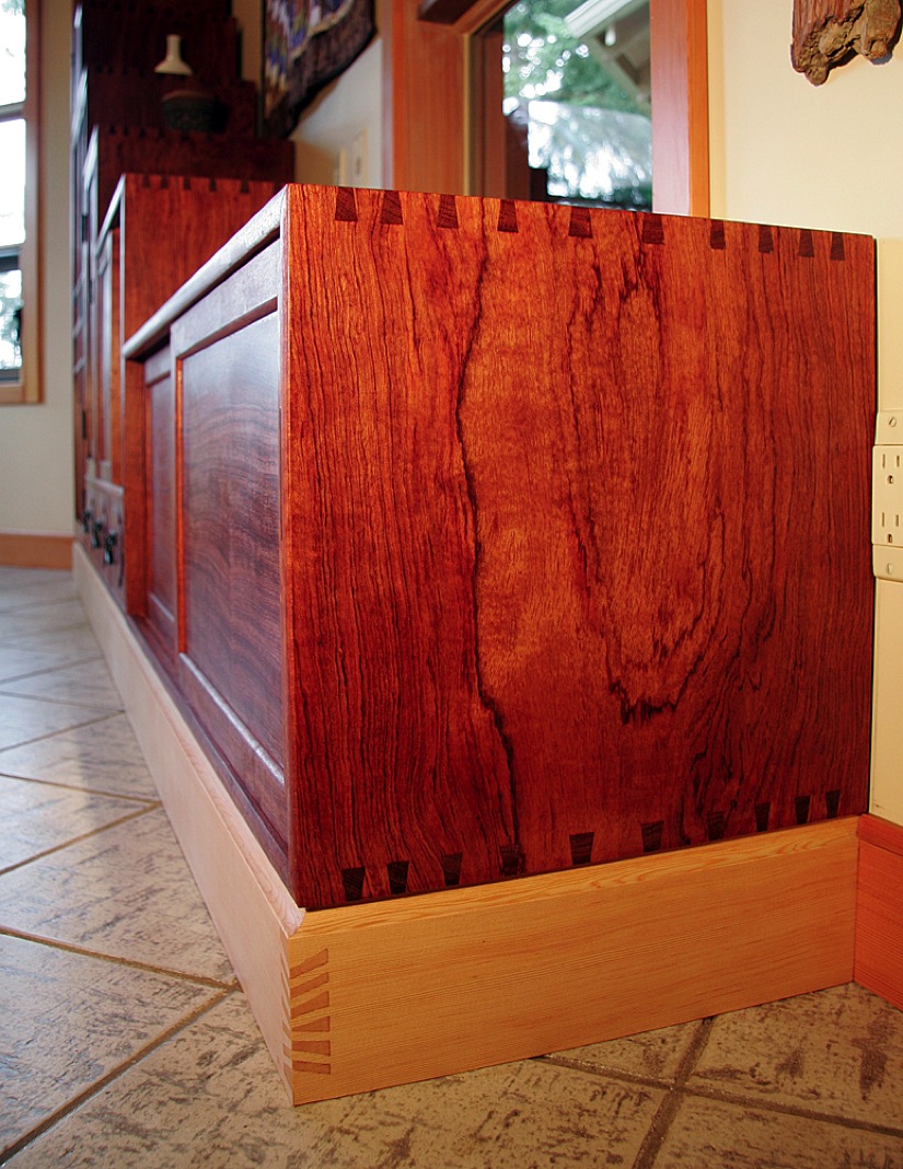

You might be interested in this piece from 2012:
http://thecarpentryway.blogspot.com/201 ... dence.html
You're right that the twisted dovetail is tricky to execute cleanly. It also suffers a lot from short grain issues, so you have to be careful.
In this piece from 2003~4 I used the twisted dovetail for cabinet plinth corner, A plinth which was meant to look like a continuation of the existing baseboard in the house:
_MG_1594 copy-small.jpg (295.44 KiB) Viewed 5419 times
