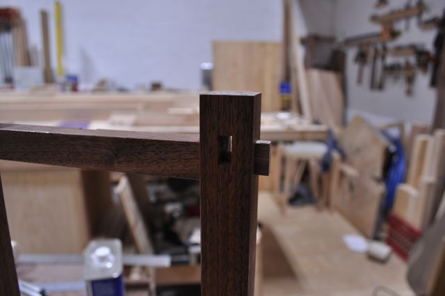

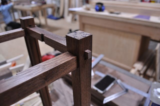

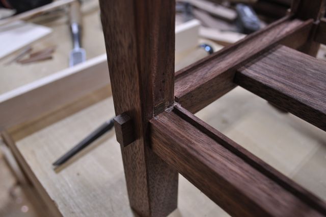

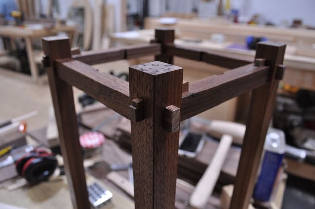

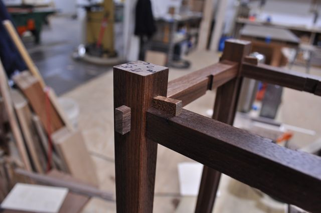

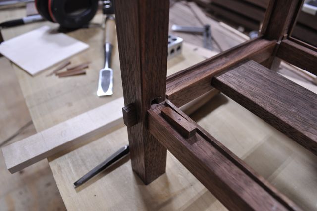

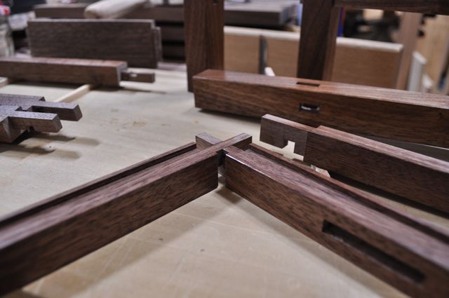

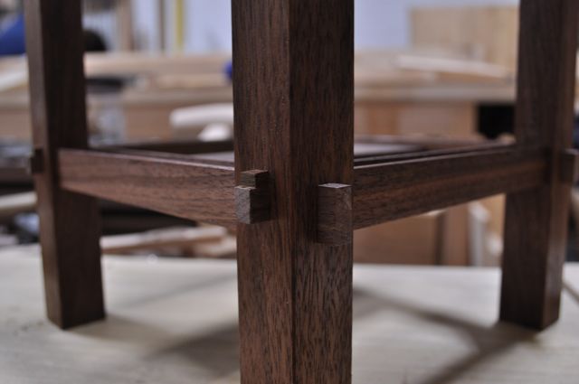

I've been working on an andon the past couple of days and for this version my goal was to use joinery alone to hold the structure together. After reading Chris's post on stretcher to post joinery I decided to join my andon using a version of the watari ago joint. I designed the joints so that the stretchers lapped together inside the post, where one stretcher is held down by the wedge onto the other. Hopefully the pictures will tell the story a little more clearly.

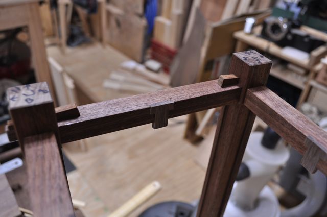

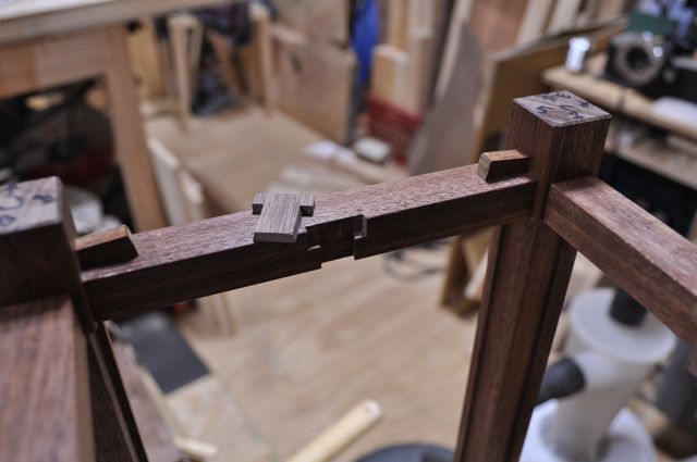

On the lower stretchers I cut the wedges back so that the screens will be able to fit in. I still have some design improvements to work out with the way the screens will be held in, but for now they will set down into the groove you can see in the lower stretchers. From there they can be pivoted into place and held in by a dovetail key in each of the top stretchers. I've yet to make the screens.
