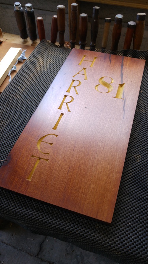

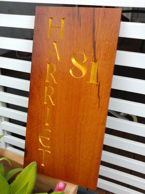

Here is the sign itself with the street name and number carved in two different fonts:

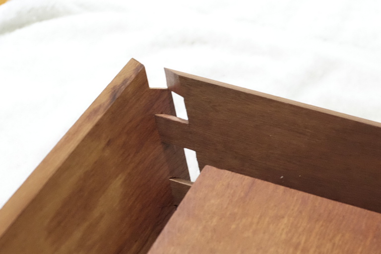

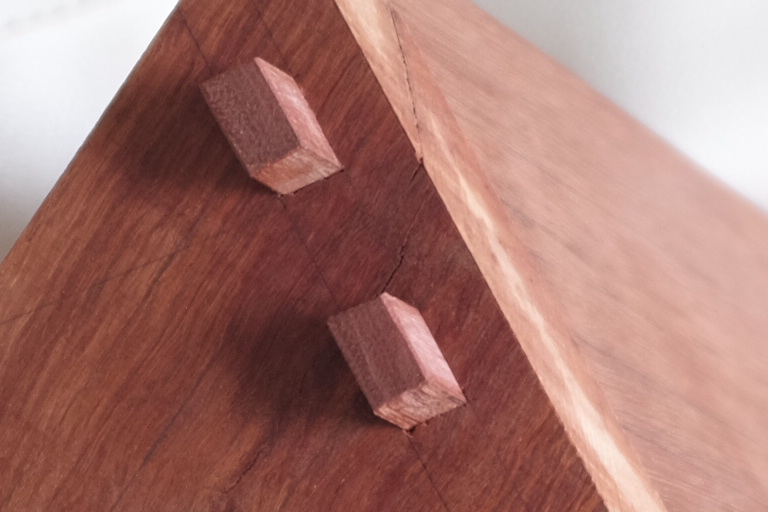

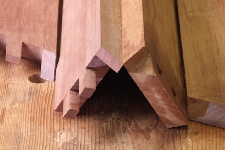

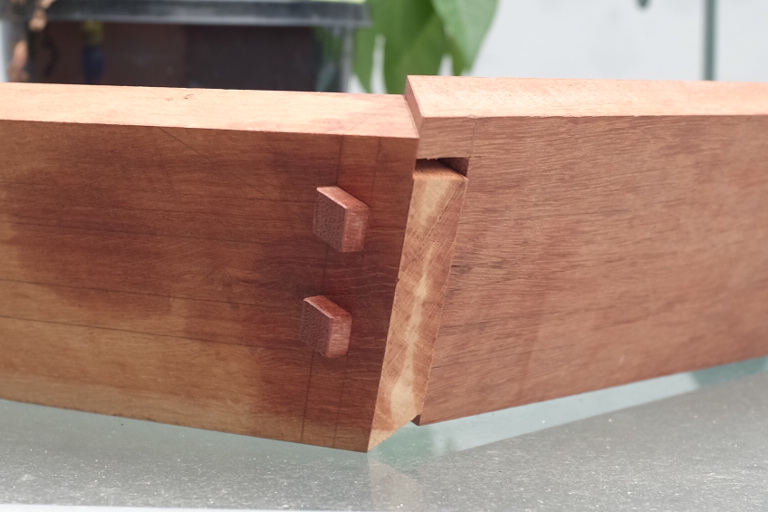

I am much happier about the quality of my joinery this time. This is primarily due to the use of carefully measured and cut paring blocks. A trial fit of the first corner shows the mortice and tenons going together quite neatly without any tuning required. The species of the casuarina used for the morticed pieces is a bit crumbly:
The inside view looks Ok:

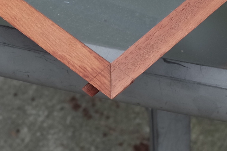

And the view from the top shows the mitre angle is good, with a little fat left to clean off before it will close up tight:

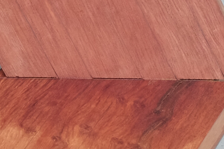

When I look at the side however, there does appear to be one problem:
That gap is not a form of artistic expression unfortunately. I've transcribed a line off the wrong reference point somewhere.
Looks like I will get still more joinery practice on this particular piece.

I chuckle to see the last picture, having had similar things happen to me at different times. Somehow, it hurts more when the cut out is superb but the lines not in the right place. Almost better to mess up both somehow, huh? :)

Chris, you're right, the frustration level is pretty high when you've taken so much care to try and get it neat. I find one of the great difficulties with non-orthogonal joinery is that it is simply not obvious when the marking or cutout is wrong. The finished shapes often make no sense, from a conventional perspective, as individual pieces, it's only when the joint comes together as a whole that the logic of it is revealed. For this reason I really have to concentrate and check that I've followed the process correctly - even then some still slip through the cracks.

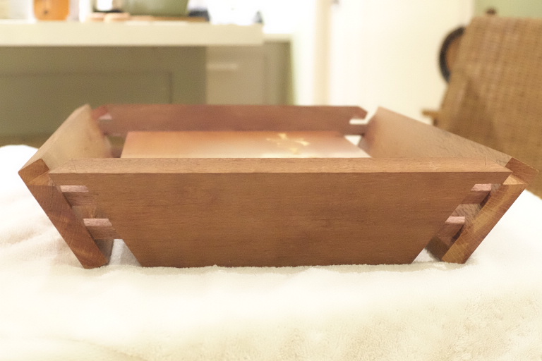

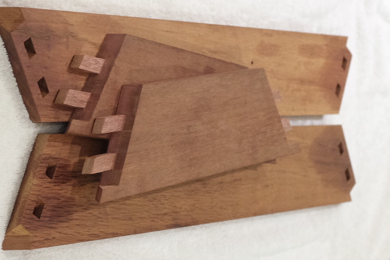

Drawings were analysed, statements were taken and suspects questioned until the perpetrator of the crime was identified. Once the guilty received appropriate convictions and punishments, a new set of tenoned corners were cut. I stepped off the distance required for the opposing corners and all four joints were completed. Parts:

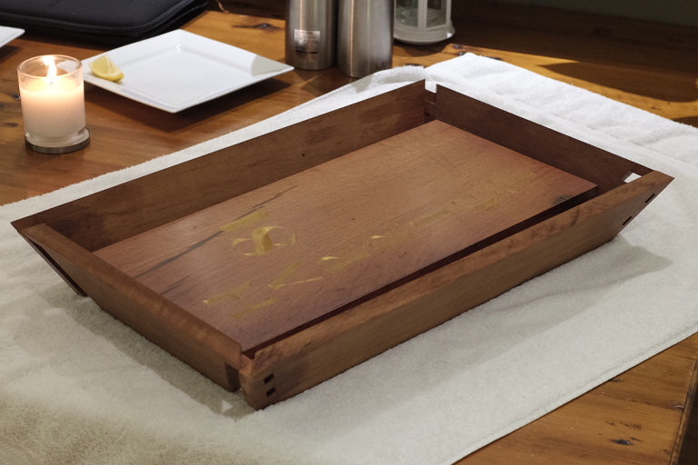

Without adjusting any of the cutout, I gave it a test assembly:
I have placed the sign in place to get a feel for the proportions. Thankfully it looks like I haven't made any gross blunders in layout or cutout and the parts are lining up as they should be:
The joints will need slight adjustment as they are a bit tight, but as it was late and dark when I finished, I'll leave that for another day. At this stage I'm leaning towards leave the sides 'straight' without any decorative pattern cut into the outer edge but still not totally sure.
