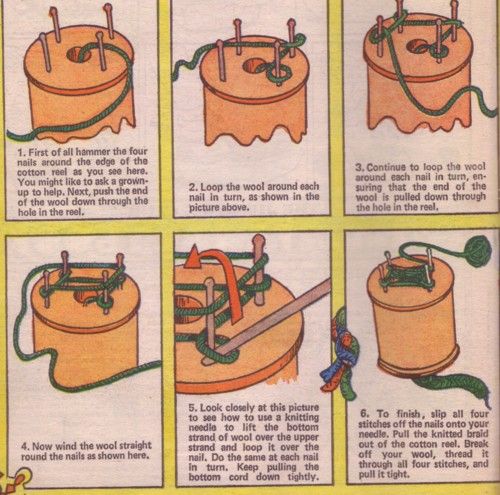

That's very interesting John! I confess to knowing next to nothing about Japanese kumihomo work, though I do find knots fascinating and used to know a bunch. But the only braiding-like work I ever remember was from childhood, where a wooding thread spool with four nails on top was used to create a braiding cord. I don't remember too much about it, but looking at the frame you have build reminds me of that spool.
I just looked it up, and I think what I had made and used so many years ago was a spool knitter:

Thanks Chris. Spool knitters are kinda fun, esp. in that they're an easy way to really "get" what's going on with something like a sock knitting machine.
