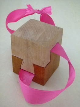

Re: 継手Tsugite Splicing joint study
Tue Mar 14, 2017 8:46 pm
There is another version of the joint, one dovetail up and one down, however the picture I shared is, well, how to put it without spelling it out: the ribbon communicates a certain message, shall we say...

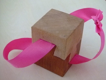

Another view:
