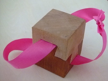

There is another version of the joint, one dovetail up and one down, however the picture I shared is, well, how to put it without spelling it out: the ribbon communicates a certain message, shall we say...

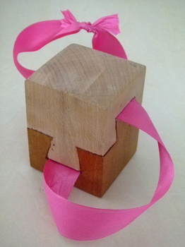

Another view:
