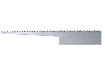

At a minimum you will need a narrow thin chisel to cut the trench. If you need a skinny saw, you can either cut a saw blade up into a short narrow piece, or obtain a little saw blade for an x-acto knife like this:
Or modify a hacksaw blade - imagination can come up with all sorts of solutions. Have no fear, there is no special 'shachi sen' chisel set you need to buy...

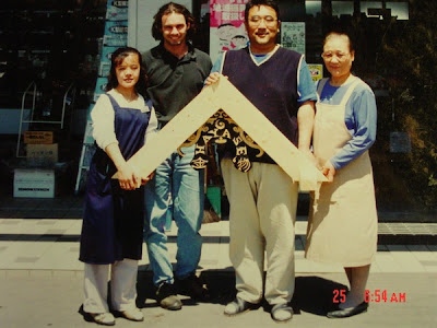

This joint was a joint I tackled fairly early on in my learning process, funny enough. Here's a pic from 1997 or so with a model of a bargeboard joint I did as a gift- the fixing pin is not visible, but it is there above the carving:
Re: After Joint 2
Cool pic. So the double tenon miter with fixing pin is typically used for the gable barge rafter?
Re: After Joint 2
It's one application architecturally for that connection, however there are others. There are several types of barge board joints besides, mind you. Maybe we'll tackle one of those for the next project...
