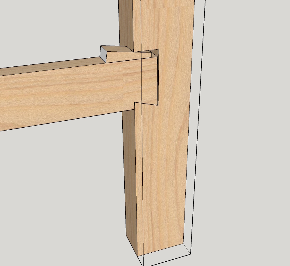

In this view with the parts assembled, and the post partially cut away, we can see that the dovetail mortise depth is a little more than 1/2 the thickness of the post:
Nuki to post connections j.jpg (399.79 KiB) Viewed 23889 times
The mortise depth formula is: depth of the mortise is the thickness of the post divided in half, to which you add 12mm. That is 120mmm post divided by 2 is 60mm, +12 mm = 72mm. The mortise is 72mm deep, and the tenon length is held a slight amount back from that to accommodate wood movement in the post, at 70mm.

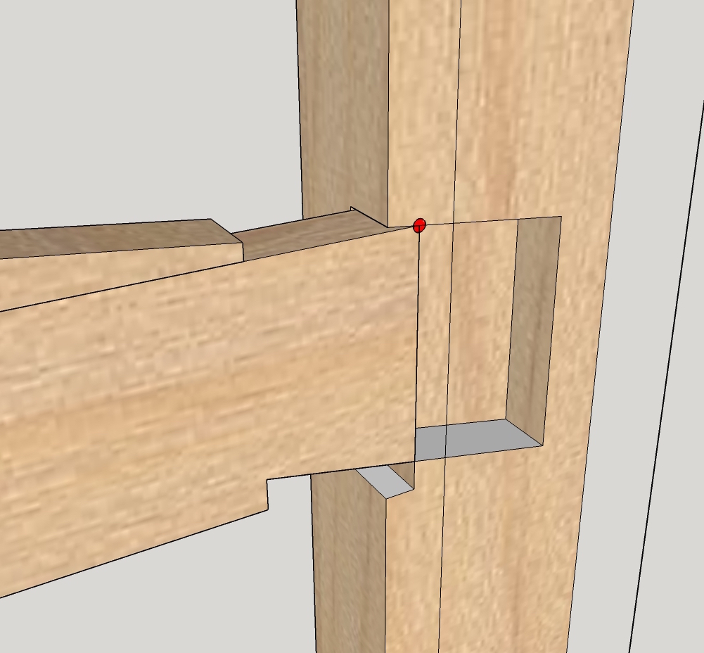

The wedge, or kusabi, which secures the connection, is ramped at an angle of 1:8 or so. The ramped surface is matched on the upper end wall of the mortise, so the wedge fits just like a hand in a glove.

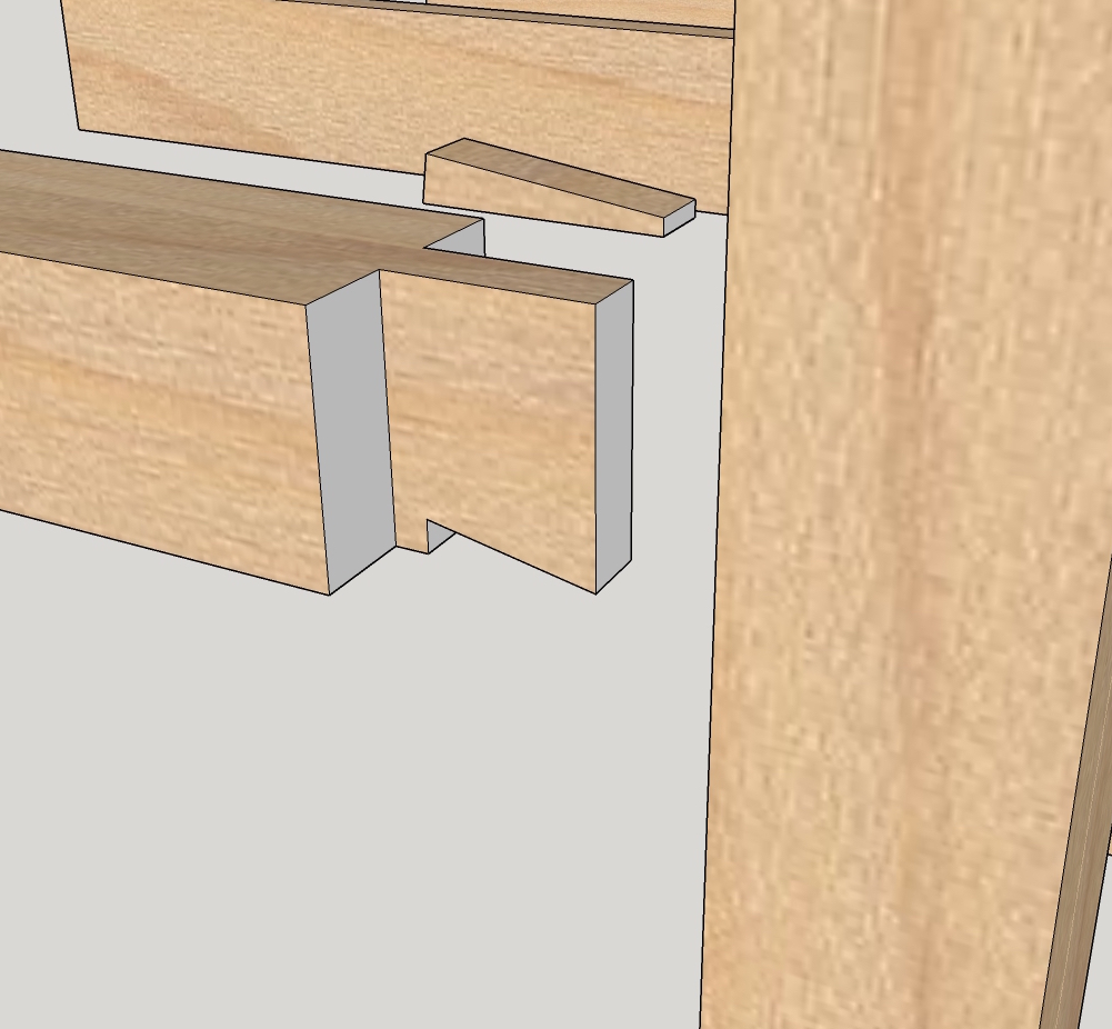

The most important thing to consider, when laying out this joint, is that the fat head of the dovetail is met by a mortise with the same height, and this height is measured not on the surface of the post, but at a depth of 15mm (the 1:8 proportion again).
In the following illustration, the wedge is removed and the stretcher is withdrawn up the dovetail ramp to the most constricted portion of the mortise - note that where the top of the tenon meets the upper mortise wall, marked with a red dot, is the very lowest position at which the upper mortise wall can be located:
Nuki to post connections s.jpg (310.07 KiB) Viewed 23889 times
So long as the dovetail head will clear that narrow mortise opening, the joint will go together well.

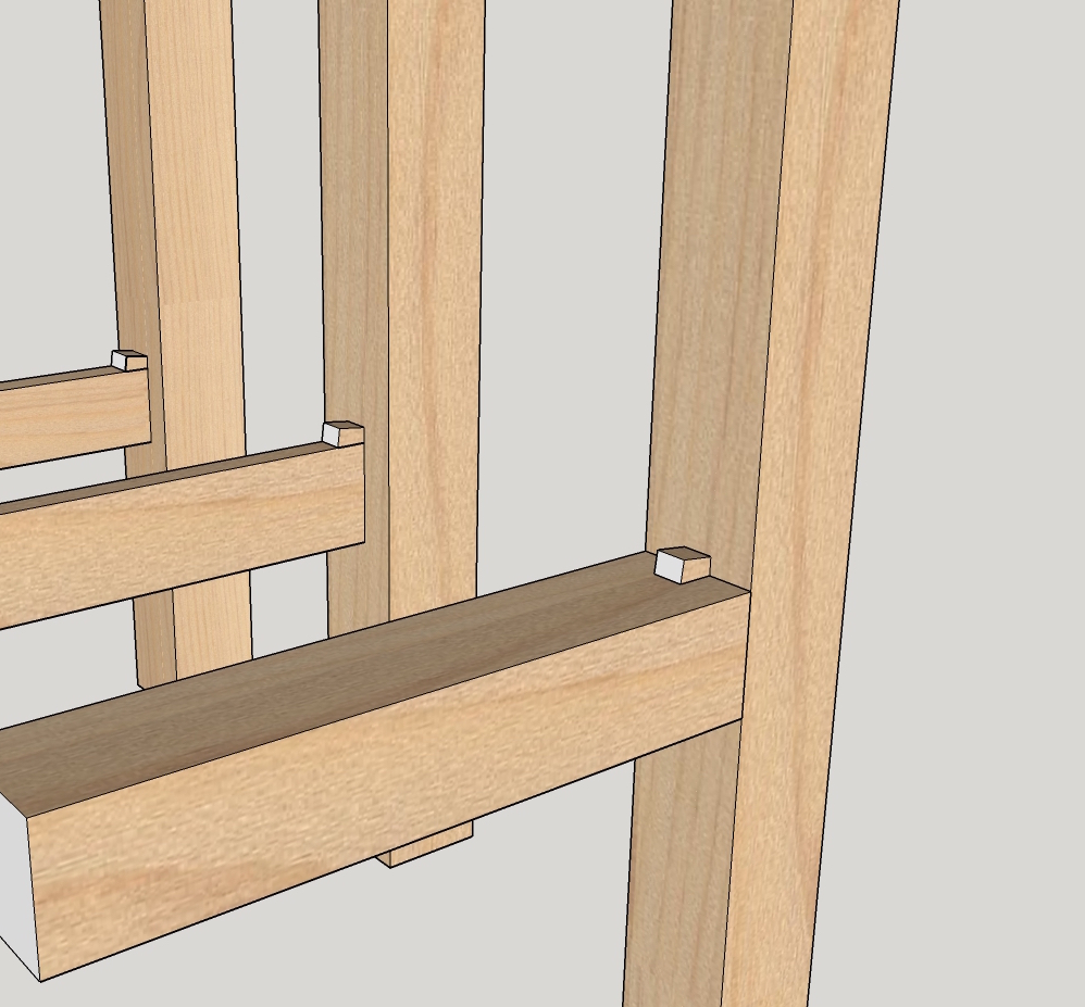

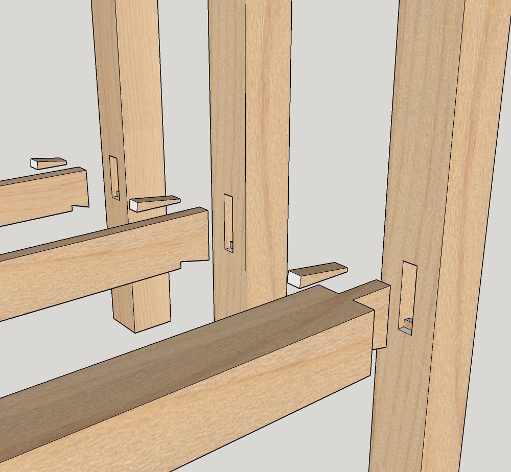

A view now showing 3 versions of the housed half dovetail joint:
Nuki to post connections p.jpg (478.83 KiB) Viewed 23889 times

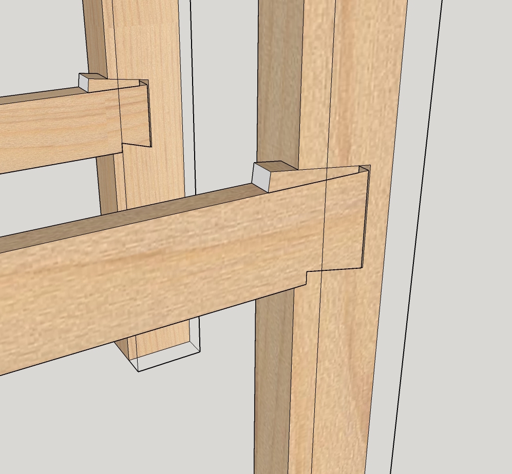

The same three assemblies fully connected:
Nuki to post connections o.jpg (400.92 KiB) Viewed 23889 times

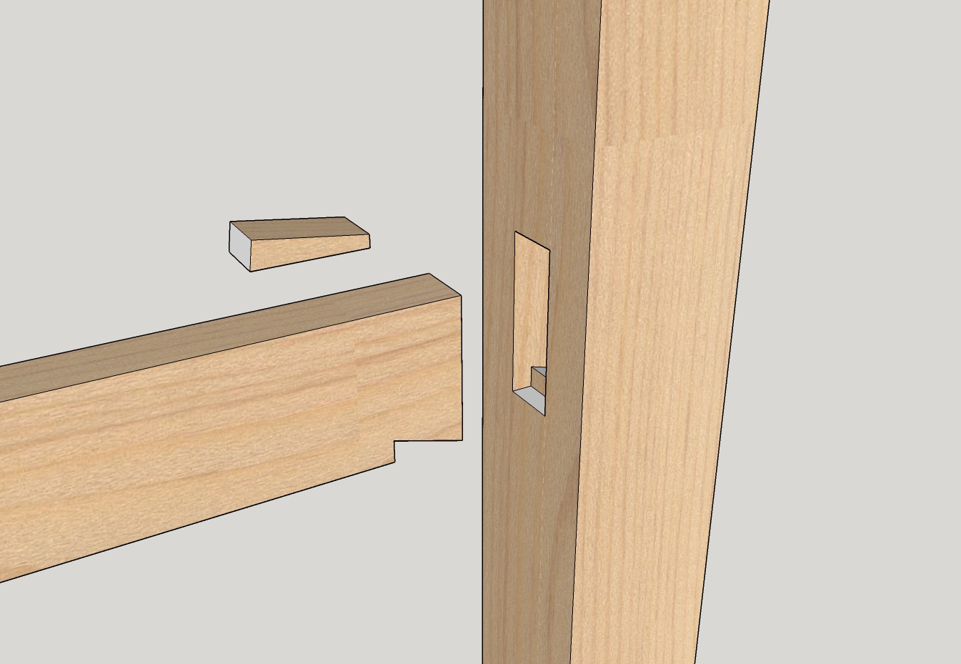

In house framing where the stretcher connection will be buried under an earthen wall infill, a simpler, non-housed version of the joint is commonly employed:
Nuki to post connections u.jpg (269.9 KiB) Viewed 23889 times
Note that the upper mortise wall is not cut on slope to match the wedge's upper surface, rather the upper mortise wall is simply cut squarely in. Not quite as strong a joint as the housed version, but quicker and cheaper to execute.
