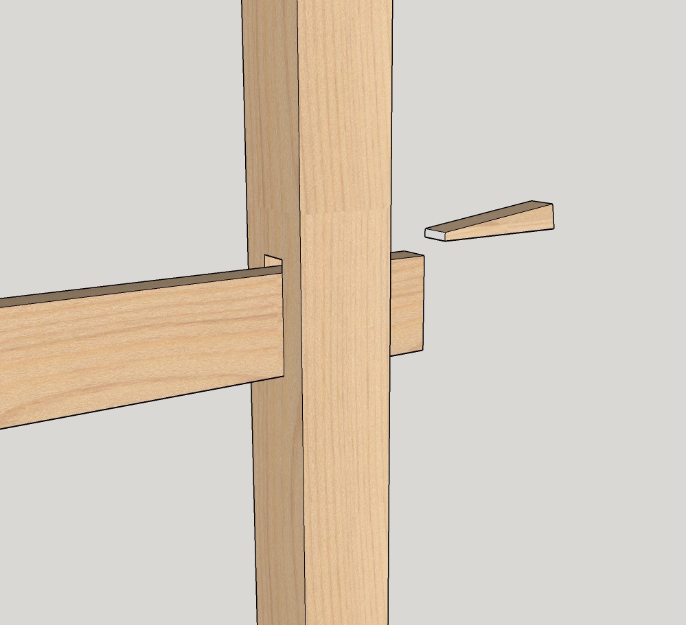

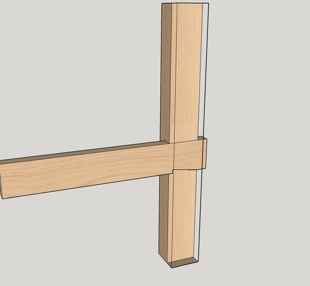

In the preceding examples, we looked at the half dovetail connection, done blind. As noted there, a longer dovetail and deeper mortise mean greater surface area for interlock and thus the longer example should be the stronger example.
Taking this idea a step further, we could bring the half dovetail right through the receiving member:
Nuki to post connections through.jpg (187.07 KiB) Viewed 28010 times
Note that the wedge hasn't been detailed in the above drawing, and there is no mortise provided for the wedge, so the above is simply for sake of example.
To maximize the dovetail, it is extended to the exit face of the receiving member. It's hardly against the law or anything like that, but there is no reason to configure the connection so that the dovetail ramp surface sticks out any further. With a portion of the stretcher protruding beyond the receiving piece, it is more desirable to present the stretcher as a clean pair of horizontal lines passing through, and not have the joint mechanism be any more obvious than it already is. remember, this form of connection is generally employed on framing that is not visible to view, and so the aesthetics are less important in that context. If you choose to adapt it for furniture work, there is absolutely nothing wrong with that, however there are plenty of alternatives. The loading on the parts should guide the joinery decisions ahead of aesthetics in most cases, and there may be several options which meet performance goals and yet offer quite different aesthetics.

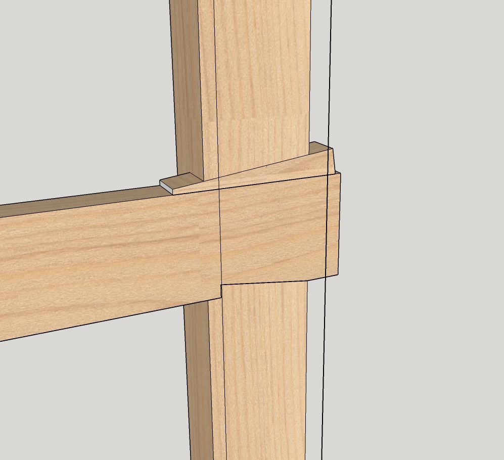

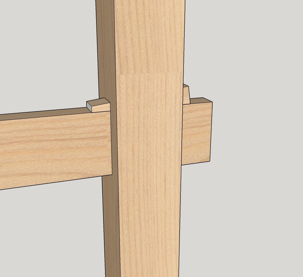

With the connection passing fully through the receiving member, we have options to wedge the connection as before, from the inside face:
Nuki to post connections through 2.jpg (321.92 KiB) Viewed 28010 times

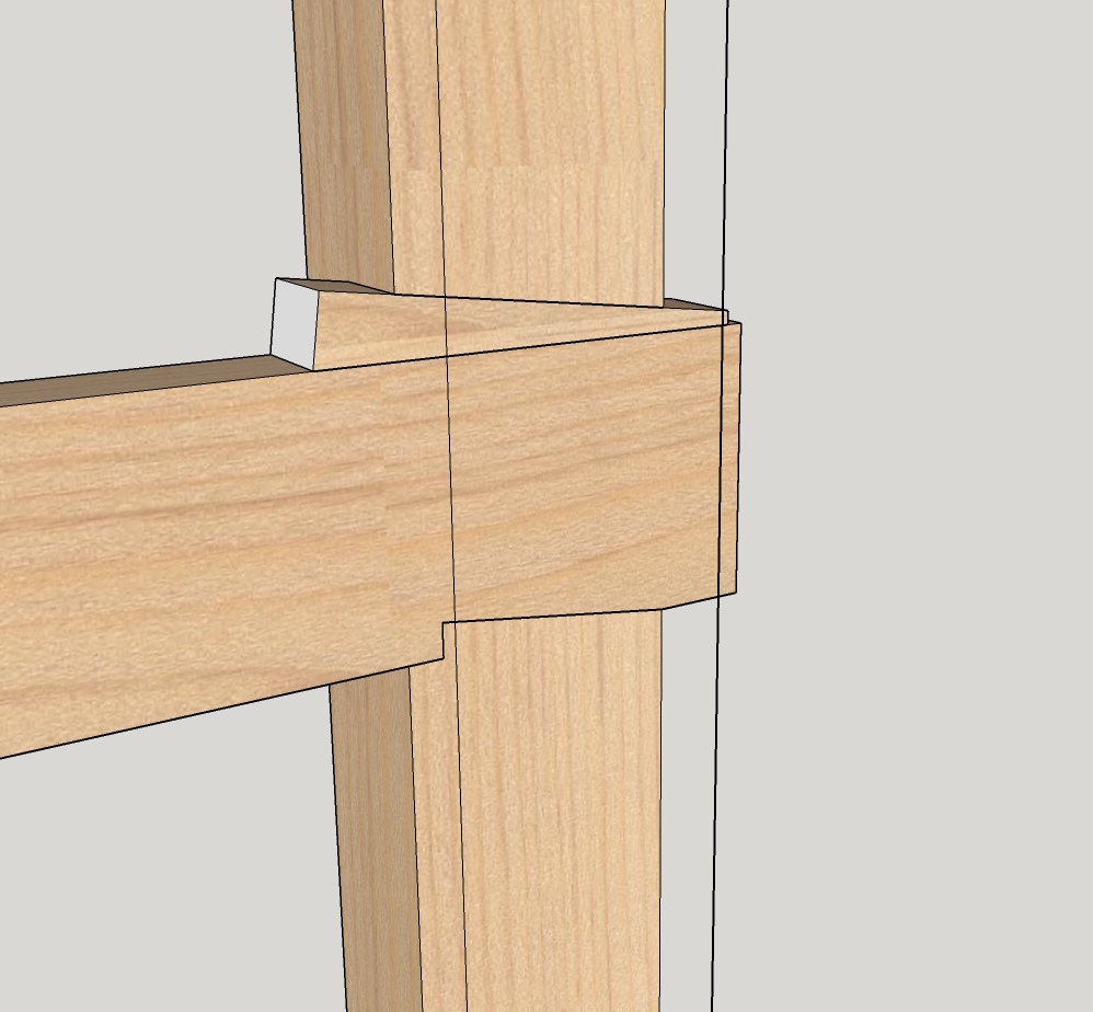

Or, we can drive the wedge in from the outside face:
Nuki to post connections through 3.jpg (293.89 KiB) Viewed 28010 times
Notice that in either case, if we keep the wedge taper the same, at 1:8, the lengthening of the wedge can result in one end of the wedge becoming quite large. This may be objected to on aesthetic grounds in cases where the connection is exposed and not buried in a wall, but also there is the issue that, as the wedge section becomes larger, it becomes prone to greater overall seasonal movement. We could make the wedge ramp angle shallower, say 1:10 or less, to bring the dimension of the fat end down a bit, however the trade off there is that the friction between the wedge and abutment goes up, making it a little harder to fully seat the wedge and definitely more difficult to remove the wedge should the need arise. Also, if the wedge requires more force to drive in, then the potential for damaging the end of the wedge by insertion increases. These are not huge issues, and are less a factor with softwoods than hardwoods.
Another issue concerning aesthetics relates to the end of the wedge relative to the end of the stretcher. Should they be flush? Probably not, as you would likely want to chamfer the arrises around the end of each piece. Having the wedge project beyond the end of the stretcher doesn't make much sense, but if it is to be held back from the stretcher end, then by how much? There is no set answer to that. Generally, the wedge looks best, I think, if it is proud of the post the same amount on entry and exit face, so one might think simply in terms of having the stretcher extend a bit further than the end of the wedge, and that is all.
Otherwise, whether one drives the wedge in from the outside face or inside face is largely a matter of which face provides more convenient access for the hammering.
Another issue arises with driving a wedge though this sort of connection. Here is a video which shows the problem clearly:
https://www.youtube.com/watch?v=rybMmT10rhw#t=52.819174
Notice how the wedge starts to blow out a piece of wood on the exit face? In the next post we will look at that situation a little more and how it might be dealt with, and then discuss other wedging options.

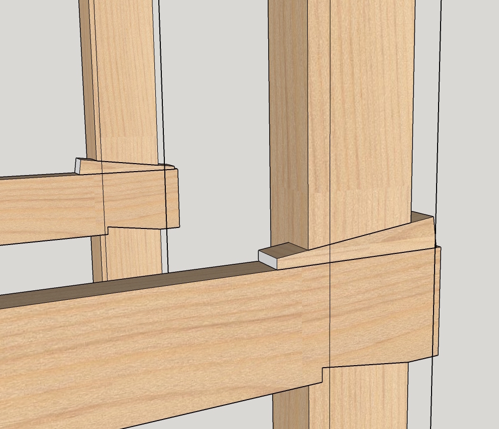

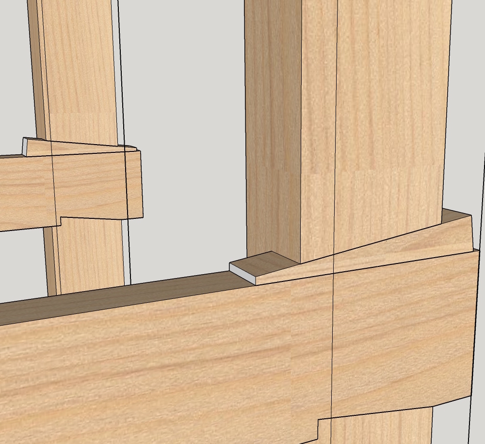

In the previous post we looked at a couple of options for a through version of the half dovetail:
Nuki to post connections compare half dovetails.jpg (511.4 KiB) Viewed 27993 times
In the interest of being thorough, there is more to explore with this connection yet.
Note that the wedges used in both joint version pictured are exactly the same size and slope, and sit proud of the post by the same amount on each side.

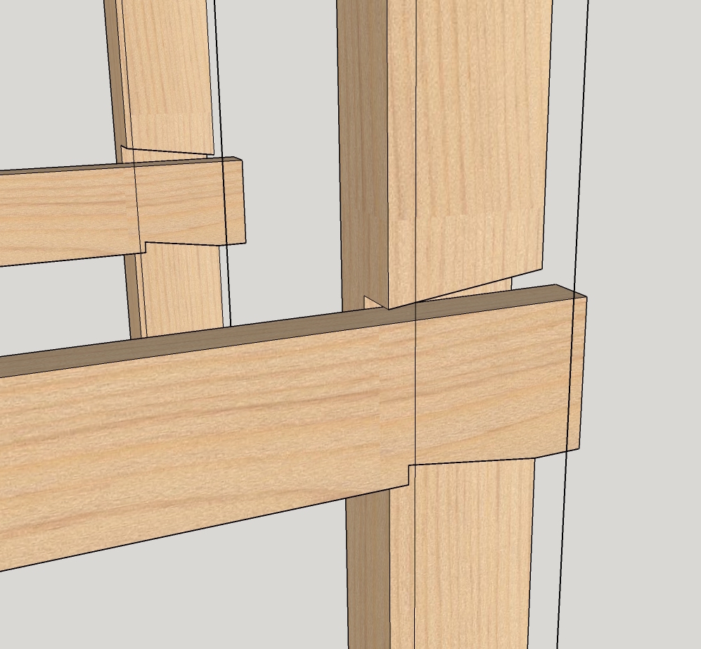

Now we'll take the wedges out:
Nuki to post connections compare half dovetails 2.jpg (440.22 KiB) Viewed 27993 times

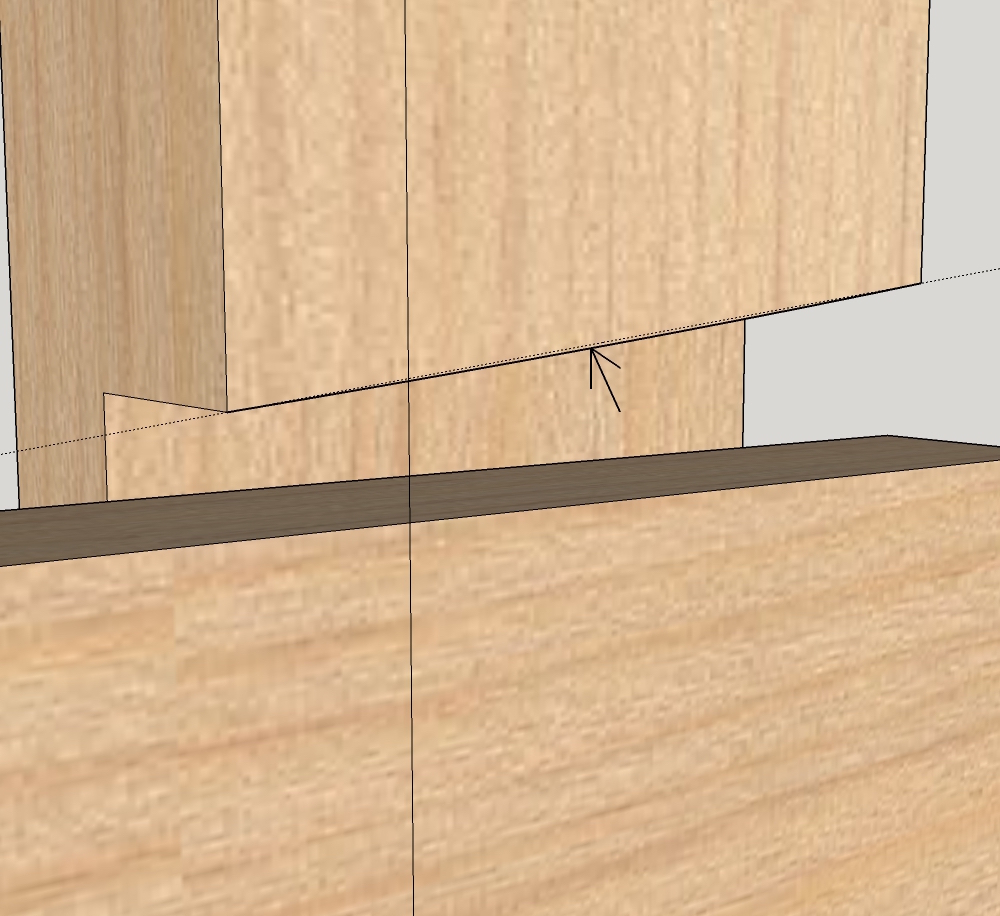

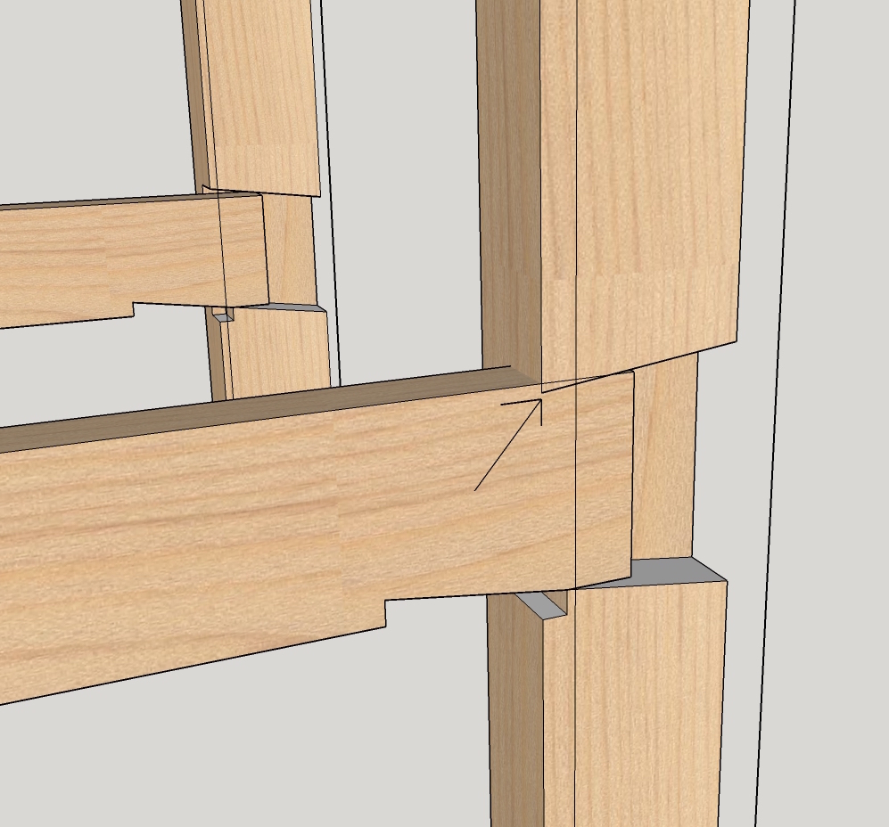

Next, let's withdraw the stretchers up the mortise ramp and see what happens, remembering from an earlier illustration that we need the mortise to allow the entry of the stretcher:
Nuki to post connections compare half dovetails 3.jpg (419.92 KiB) Viewed 27993 times
You can see clearly that the form of this joint in which the wedge is driven in the same direction in which the stretcher enters the post ( the background assembly) has no points of interference at the mortise opening when the stretcher is drawn back to present its maximum height. Not so with the version in the foreground, in which the wedge enters from the exit face of the stretcher - note the arrow showing where the mortise interferes with the stretcher. The mortise therefore would have to be made taller to accommodate the same stretcher, or the stretcher shrunk down in height. Since a stretcher is a structural component, we will assume the height is the height it needs to be for strength, and so therefore the only option really is to make the mortise taller, all things being equal between the two joints.
The upshot then is that driving the wedge from the backside of the post means that the mortise must be taller and the wedge therefore is also taller to fit the opening.
In this example, the mortise on the foreground example has been adjusted upwards, along with the wedge, which has been thickened:
Nuki to post connections compare half dovetails 4.jpg (439.05 KiB) Viewed 27993 times
And removing all the parts so we can compare just the wedges:
Nuki to post connections wedges compared.jpg (120.85 KiB) Viewed 27993 times
So, this demonstrates fairly clearly, that if you have the option to insert the wedge from the same side as the stretcher enters from, you will gain the benefits of a smaller mortise and slimmer wedge. The smaller mortise makes for a stronger post, and the slimmer wedge is going to be less affected by seasonal movement as would the taller wedge. The advantage is clear in that respect.
One point in favor of having the wedge enter from the exit face is that any loading on the stretcher which exerts tension - tries to withdraw the stretcher - will tend to tighten the wedge automatically. It has a slight mechanical advantage in that sense.

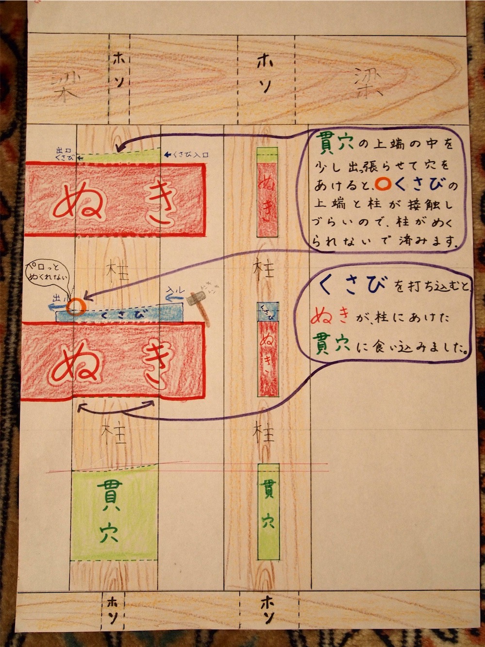

Here's a Japanese graphic I came across showing the same thing:
nuki detailing-small.JPG (410.86 KiB) Viewed 27981 times
They seem to have goofed up on the tenon orientations for the post there, but that is besides the point.

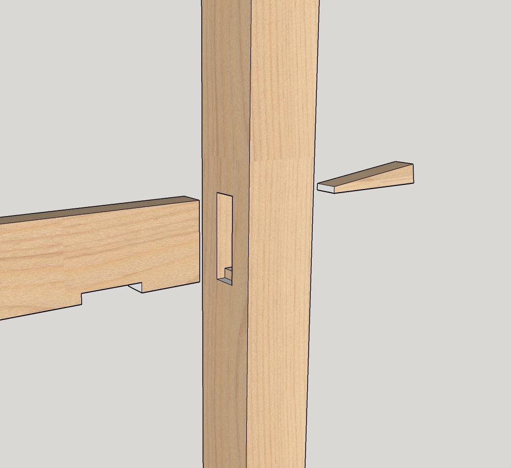

渡り顎 Watari Ago.
Watari means "cross (over)", and ago means "jaw".
Like the connection described previously with the half-dovetail, this joint can be used at the termination of a stretcher or as a mid-point connection.
The parts:
Nuki to post connections wedged cogged a.jpg (253.94 KiB) Viewed 27978 times

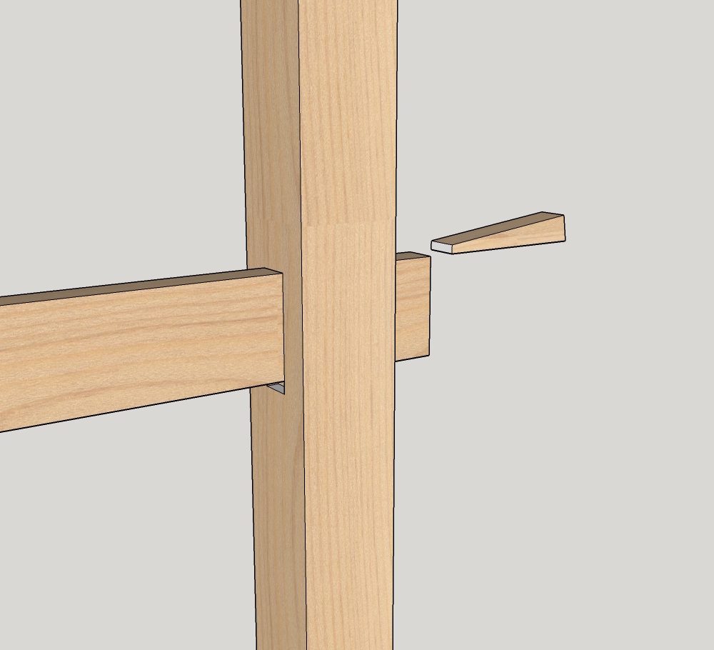

The stretcher slides in laterally:
Nuki to post connections wedged cogged b.jpg (244.92 KiB) Viewed 27978 times

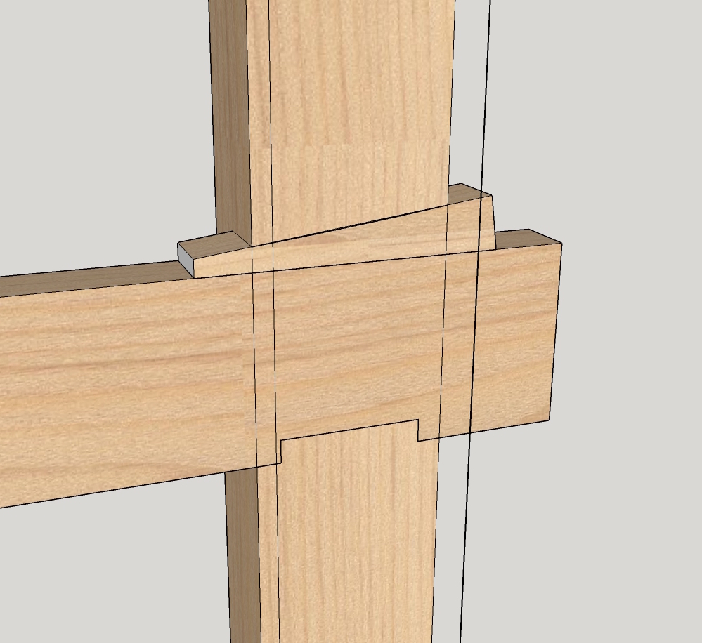

Then the stretcher drops down over the cogged portion:
Nuki to post connections wedged cogged c.jpg (249.75 KiB) Viewed 27978 times
And then the wedge secures the connection - again, the joint may be detailed such that the wedge may be inserted from entry or exit face:
Nuki to post connections wedged cogged d.jpg (277.24 KiB) Viewed 27975 times

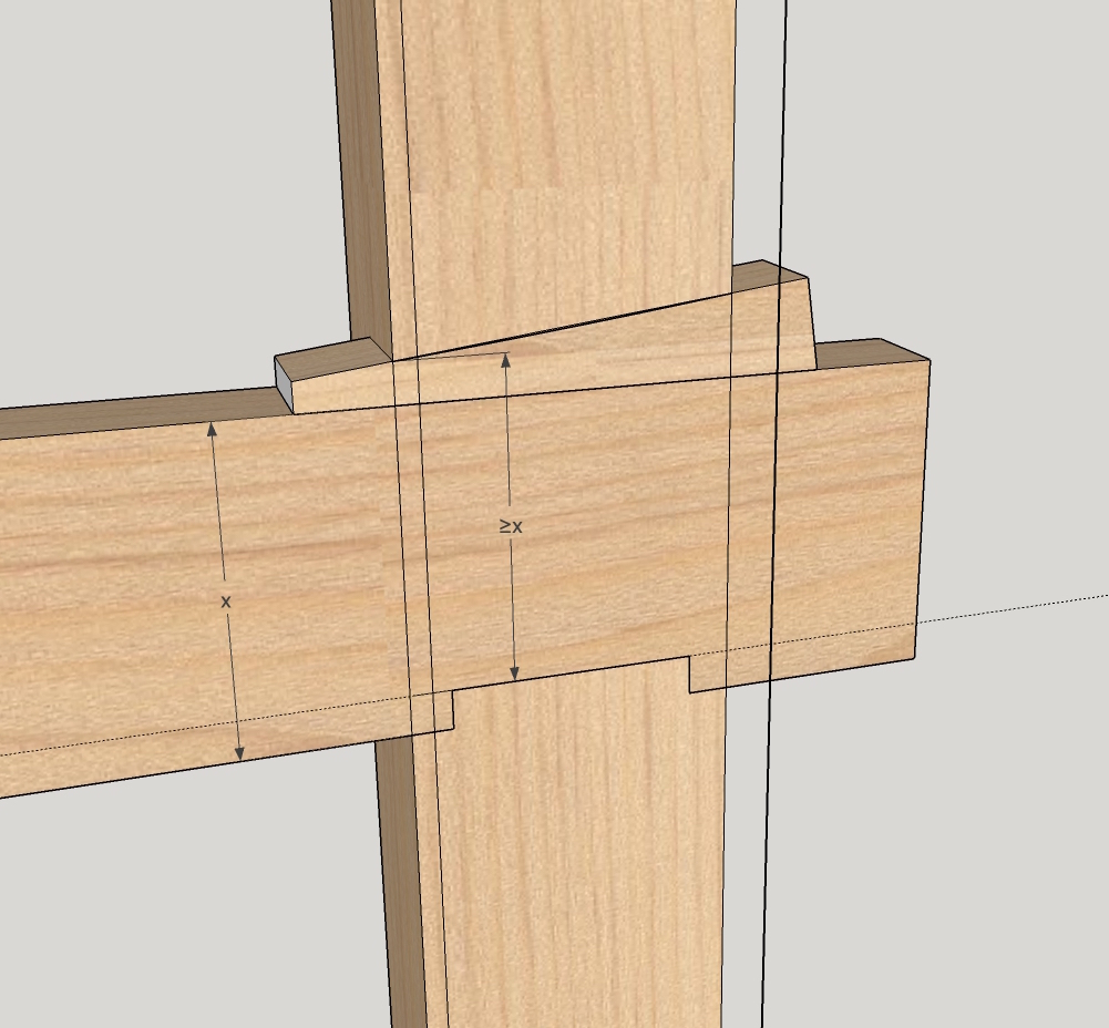

The mortise opening height must, at a minimum, be equal to the stretcher section height:
Nuki to post connections mortise opening.jpg (372.03 KiB) Viewed 27965 times
Probably best to allow an extra mm or two so as to make the fitting a little less difficult.
