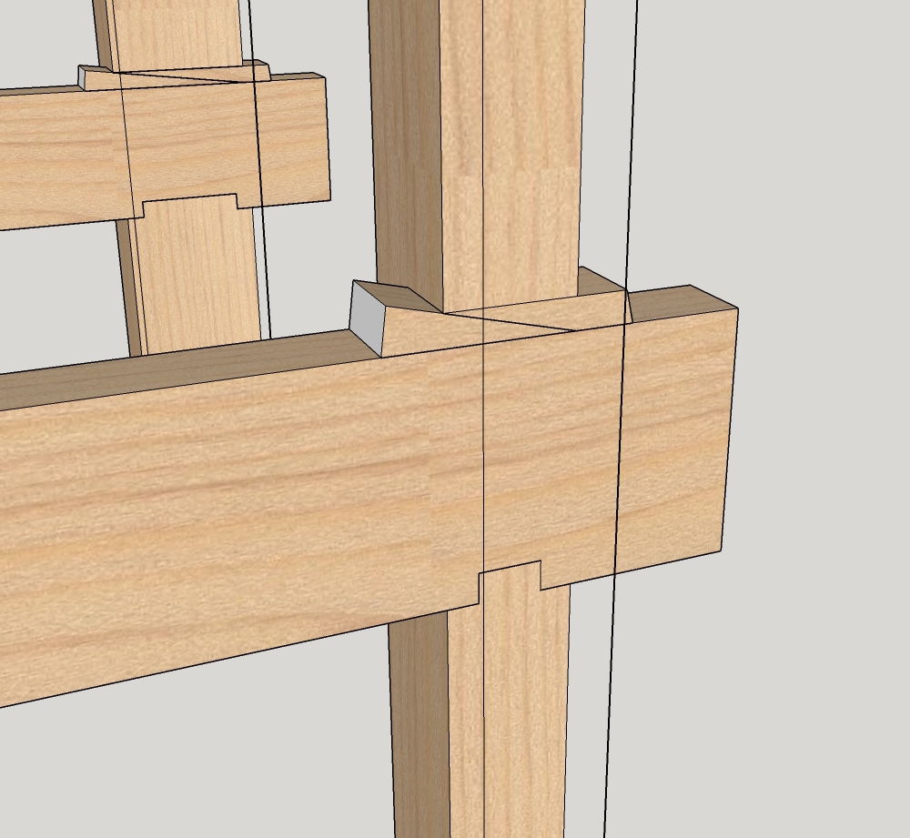

This is all great stuff, and much appreciated, but I do have a question regarding the Watari Ago joint.
It seems to me, although I may be missing something very obvious, that you would need to make a vertical chop within the mortise to form that "hump" in the middle, and I can't see how you would do that. How do you go about cutting that mortise?

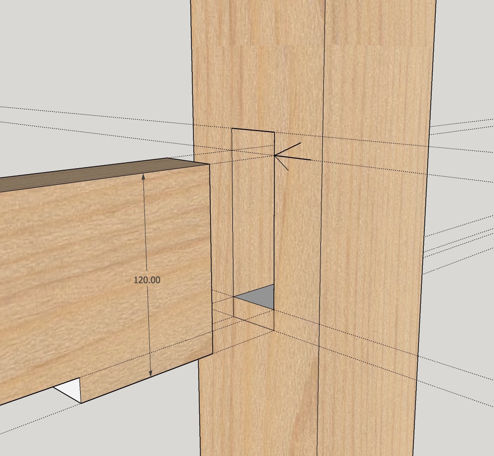

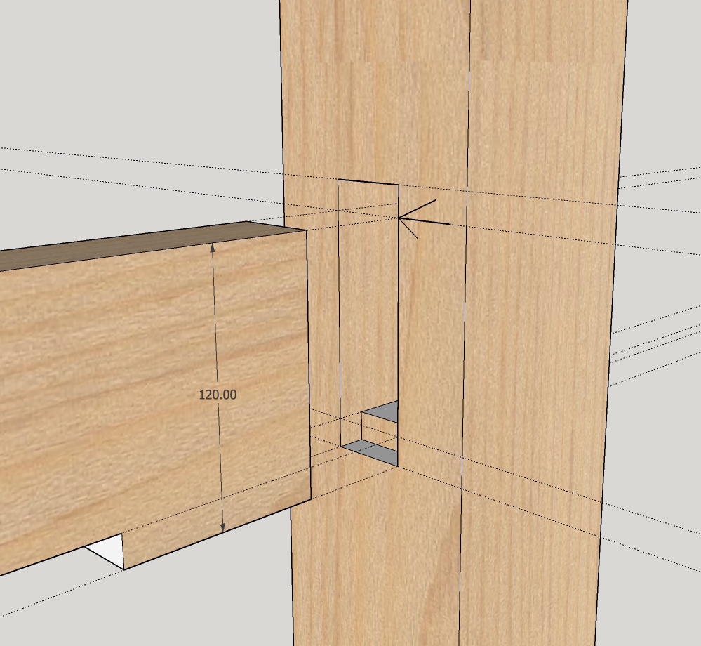

markberg wrote:It seems to me, although I may be missing something very obvious, that you would need to make a vertical chop within the mortise to form that "hump" in the middle, and I can't see how you would do that. How do you go about cutting that mortise?
The mortise is simple to cut. First you cut a through mortise. Let's say the jaw of the joint houses upwards 15mm, and in from the post face each side by 15mm as well. All you have to do is cut a 15mm long, 15mm deep housing at the bottom of the already cut through mortise, on each side, and the joint is produced.
Assuming a 120mm tall stretcher, here is the layout:
Nuki to post connections mortise sequence 1.jpg (473 KiB) Viewed 23742 times
The arrow on the post marks the finish position of the stretcher after it is inserted.

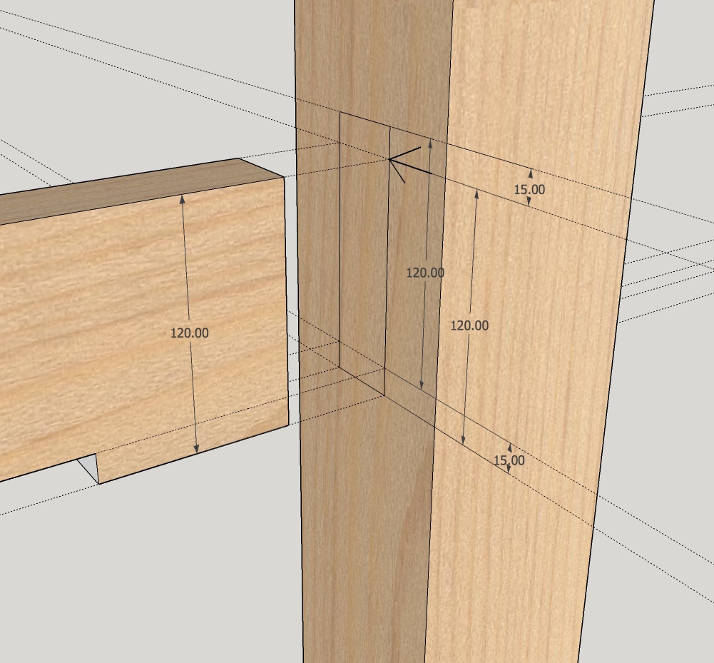

Mortise through, leaving the 15mm notch allowance:
Nuki to post connections mortise sequence 2.jpg (471.9 KiB) Viewed 23742 times

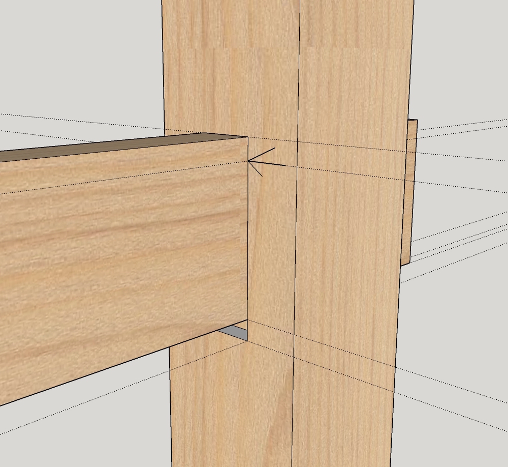

Cut notch, 15mm x 15mm:
Nuki to post connections mortise sequence 3.jpg (476.95 KiB) Viewed 23742 times
The cutting of the housing on each side leaves the middle bit of the post inside sticking up proud by 15mm.
All that remains is to add the taper to the upper mortise wall for the wedge to be accommodated.

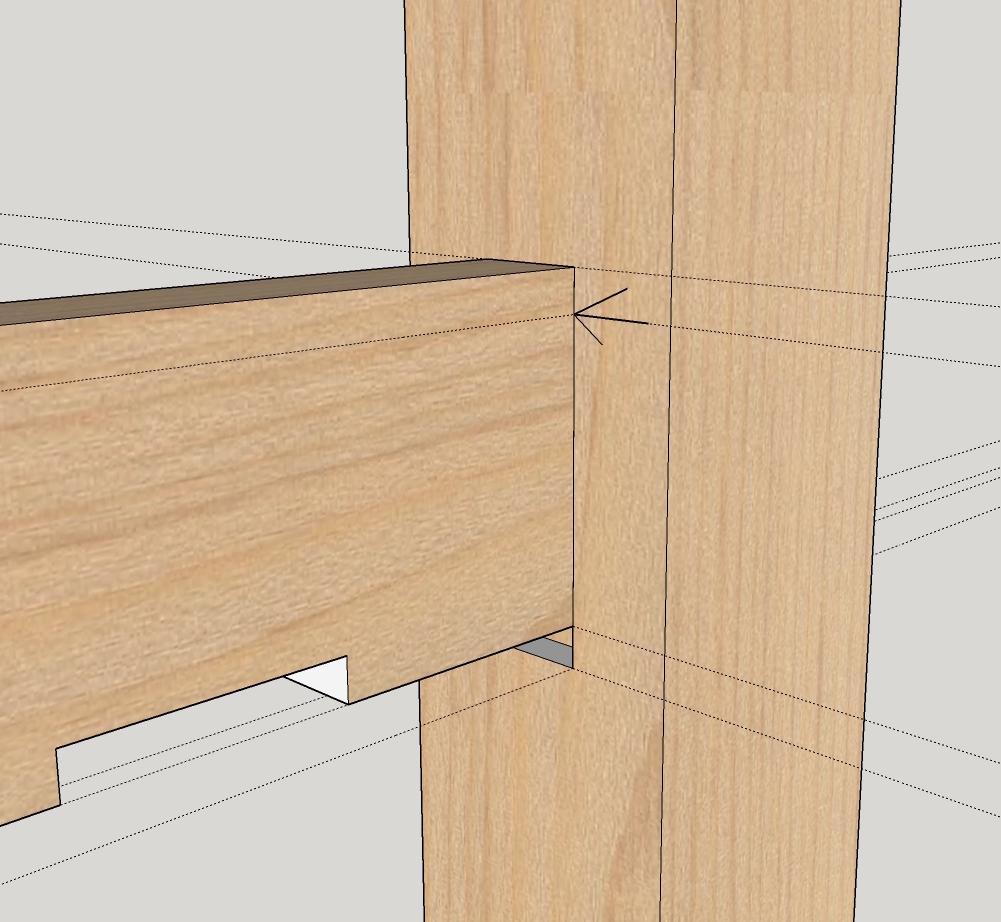

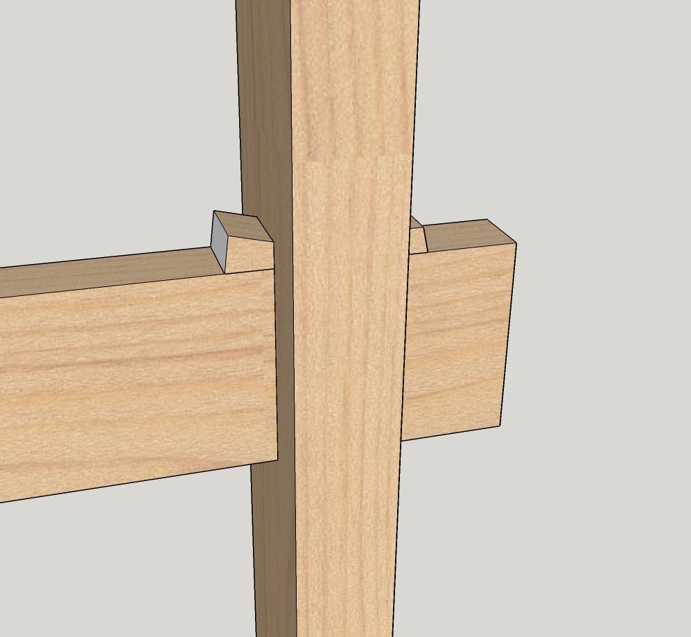

The stretcher inserts in the high position:
Nuki to post connections mortise sequence 4.jpg (465.27 KiB) Viewed 23742 times

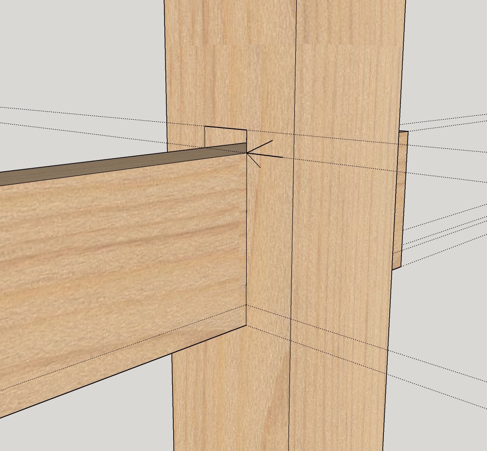

Slides through:
Nuki to post connections mortise sequence 5.jpg (448.94 KiB) Viewed 23742 times
Drops down:
Nuki to post connections mortise sequence 6.jpg (460.11 KiB) Viewed 23742 times
And then the wedge is put in. Make sense?

Now we can take a look at the two previous joint mechanisms (half dovetailed and cogged), except this time secure the stretchers using two wedges instead of one.
There are a couple of different ways to go about it, and both involve inserting a wedge from each side. Here is the first type, where the wedges are gapped apart inside the post:
Nuki to post connections double wedge a.jpg (585.3 KiB) Viewed 23698 times
In the background we see an example where the opposed wedges enter a mortise with a straight-across upper mortise wall, and in the foreground we have a version in which the upper end grain wall of the mortise is sloped to match the upper surfaces of the wedges.
While the version in the foreground has a bit better mechanical connection between the parts, as a result of the fact that the middle of the mortise dips downward to the midpoint, we must make the mortise taller overall and the wedges considerably thicker to allow enough space for the stretcher to enter upon assembly. Trade offs....
