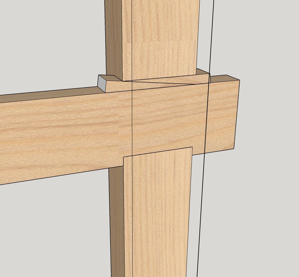

You could eliminate the notch within the post altogether, and widen the stretcher notch out to be the same width as the post, like this:
The problem with this approach however is that you lose stretcher strength against vertical loads, as the underside of the stretcher is no longer supported as it was when housed. The stretcher is weakened by the notching more than if the joint were housed and the entire stretcher section were to be carried by the mortise housing. The same problem applies to the idea you mentioned of making the shallow notches in the post faces into sloped abutments instead, in the interest of doing the work simply with fewer chisels or non-specialized tools.
Further, by widening the notch like that, you make the joint a little more prone to loosening due to shrinkage in the post. Shrinkage is a percentage after all, so a wider notch on the stretcher spanning the post entirely means that shrinkage or swelling in the post will have a slightly larger (and obviously visible) effect than if you house the stretcher. The same can be said with the half dovetail version which is un-housed, as compared to the housed version. I mention this issue in regards to the mechanical loss that results from the shrinkage, not the aesthetic one of a visible gap. Again, these types of joints are not generally meant for use on furniture of other places where there might be a need for highly refined visible joinery. A sawhorse, is somewhere closer to the rough framing of architecture in the scheme of things, but then again, one might make a 'sawhorse' as a furniture piece as well, used to support a table top or similar.

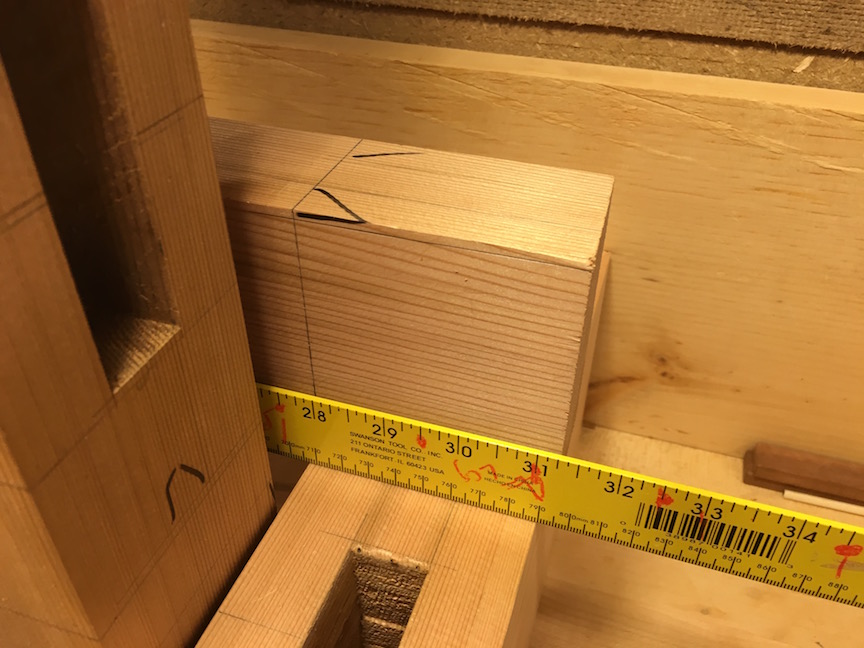

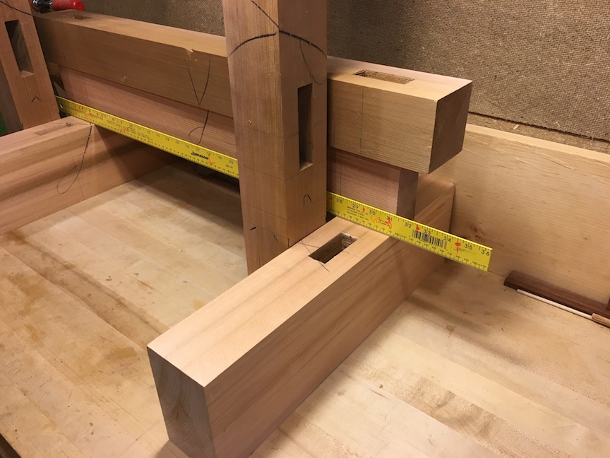

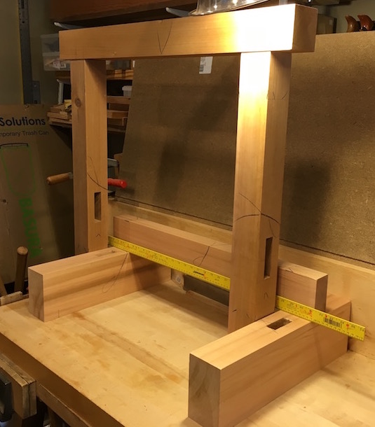

I am providing photos of one set of sticks for one set of two saw horses (both sets are at the same progress) to support beams. I had started them before this explaining different alternatives to connections was started. After the first method was explained I decided to go ahead with the direction I had started and squared up the ends of the mortices for the stretcher ( have not squared up ends of other mortices) but after reviewing the 渡り顎 Watari Ago join I saw that that would be a better option. The only issue I have with that is that the overall length of the stretcher material I have cut is just long enough to reach thru the leg post since it matches mortices I have in the top beam. I could move the leg posts closer together and replace the top beams or just use them as is and make the cog narrower to accommodate the thru end.
Critique welcome.
Anyway here are photos and I will be holding on the project while waiting to see other options.
Critique welcome.

How far beyond the cog would the stretcher extend if you did the watari ago connection?
My statement above of better option was pertaining to strength/stability. I'm still weighing the option of the half dovetail and use all parts as presently cut. The stretcher would be left shouldered.
I'm sure open to suggestions.
Re: Stretcher to Post Joinery
If I decide that route, I would extend it by the width of the cog.Chris Hall wrote:How far beyond the cog would the stretcher extend if you did the watari ago connection?
