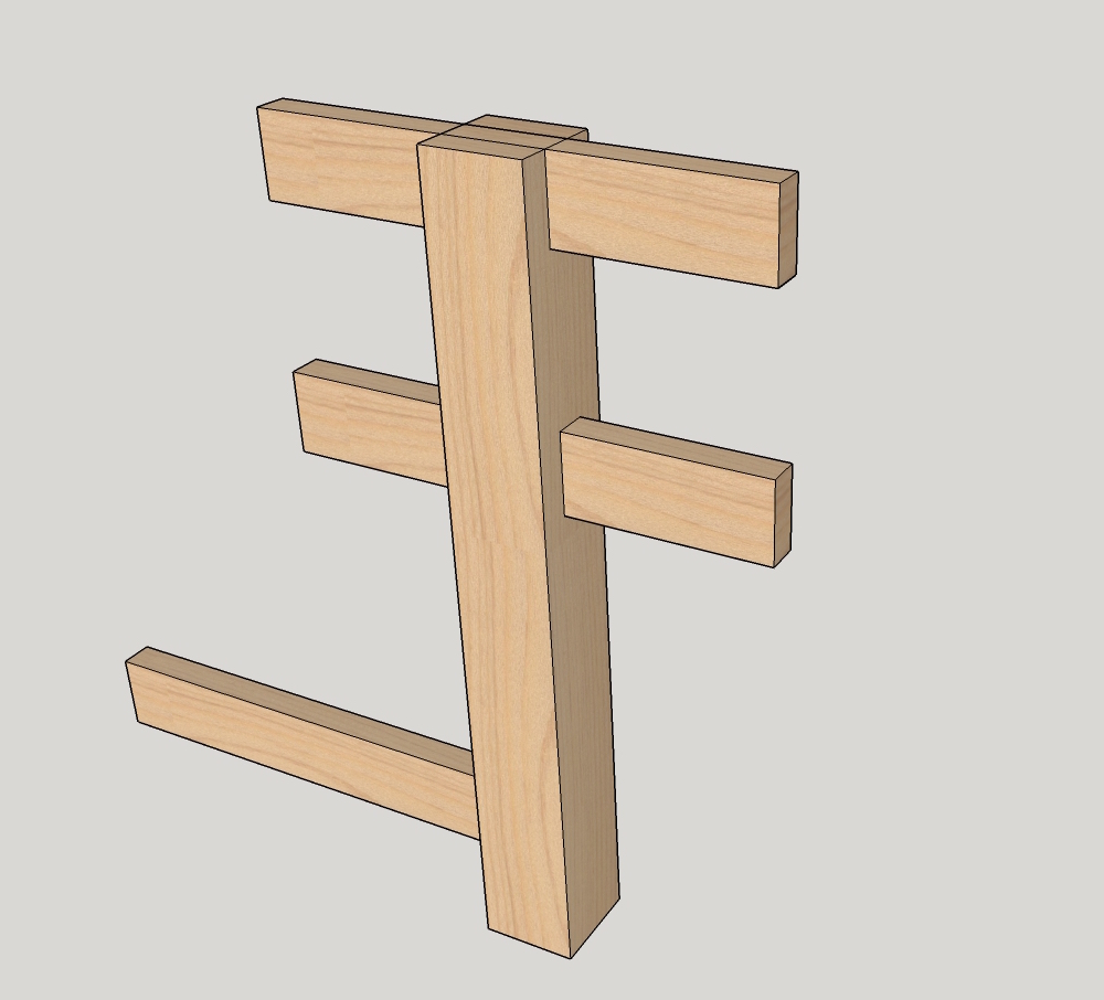

I think the following drawing outlines the main conditions where we have to devise joinery between stretcher and post. The post section is 'a', the stretcher section is rectangular, measuring 0.33a x a:
I have centered the stretcher on the post face in each case.

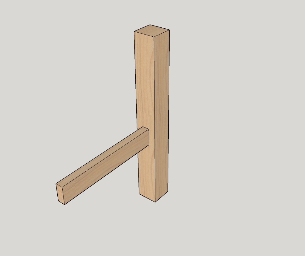

At the bottom, we have the stretcher terminate at the post, though it can also pass completely through the posts and continue to some extent. The main thing is that it does not connect to further structural members beyond the post. It could also connect to the top or bottom post end.
In the middle we have a stretcher which meets the post and passes though, connecting to other structural members beyond in each direction. The stretcher itself can be one-piece as it passes through the post, or it can be two-piece, each of which joins to the other inside of the post. One could also have the end of the stretcher splice continue beyond the bounds of the post if desired.
On the top of the drawing we have a stretcher meeting the top of a post. Once again, the stretcher can be one-piece or two-piece. The post may connect to another member above the stretcher. This is the weaker form of connection mechanically as it bears on a minimum of 3 surfaces in the joint, one of which is end grain, while the stretcher passing through the post somewhere must meet at least 4 faces in the joint, two of which are end grain surfaces. Essentially this is a bridle joint, an open mortise and tenon. Not the strongest, and reliant upon glue for integrity, but there are some better ways to deal with this connection.
All these joints are strongest if the stretcher is one piece instead of two piece.

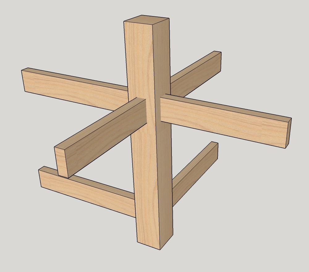

Stretchers may also meet one another at a post at a right angle, and again, the respective stretchers might terminate at the post, might pass through the post to some further point of connection, and may be one-piece or two-piece:
Now, it should be acknowledged that the above examples are dealing only with orthogonal relationships between the parts. The members could also meet at varying angles in relation to one another. Some joinery options will work for such cases, others won't.
So, there is a considerable range of possibilities to look at. And the above is only considering situations where the stretcher is 1/3 as wide as the post. All the same connections can be considered for stretchers that are 2/3 as wide as the post, 1:1, or even where the horizontal members are larger sections than the post. So, I'm going to stick to the 1/3 case for now.

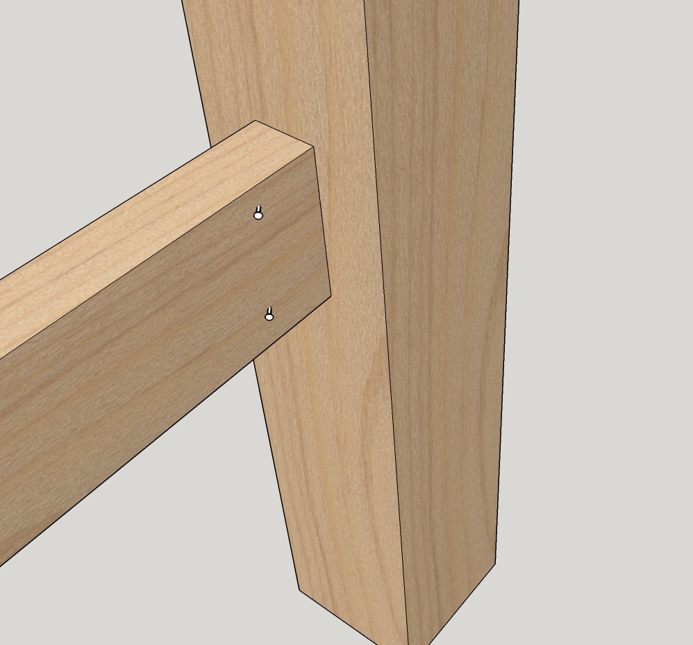

The simplest connection would be to butt the stretcher against the post and toe nail in a nail or two:
Other than the case where the stretcher is driven directly against the post face, the only resistance to loading on the stretcher would be provided by the nails. Nails are ductile and strong fasteners, but form points of condensation and will induce rotting in their location, so the lifespan is not that great. Look at any nailed wooden fence and you will see the first spots to rot are the locations of nails and locations where wood meets the soil. A nailed connection gives marginal strength and a marginal lifespan. Primary virtues are that it is quick and easy to form, and therefore inexpensive.

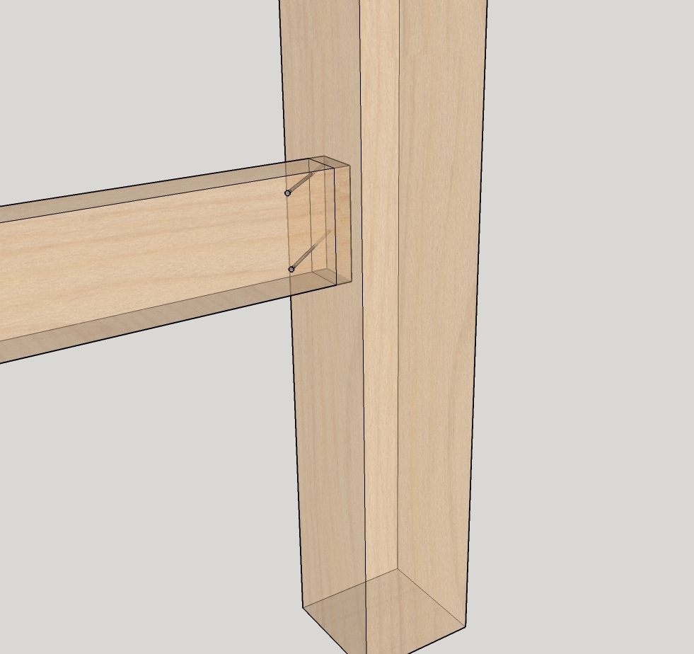

The nailed connection can be significantly improved by mortising a shallow housing on the post, which improves mechanical strength considerably:
Once we start looking to joinery as a means of attachment, arguments for cheap and fast methods gradually begins to recede in importance.

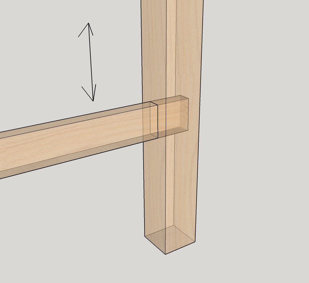

In this situation, a mortise in the post will initially provide the greatest benefit of mechanical strength for loads on the stretcher in a vertical direction:
If the stretcher were to be loaded in a cross-wise direction, then the stretcher section is inappropriately oriented.

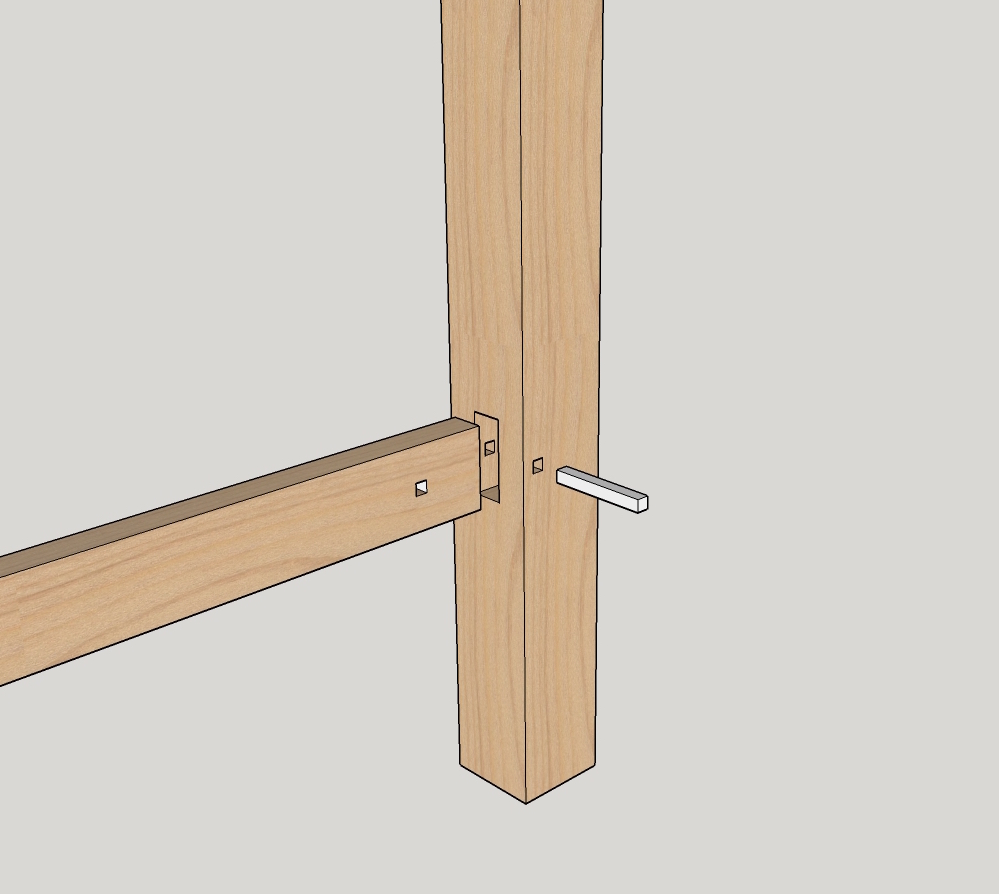

A shallow mortise provides a measure of mechanical strength, so deepening the mortise will be an improvement, and a peg can be added to fix the connection:
The mortise has been stopped shy of going through; a connection with the tenon going right through is essentially similar. The peg adds a modest amount of strength and stiffness to the joint, but primarily this connection would be strong against the stretcher being loaded vertically, like the rung of a ladder:

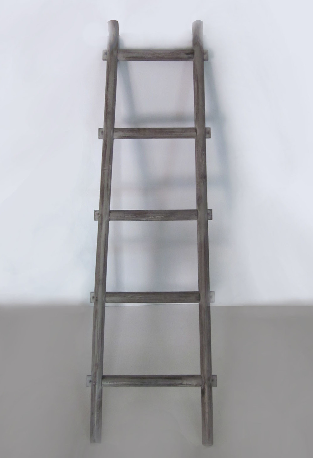

Strictly, speaking, the above is a mortise and tenoned ladder, with tenons shouldered, however the essential point carries through. The main load to be resisted is vertical, and loads which pull or push along the line of the stretcher are minimal in nature. A peg is not a stiff connection, and in a small ladder that is no issue, particularly given the number of elements connected to one another, and provided that the mortises are close-fitting to the stretchers.
In the ladder the stretchers are carried right through the verticals, which are slender in section, thus it makes sense to carry the stretchers right though to provide adequate relais beyond the pegs.
