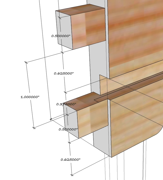

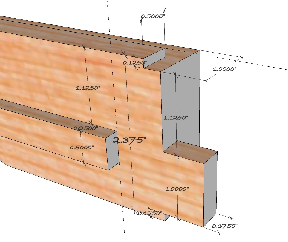

Here's a close up of the reconfigured handle end, which I have colored in a lighter wood to make the dimensions easier to see:
道具箱 handle details.jpg (111.97 KiB) Viewed 22156 times
Basically, the stick is 2.375" tall by 1.25" thick, and as long as you need it to be for your box.

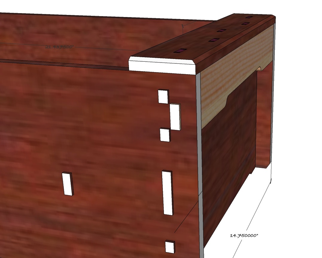

With the handle back in place, here is how the end tenon cluster looks:
道具箱 box corner detail.jpg (106.83 KiB) Viewed 22156 times
Design is an interesting process and I appreciate the questions about 'why' it is the way it is since it gives me the opportunity to revisit the issue. In the case of the handle, I spent most of my attention trying to solve the attachment of the cap to the handle and end board, and other aspects of the design in that area did not receive as much consideration as they could have. I feel that with today's slight change, the connection looks tidier and the stopped tongue and groove retains greater strength in the end board.

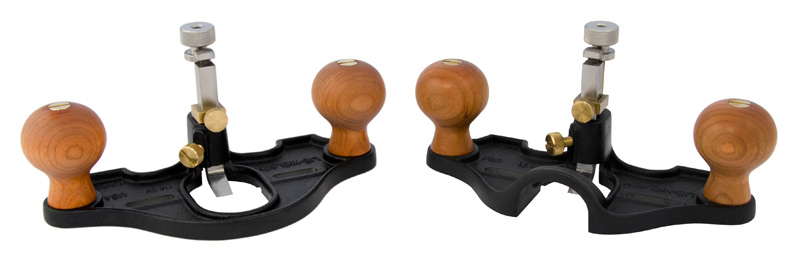

Well, it depends. If you have a old witch's tooth (an un-powered router) you could chop and pare your way there:
Or, use a grooving plane and make the tongue as I had it configured in the 'Mark 1' version. Or, if either joinery option is troublesome to execute, you could forgo the tongue and groove altogether and simply glue/screw the handle and end board together.

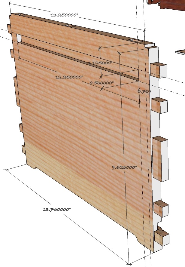

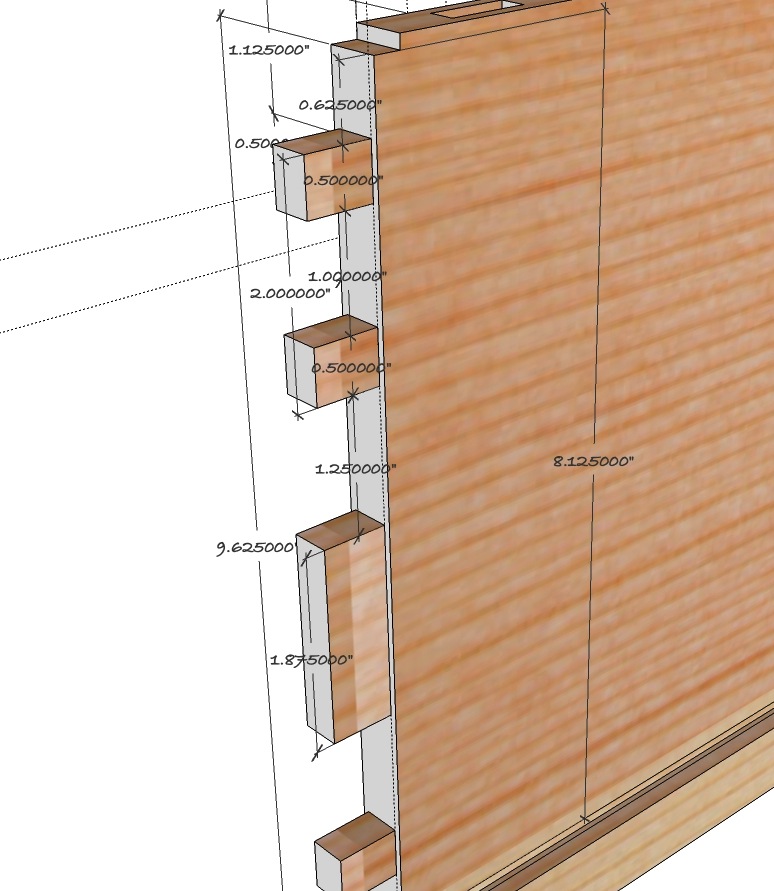

Some more detail views of the corner joints - first the end boards and their tenons:
道具箱 end board b.jpg (125.45 KiB) Viewed 22136 times
Lower end tenon pair and dado for floor:
道具箱 end board c.jpg (81.73 KiB) Viewed 22136 times

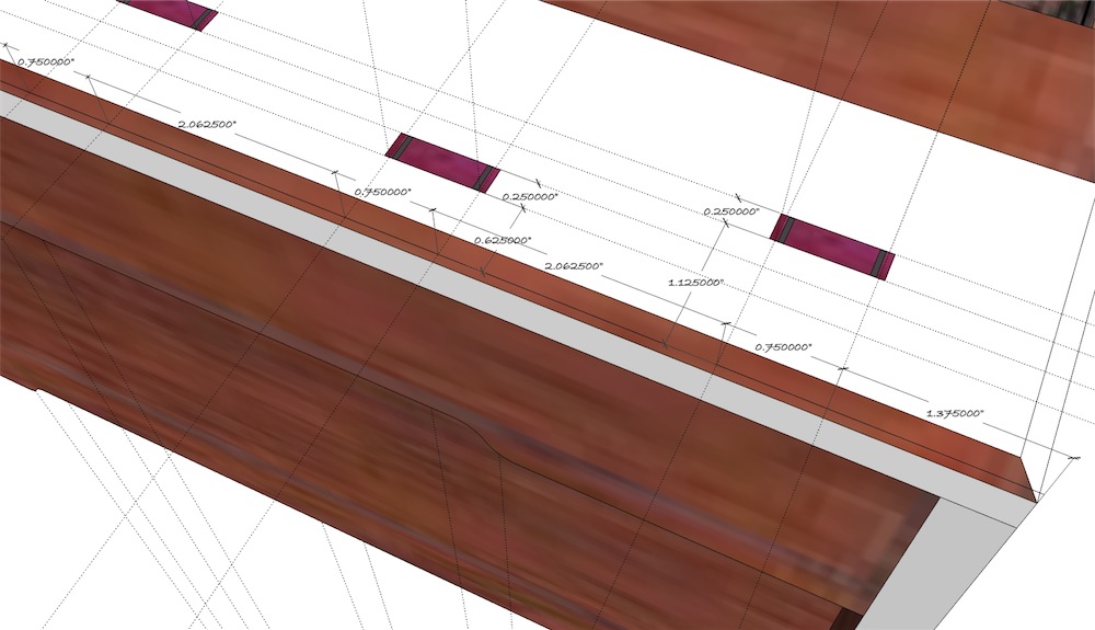

Top edge:
道具箱 end board d.jpg (151.65 KiB) Viewed 22136 times
Outside face:
道具箱 end board.jpg (127.64 KiB) Viewed 22136 times

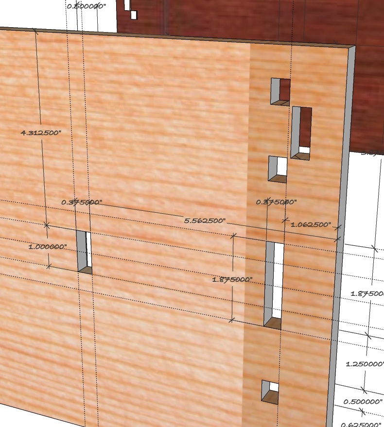

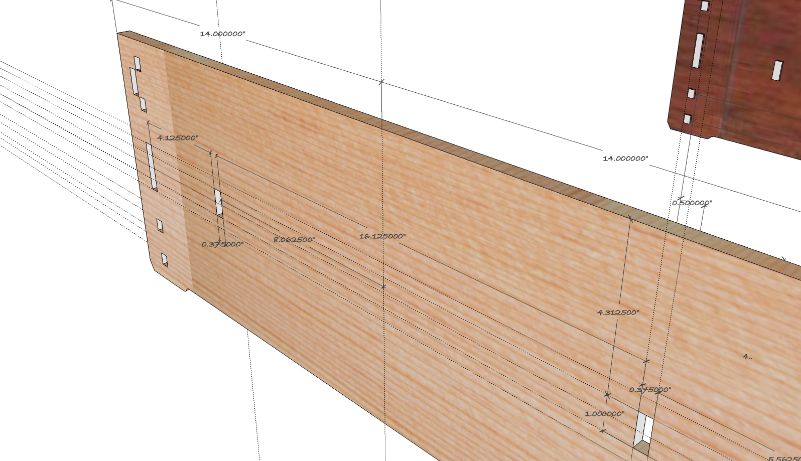

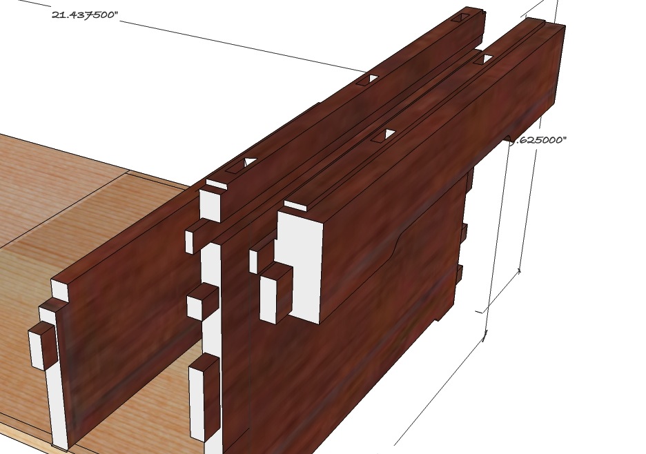

Then the long side boards:
道具箱 long board end.jpg (148.26 KiB) Viewed 22136 times
道具箱 long board b.jpg (179.33 KiB) Viewed 22136 times
道具箱 long board c.jpg (213.36 KiB) Viewed 22136 times
Outside face:
道具箱 long board d.jpg (671.91 KiB) Viewed 22136 times
Now, your box might not be exactly as tall as mine, at 9.625", so you'll have to modify the tenon spacing slightly. Try to keep the outer pairs of tenons as they are drawn and make your dimensional changes to the central tenon and the space between the central tenon and the outboard tenons pairs. Try to keep your floor panel dado at the same position as i have located it and the same goes for the handle dado in the end panels.
If there are other views you'd like to see, or certain dimensions, let me know.

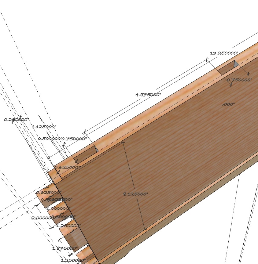

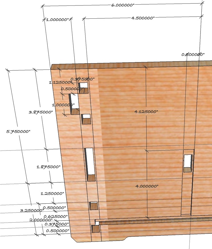

Though it is partly shown in an above picture, here is some more detail for the cap and it's 5 mortises:
道具箱 cap -small.jpg (120.18 KiB) Viewed 22056 times
Note that the 0.75" width for the key mortises is the measurement for an un-flared key. Depending upon the dimensions you use for your cap, the flare might be in the range of 3/64"~1/16" on each side.

Re: Views
Sun Mar 25, 2012 3:07 pm
Hi Chris, So the slope of the flare is 1:8?
