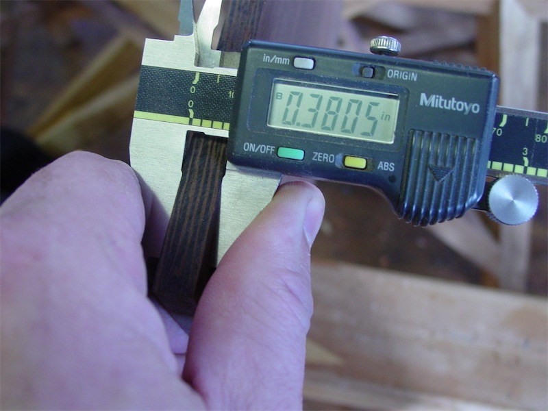

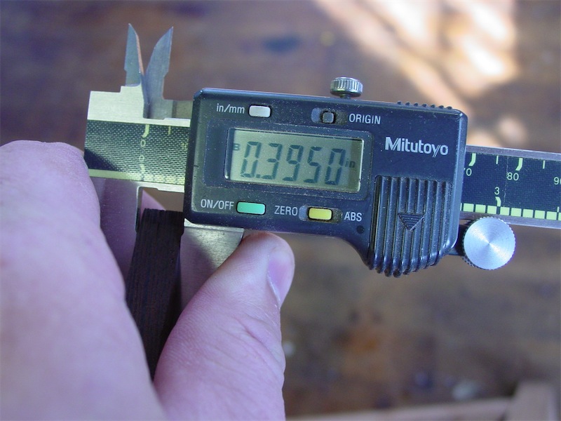

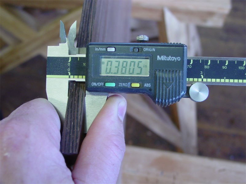

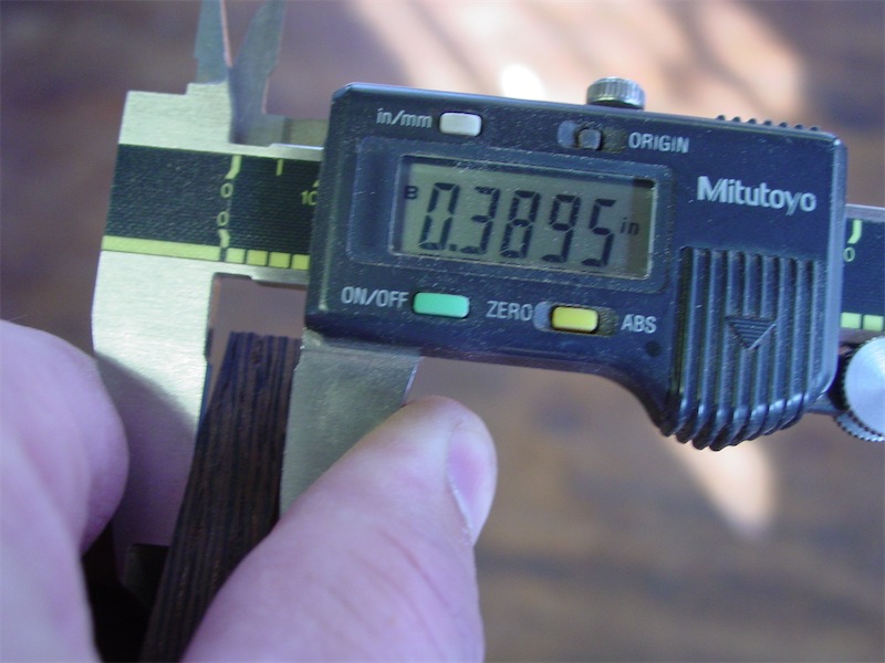

I did a round of planing today on the Wenge top, which went well. I videotaped and and am currently trying to figure out why there is no sound :roll:
The starting thickness was around 0.395"~0.400". After round one of planing, I took some measurements of the thickness at the four corners:
It seems like I take about 0.005"~0.010" off with a round of planing before I have to resharpen. After the above measurements, I did a little more planing to take down the two highest corners. Now the four corners are in the range of 0.380"~0.385"
I realized though that the Wenge is going to need a coat or three of Tung Oil, and I usually wet sand the first coat of oil in with Wenge (and more tropical hardwoods for that matter). So, though I am a round of planing short of the target thickness of 0.375", I will probably hold off on any more planing, at least on the upper surface. I'll work in a couple of coats of Tung Oil into the upper and lower surfaces next, then I'll set up to do the dovetail mortises for the battens. When the tray gets fitted, It can be adjusted up and down to give a good fit against the underside of the lid. I'm thinking though that the lid finish on the underside is going to tend to get rubbed a bit by the upper tray edges every time the lid is slid on and off. So, I won't build the Tung oil up at all on the lid underside, just a soak-in coat and then one more, followed by a steel-wooling.
