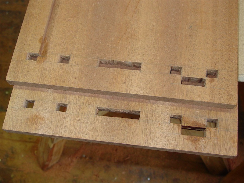

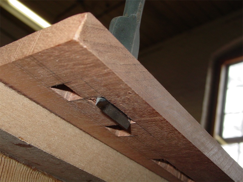

By request, here are a few different ways to mortise. I am mortising the long side boards for the handle tenons.

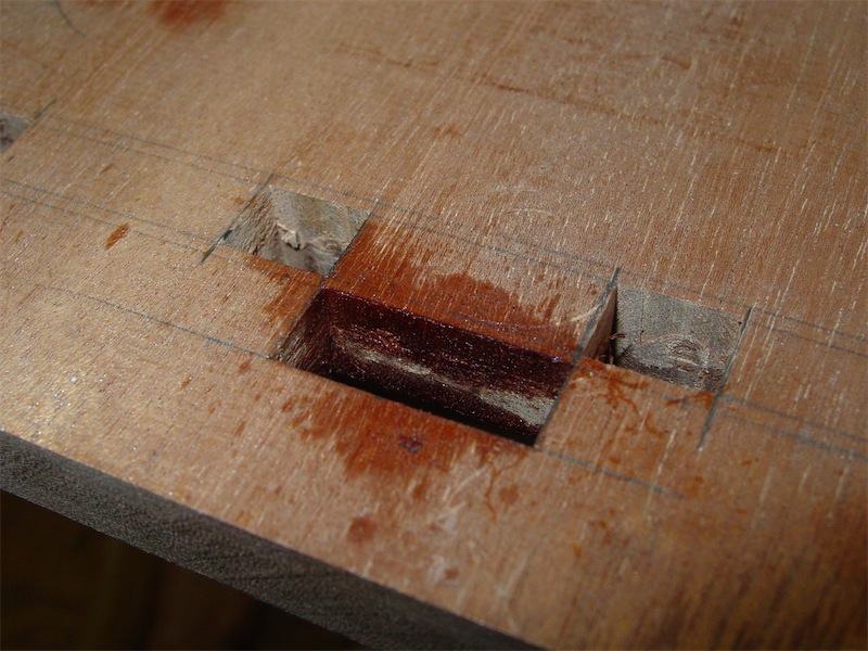

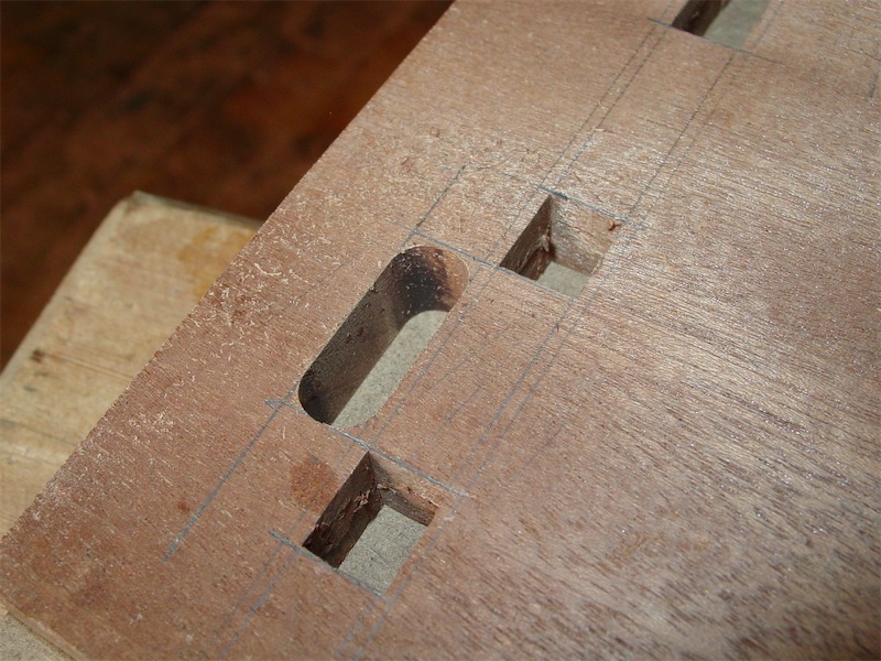

First up, with a router and an 8mm bit and the router edge guide reference to the end grain of the stick, I rough out the hole:
Then I chisel the corners square and that is that:

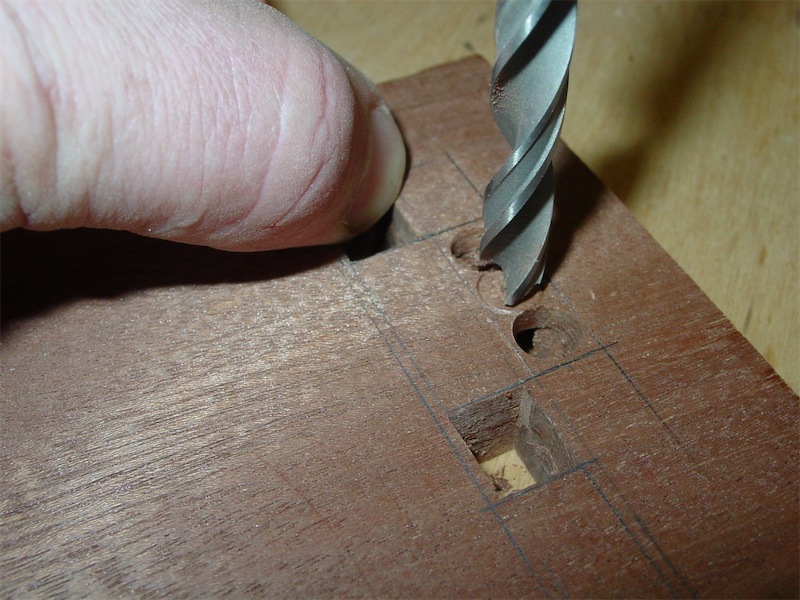

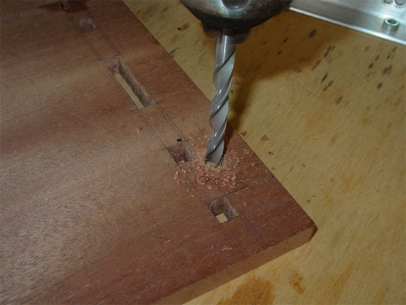

Second, using a drill press (or, slightly more riskily, a hand held drill), I rough out the mortises. with this method, I first knife the sides of the mortise.
Then I use a 5/16" brad point bit:

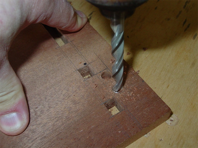

Then a second hole - I only drill through slightly more than half way from the face:
A third hole completes the rough-out:

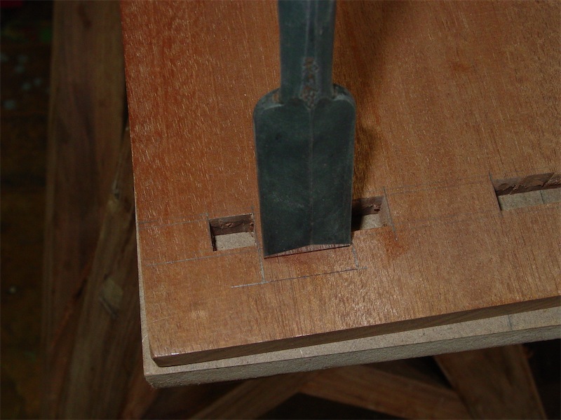

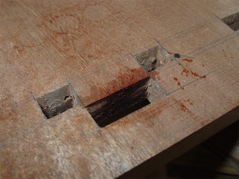

Then I begin to pare the hole clean:
Further along - I always leave the paring of the end walls, along the knifed lines, for very last:
Mostly complete now:

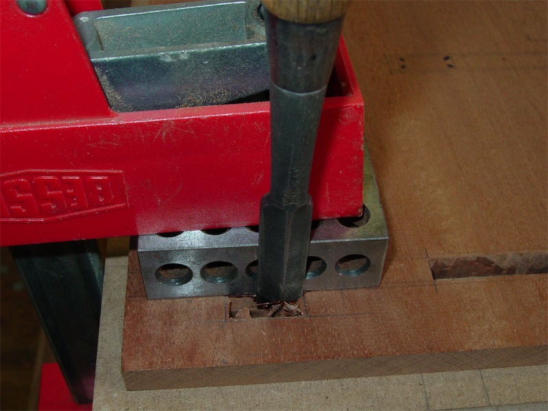

Then out comes a paring guide and I take the cut to the line:

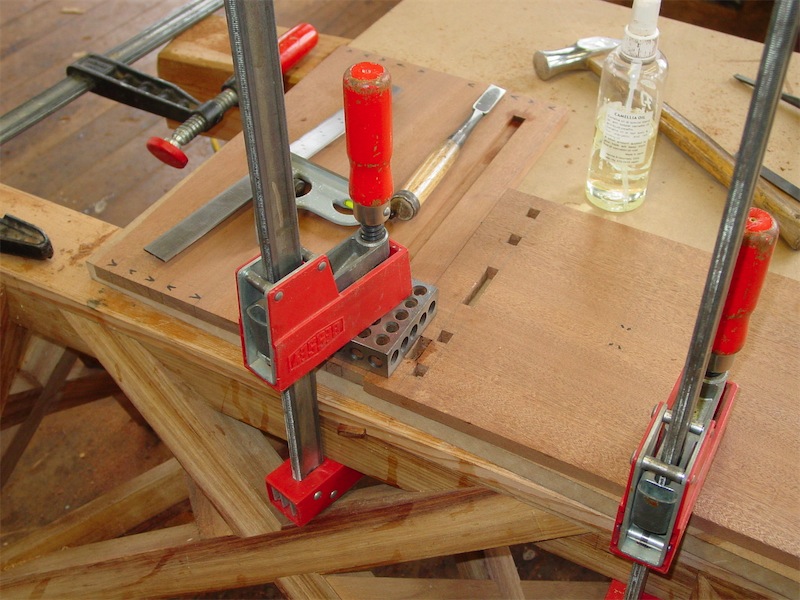

To pare the outer face of the mortise, I place another board adjacent so the paring block can be supported, and clamp everything so it can't move:
Complete to the point where it awaits fitting of the tenon:

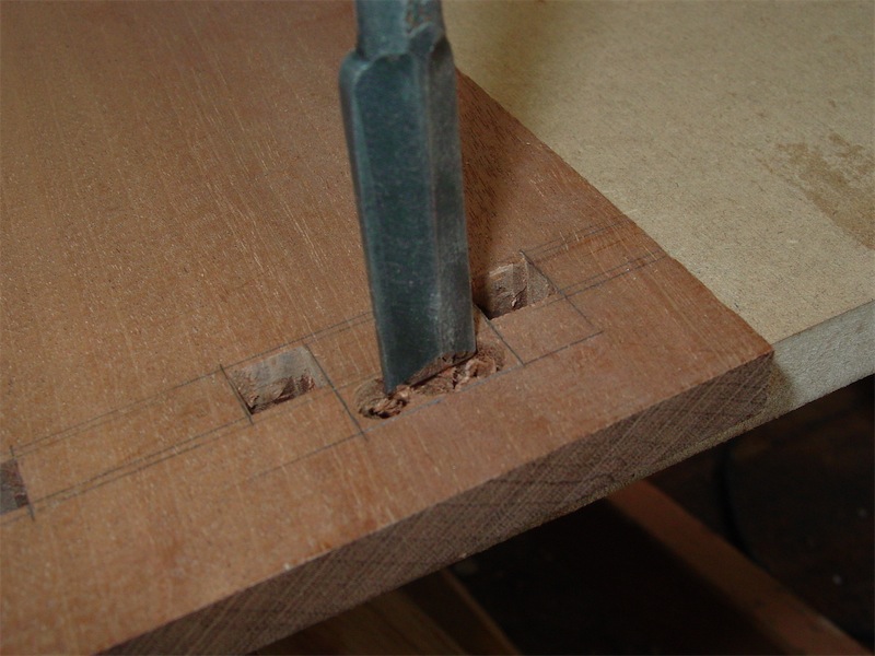

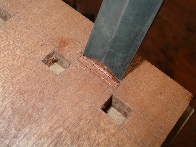

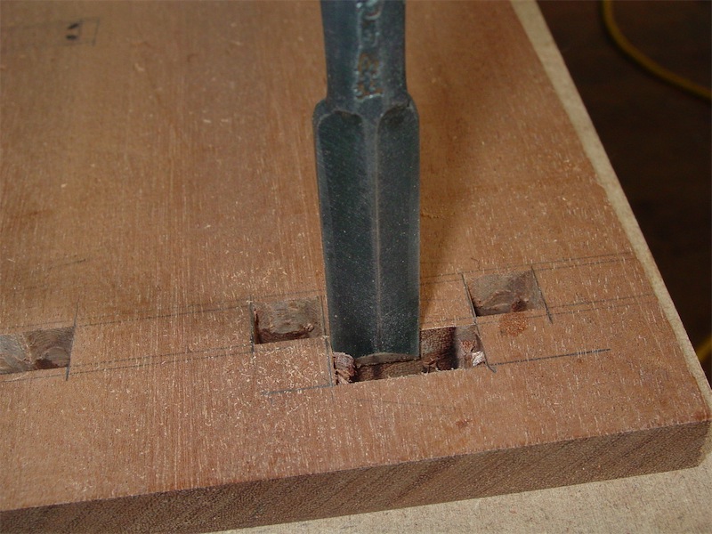

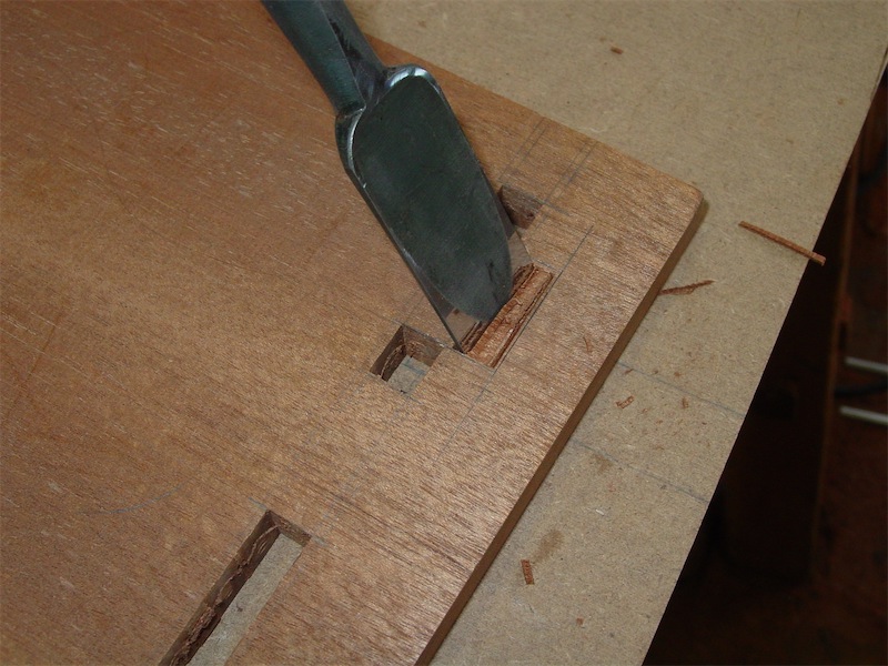

Next method: Chopping the mortise entirely with a chisel.
I choose a chisel that is close in size to the width of the mortise - this is where it helps to have a good range of chisel sizes:
The chopping starts at the middle and proceeds outward:
Some people suggest chopping around the perimeter of the mortise to define it at the start, but I think this is bad practice as the chisel will tend to push the opening slightly larger.
I chop and chop until I have gone about half-way through - takes about a minute I guess:

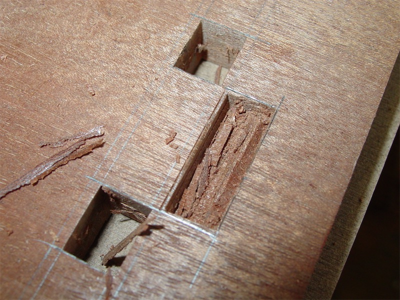

Then I turn the board over and repeat the process on the other side:

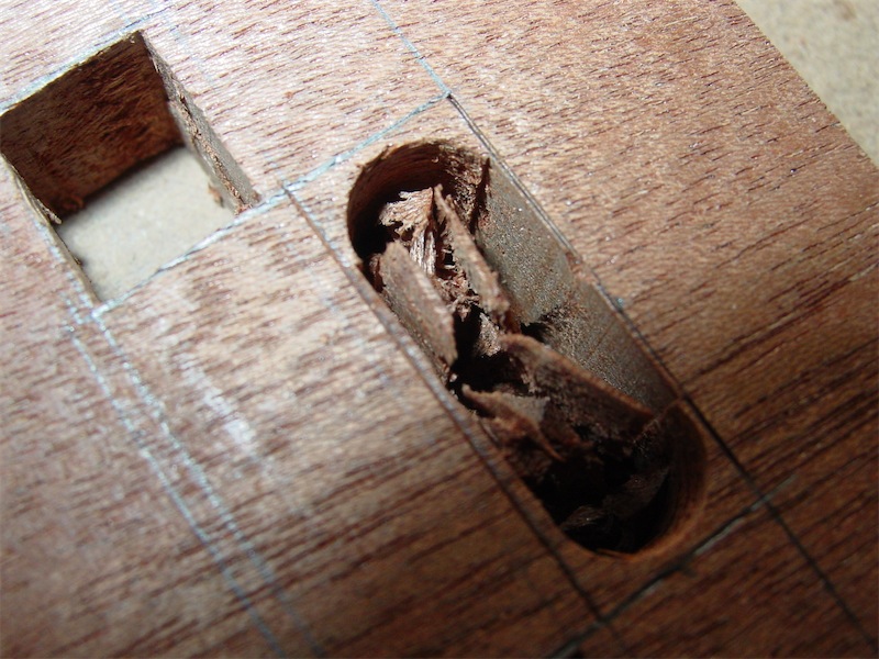

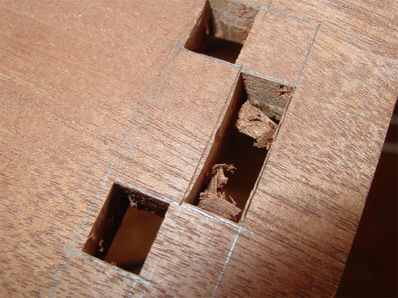

Work carefully as you go, especially as you near the middle - try to avoid a sudden blast through as you may get some interior tear out.
Here I've finally made it through with the chisel:
Then, much like the previous example, I pare until I have cleaned the mortise to dimension:
A couple of completed mortises - the upper boards was routed, the lower board hand chopped:
The handle tenon mortise just completed is not going to be wedged. The other mortises are all for wedged tenons and haven't been pared out yet. They're rough and ready. Lotsa wedgin' and tenonin' on this project!
Any questions, fire away.

Charles wrote:Chris..... is that a bit of water applied to the board before you make the cut with the chisel ?
I look forward to videos in the future but at the moment the lack of video is not a hindarence ... your drawings and writing style are very clear ....
That is not water - which would be a bad idea - but Camellia oil.It is a light vegetable oil and helps lubricate the cutting action. i generally use it more for paring than chopping, and more for abrasive woods than ones that are easy to work.

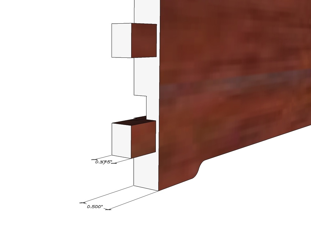

Chris, a couple of questions.
The end walls are .125" wider than the side walls. Looking at your photos the ends and sides look to have the same width. Do you still have to rip the .125" off the sidewalls or am I just not seeing it in the photos?
I can't seem to locate a measurment for the length of the tenons. How far out the do tenons of the end walls run out (stand proud) past the side walls when assembled? I guess another way of asking is what is the finished length ( ? x 9.75" x .5" ) of an end wall?

Marv,
not sure where you have seen that, but the end walls and side walls are exactly the same dimension at 0.5" thick. Perhaps the confusion is in the tenons? The tenons are 0.375" thick, and therefore the tenon board ends are rebated 1/16" on each side. this slight rebating helps conceal any slight irregularities at the root of the tenon where it meets the inside face of the connecting side board.
The tenons need to stick out beyond the face of the connecting board a minimum of 1/16", but 1/8" (3mm) would be better. It is not an absolutely critical dimension- you need enough extra sticking out so that when the sides of the tenon are wedged and flare out, the entire tenon remains proud of the surface. Then you trim the whole thing off flush. Does that make good sense?
Here's a picture of the rebated tenons on the end board for added clarification:

Wed Feb 15, 2012 1:23 am
... Ah, ok, the preliminary drawings gave me the impression the tenons would be proud. So, flush wedged tenons are the plan and that makes more sense to me. Good.
Chris Hall wrote: not sure where you have seen that, but the end walls and side walls are exactly the same dimension at 0.5" thick. Perhaps the confusion is in the tenons?
I guess I wasn't at all clear with the other question, sorry. I was referring to what you had written in an earlier post:
..."One point of note that should be borne in mind: the end boards of the box carcase are 1/8" (3mm) taller than the long side boards of the carcase."....
I couldn't tell from the recent photos if you had that 1/8" "taller" difference already machined, and that was what I was asking . It's just a small detail and really not important at this time.
