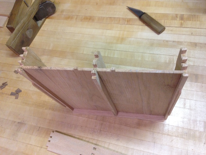

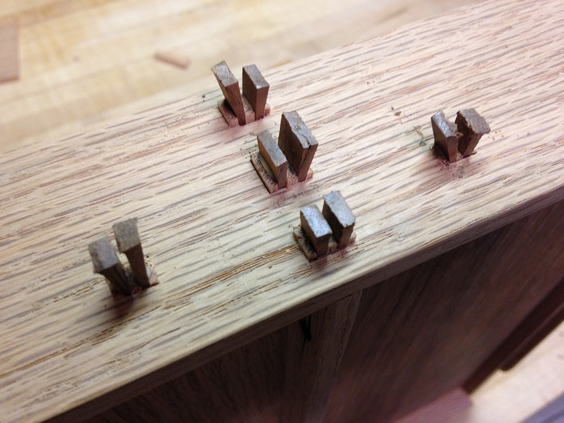

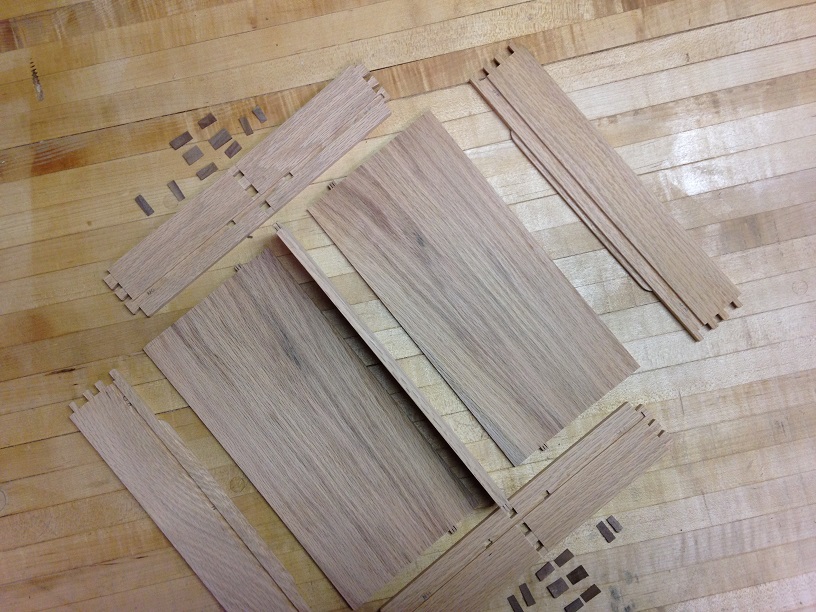

The trays are finally being assembled. The trays are held together without glue by way of wedged tenons and dovetails. There are 3 tenons on each end from a center rail and 2 tenons from the drawer bottoms. The tenons on the drawer bottoms are closer to the center so most of the seasonal movement will be towards the outside of the trays where the grooves for the bottoms is deeper. The dovetails on the corners will not get glue because I believe the tenons will hold everything together. For the joints to fail, something pretty dramatic would have to happen. I did put a drop of glue on each of the wedges, although I think they would hold without it.
The tray pieces ready for assembly.

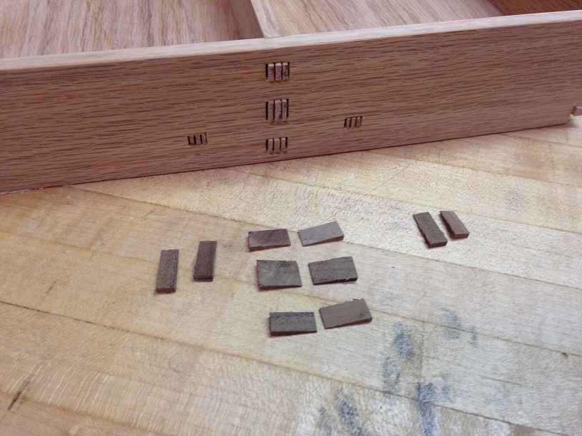

Each tenon gets 2 wedges.
tray 4.jpg (190.89 KiB) Viewed 28427 times
The tenons wedged awaiting trimming.
tray 5.jpg (170.41 KiB) Viewed 28427 times

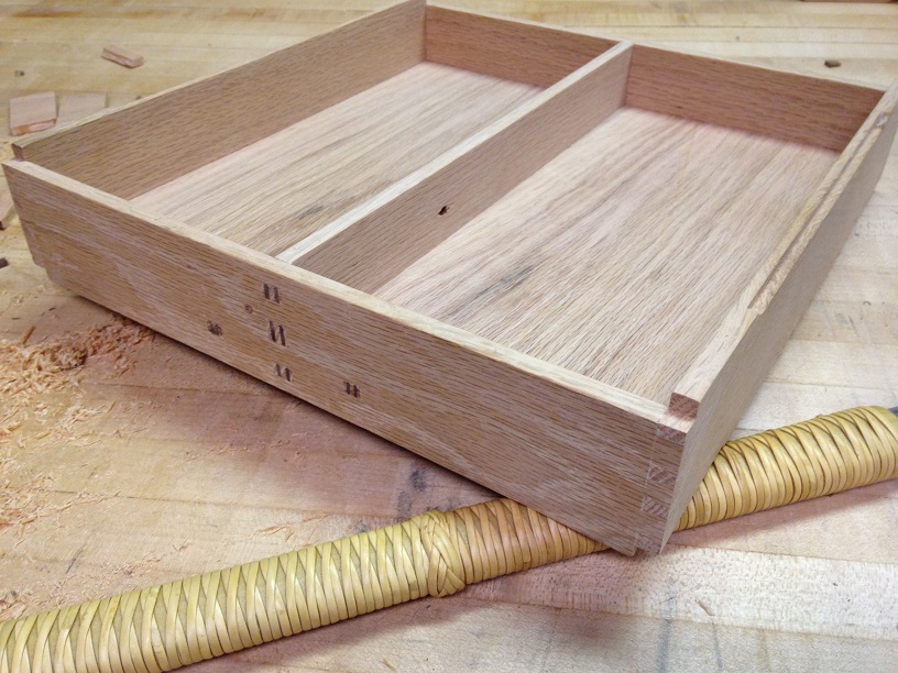

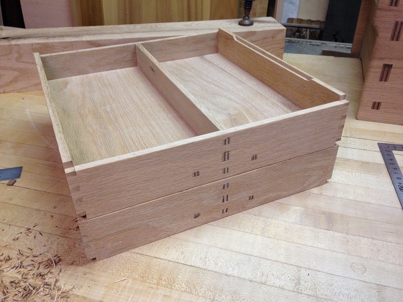

The tray assembled and the dovetails trimmed flush with the sides/ends.
tray 7.jpg (200.5 KiB) Viewed 28426 times

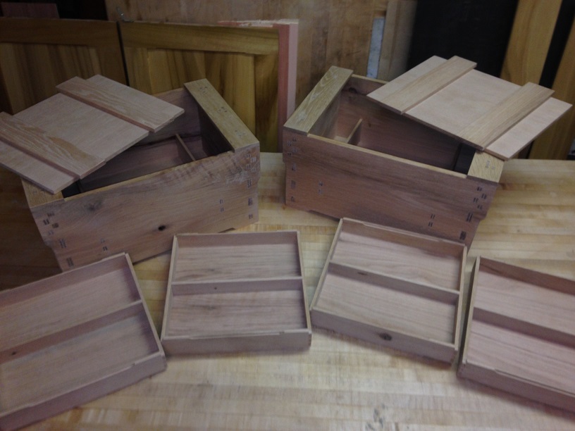

I built 2 boxes with 2 trays each. I will post pictures after I have put on a finish. I will use tongue oil as a finish. You may notice holes and blemishes in several places. This is reclaimed barn wood and I left some of the old nail holes to reflect this.

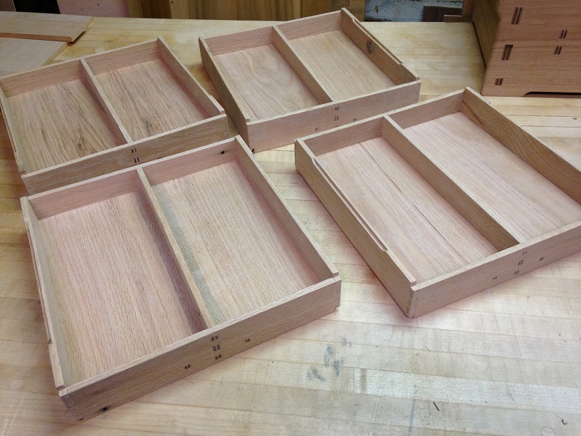

All 4 trays assembled.
tray 8.jpg (194.95 KiB) Viewed 28426 times

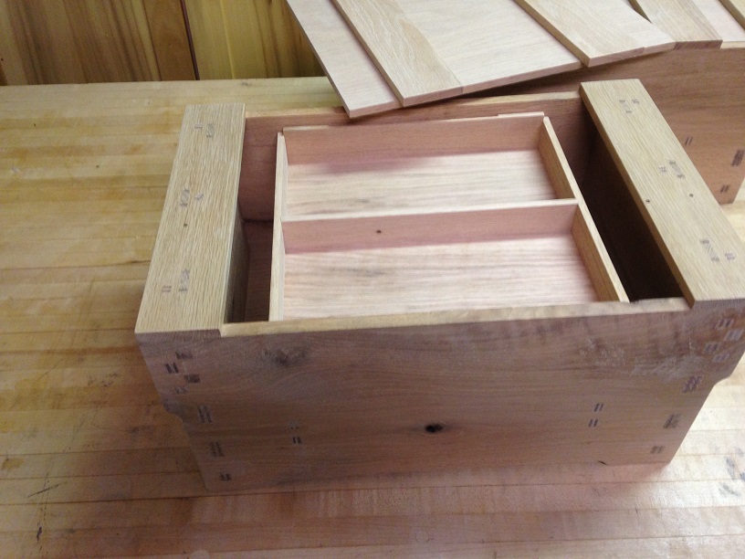

The trays stack and have interlocking sides to keep them from stacked when not in the box. The bottom of each tray overlaps the dividers in the bottom of the box to keep the trays in place.
tray 9.jpg (194.19 KiB) Viewed 28426 times
Each box gets 2 trays that neatly stack inside with room left on each end.
tray 12.jpg (149.9 KiB) Viewed 28426 times
Both boxes awaiting finish.

If the joinery in these trays fail, I will not be too unhappy and will hopefully learn something if they do. I built these with material pared down as much as I dared. I knew if I used thick material I would not have to worry about them breaking but they would be overly clunky and heavy and not at all "elegant". Any observations and suggestions from members would be appreciated (it is almost impossible to offend me). I built 2 boxes because it's only slightly more effort than building 1 while you have the saws/routers set up.
