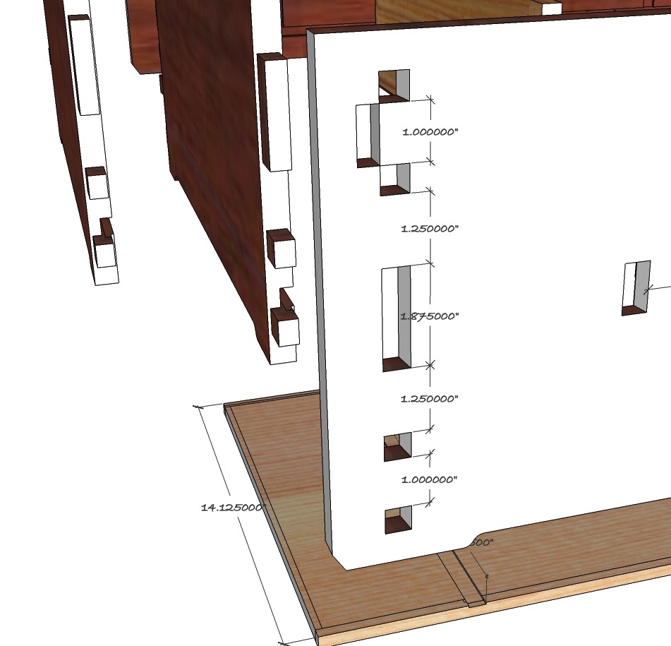

Here is what I came up with as I wanted to make sure I understood everything.
It's my first time with SketchUp so this took wayyyyy too long but I finally completed it. The only problem I see is the central mortise is not centered between the upper and lower mortise pairs. Is this problematic?
Also my partition mortise is only .375" wide but I don't foresee this causing many issues.

Middle tenon should be centered:
How do you get the tick marks between your dimensions instead of the arrows in SketchUp?
Click on 'Window' on the top of the screen to access the pulldown menu. Click on 'Model Info', then on 'Dimensions'. Select for 'Endpoints' as 'slash' instead of 'closed'. Highlight all dimensions in your model then click 'Update selected dimensions' in the same 'model info'--'dimensions' window. That should change them all to slashed.

Updated to have a central mortise. Working on the next models now. We get back from vacation late tomorrow night so hopefully I'll begin cutting some wood by next week.

This one went a little bit better. I'm starting to understand how to model things more efficiently, plus it requires me to think about each cut involved.
End boards are up next.
