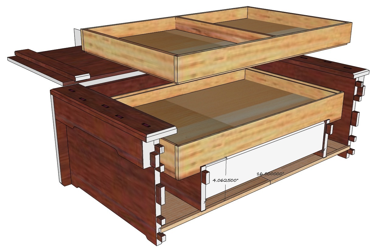

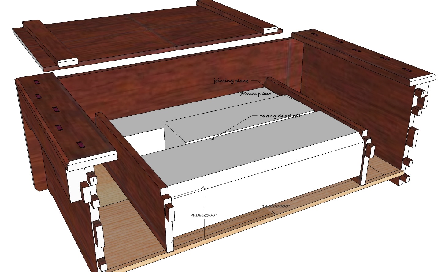

ot sure where you blokes are in the process, but I've been tinkering with the dimensions of my tool box using some white blocks in SketchUp to represent various things, like a 70mm plane, a roll of timber chisels, etc. I thought I'd share a couple of pics. If you don't have a drawing program, you could easily mock up using the real objects or possibly pieces of foam cut to the required size, or cardboard boxes.
I also made a slight change to the end joints of the interior partitions so that the interior tray will will be constrained from movement in two directions, just a little better, and that the interior tray floor can rest directly on the edge of the partition.
I made a slight change to the end joints of the interior partitions to accomplish that, and the interior partition end tenons remain centered in the long sides of the box.
道具箱 interior cut away.jpg (202.55 KiB) Viewed 15106 times
With the interior tray removed, you can see storage for a roll of paring chisels, a jointing plane, and a 70 mm smoothing plane, with room at the ends on the other side of the partitions for more planes:
道具箱 interior cut away 2.jpg (223.58 KiB) Viewed 15106 times
I may yet make that interior tray a little taller, which would increase the vertical dimension of the box walls, but it likely won't be a change of more than 1/4" (6mm) or so.

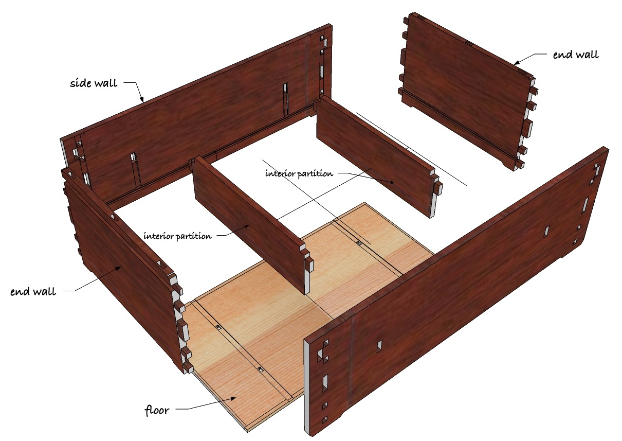

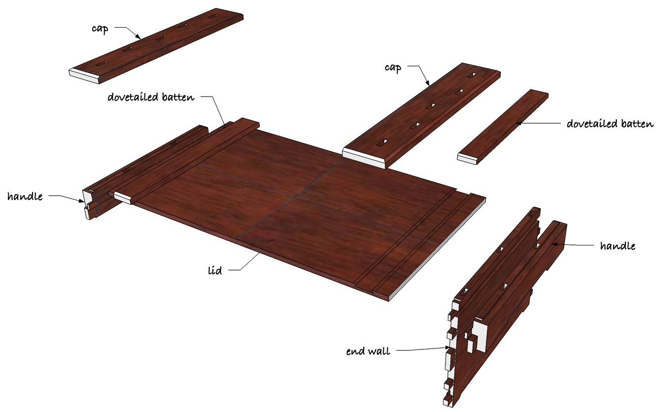

Chris, one suggestion that I think would be helpful is to create an exploded parts drawing naming each piece of the box. It would give us a common vocabulary when talking about the parts.
Sat Feb 04, 2012 3:58 pm
Koot,
that's a good idea - I'll post something like that up shortly. Thanks!

Nomenclature:
道具箱 terms 1.jpg (182.24 KiB) Viewed 15099 times
道具箱 terms 2.jpg (128.13 KiB) Viewed 15099 times

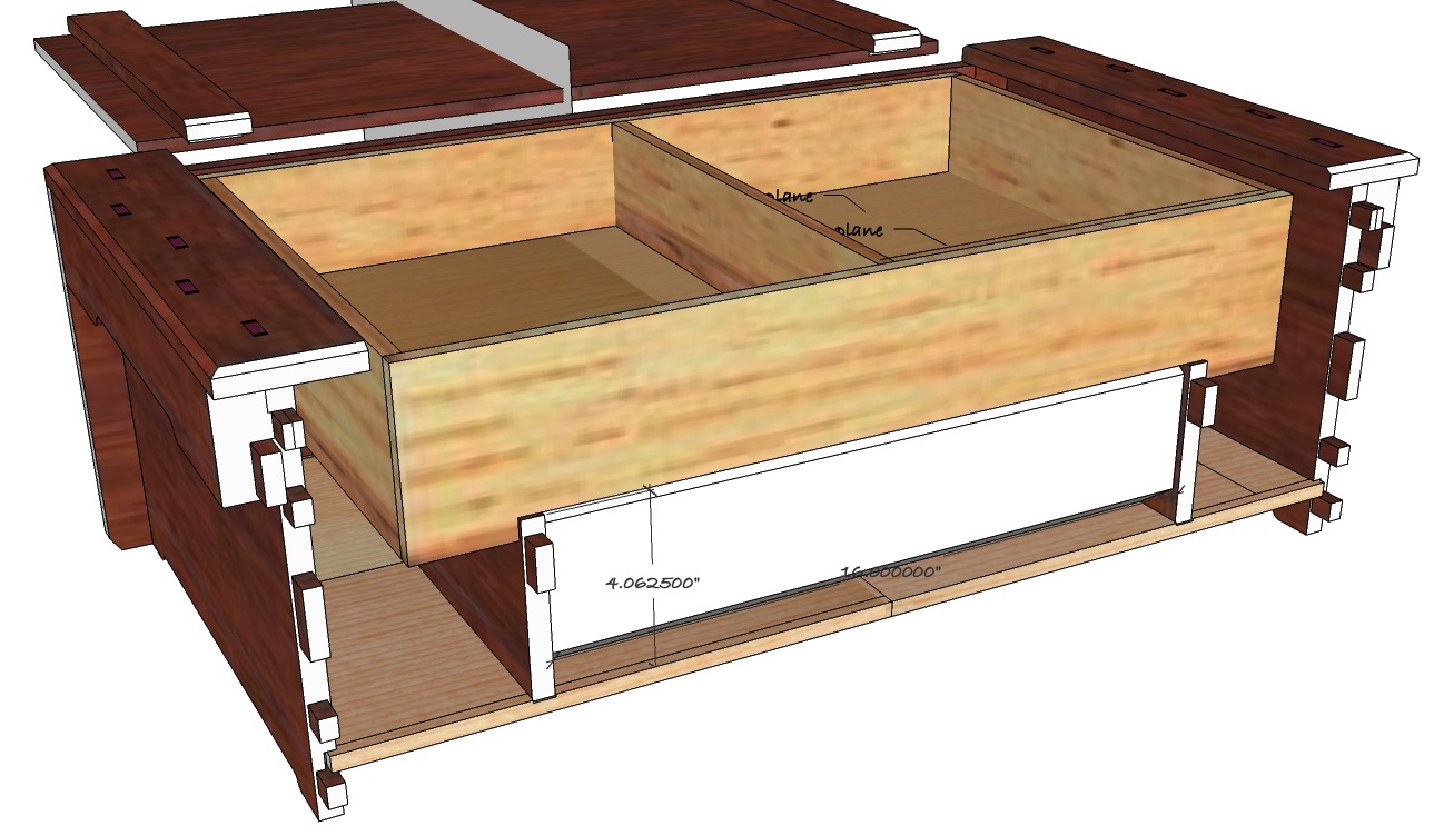

Exploring various ideas - this one has two nesting trays for chisels:
道具箱 dual tray.jpg (197.11 KiB) Viewed 15094 times
Another possibility would be to split the upper tray into two separate trays which fit side by side and nest into the lower tray - a total of three trays.
I've got to measure the chisels to see how deep the drawer needs to be. The timber chisels might need about 1.25", while the bench chisels perhaps 1~1.125". I'll check next time I'm at the shop. Splitting the trays means a bit more work to make them, but it is nice to keep the chisels separated from one another and easy to select. Just so long as they can't fall out anywhere and get damaged/do some damage.

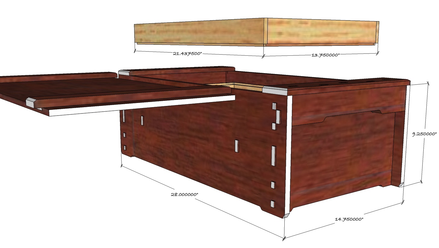

And just to give y'all an idea as to the dimensions of my box at this juncture:
道具箱 overall sizes.jpg (150.24 KiB) Viewed 15093 times
Depending upon the tray details, the height could increase a bit more, but probably ending up no taller than 10" for the sides. Multiply all dimensions by 25.4 to obtain millimeter equivalents.
