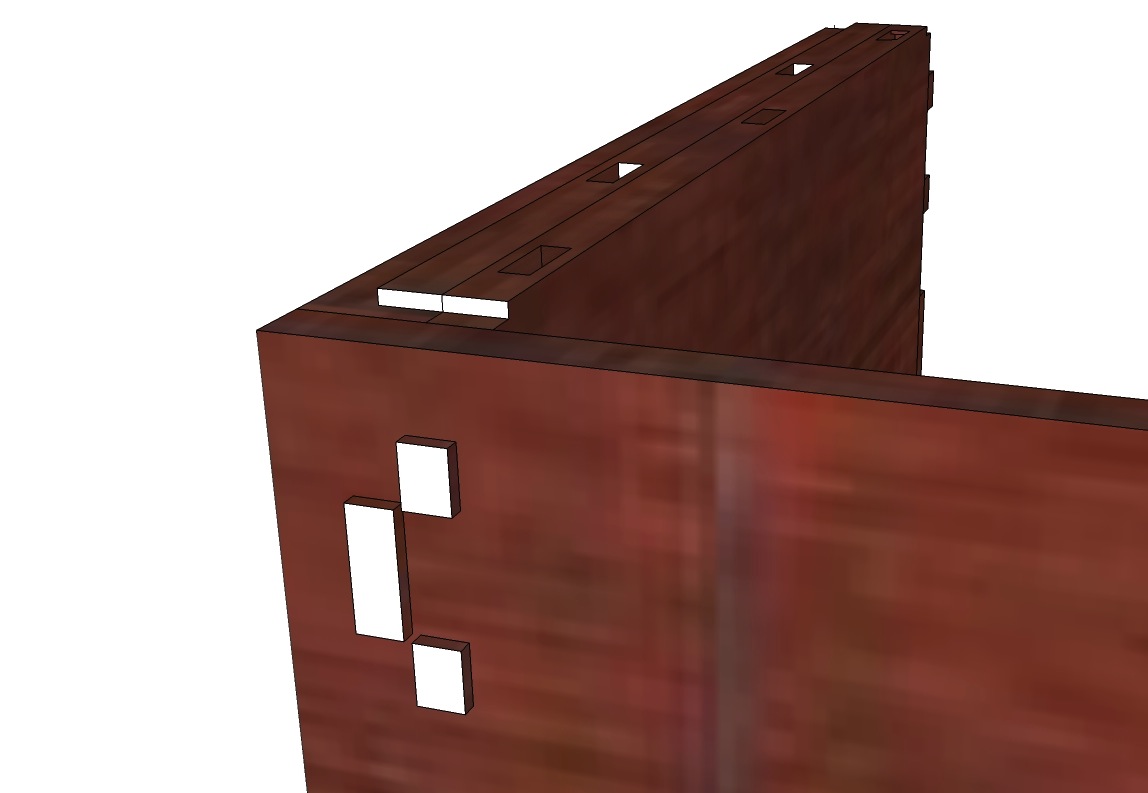

Ah, yes, I see. The 1/8" (3mm) difference is important - the end boards are that much taller than the side boards. The end boards will eventually have a portion which form part of a tongue (the other portion being on the top face of the handle). For now, we lay out and cut all the joinery with the side boards being 1/8" taller than they are to finish. Once the joinery is complete, we trim 1/8" off the side boards, along with a small portion at each end of the end boards, which will leave that 1/8" portion of the end boards proud.
Here's a drawing for any additional clarification which it may provide:

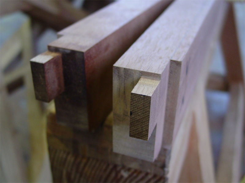

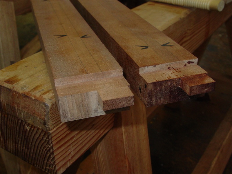

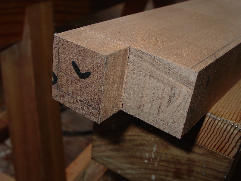

For no special reason, today I decided to process the tenons on the end of the handles. I could just as easily have worked on the end board tenons, but, what the heck?

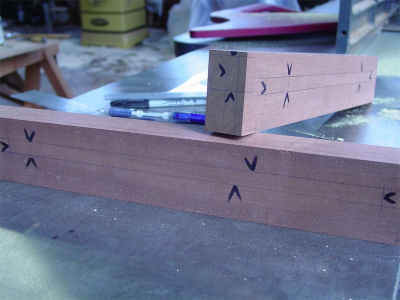

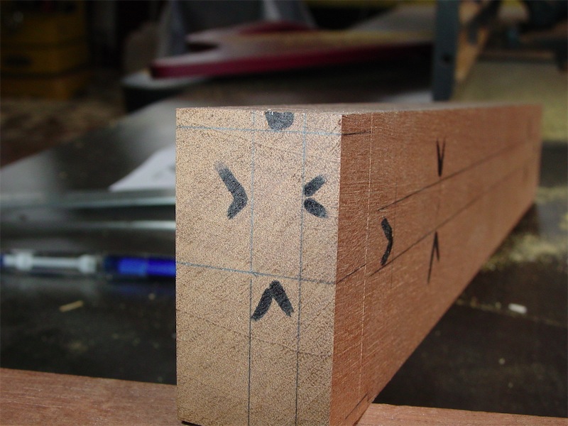

The handles were already cut to dimension (identical to the end boards), so I used the kama kebiki, which I had left at the same setting as it had been when marking out the end board tenons, to mark a line out around the ends of the handle:

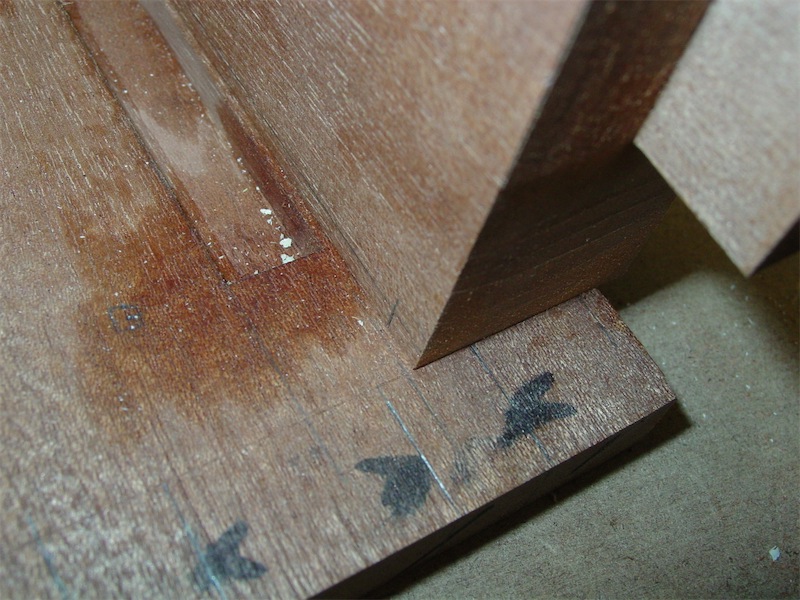

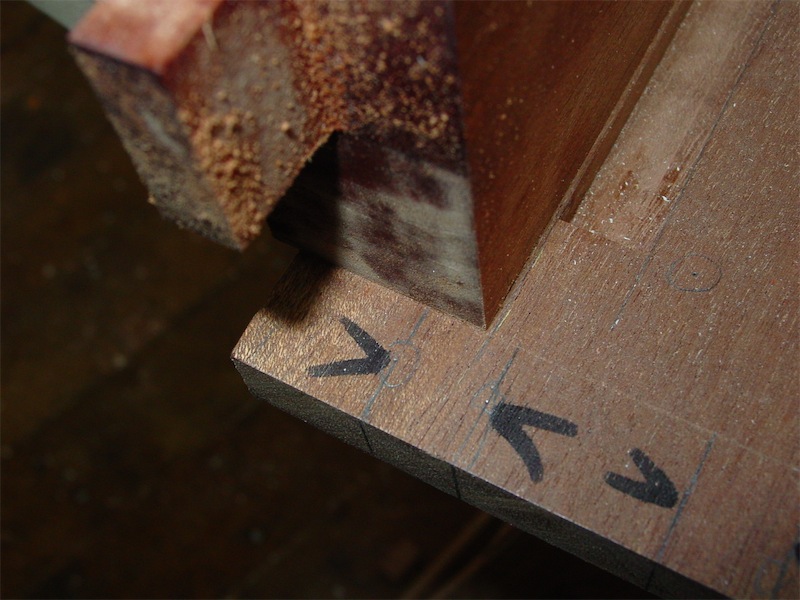

If you hadn't cut the handle and end boards to length simultaneously, or had not kept the kama kebiki set, then you can compare your knifed marks for width on the handle with the ones on the end boards:
Then I used combo square and 0.5mm pencil to mark out the tenons, which are 0.375" x 1.0" (@ 9.5mm x 25mm) along with the top and inside face tongues:
The board in the above picture is oriented so that its bottom face is uppermost.

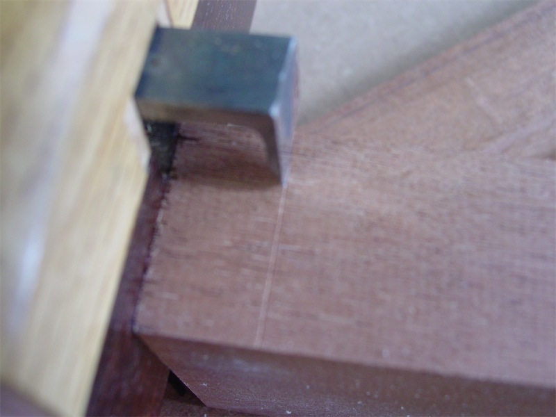

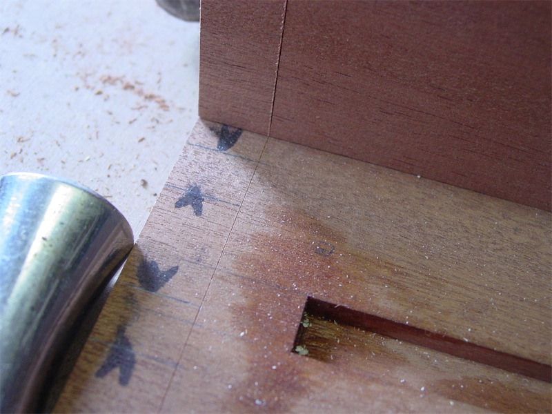

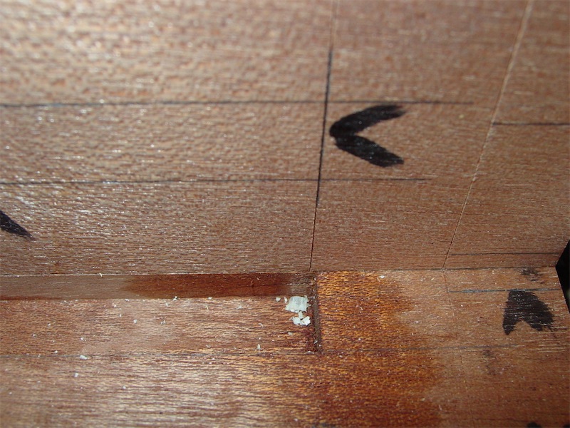

Another check to make sure that the inside face tongue laid out corresponds to the groove already cut on the outside face of the end board:
The tongue is slightly shorter, which is fine. The critical fit aspect to the tongue and groove is the tongue's width, and making sure the groove is a hair deeper than the tongue.

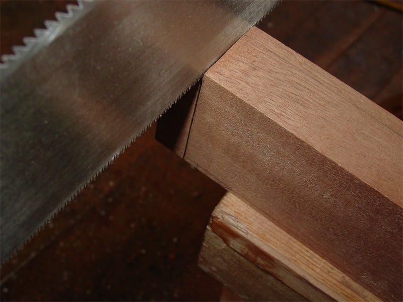

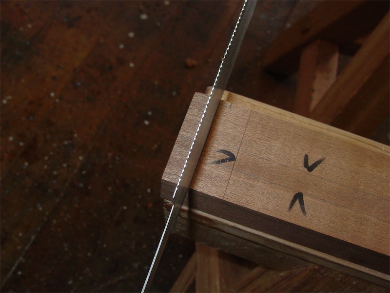

One way to process the cuts on the tenon is with a handsaw - I start by cutting the shoulders first, broad face first:
Then the bottom edge:

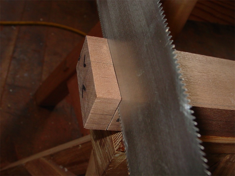

The next face:
And final face:

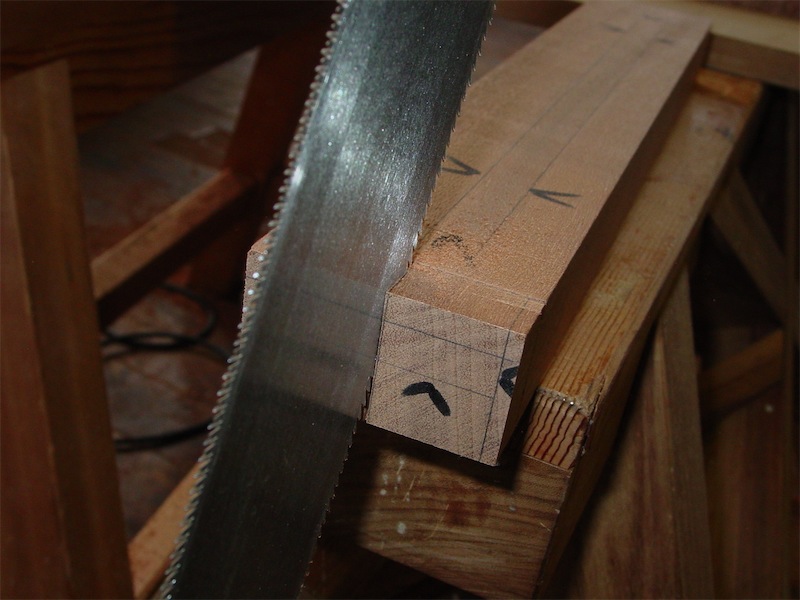

Then the ripping can begin:

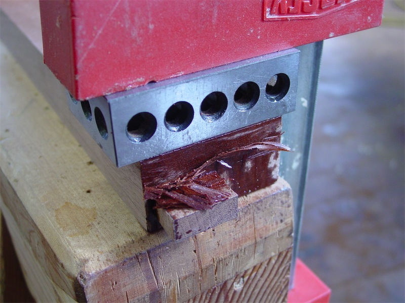

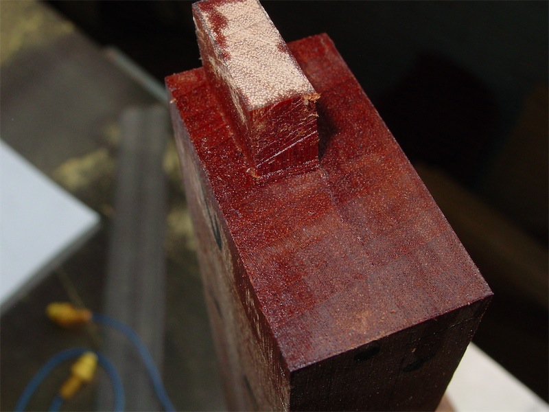

Now, the ripping is more often done so that you would remove the waste from the long sides first, then pare the exposed end grain square to the face, and then use a corner cutting-plane to trim the side of the tenon cheek square and to the required depth. I feel fairly confident with my hand rip cuts, so I just went and removed all the waste to leave the roughed out tenon. Then I pared the exposed end grain clean:
A little more trimming and the tenon is defined, with a little clean up of the tenon cheeks still required:

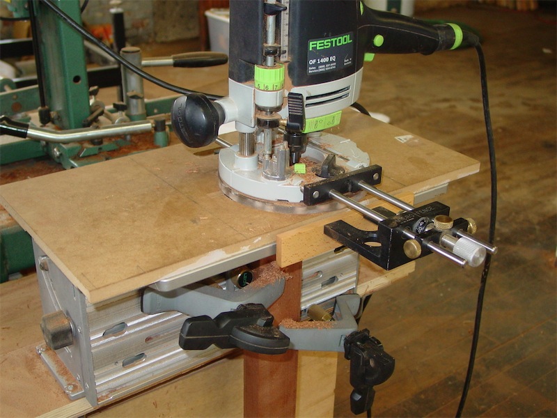

Now, with smaller piece of wood like this I usually do not saw and pare my way there - I use the router in a jig where I can cut directly onto the end grain to form the tenon, a configuration in which the router excels:
The cut out proceeds in stages, and when the tenons are done, I check the handle's end against the end board to make sure they are exactly the same dimension. Here's one side:
And here's the other:
Tenons complete, sawn one on the right, routed one on the left, plus a few more cutting steps along the way:
Another view:
I have yet to process the cuts to define the tongue on the inside face and top face of the handle. Then there will be the template-profiling work. I'll leave that until next time.

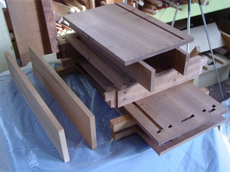

Here's where my pile of boards is, stage-wise:

That sort of mortising jig is easy to make from MDF - I've built lots of them. The one in the photo is a Leigh FMT, which I use in an unorthodox manner since it is infrequent that i cut a standard-size, centered tenon. I'm thinking of building a larger one from aircraft aluminum.

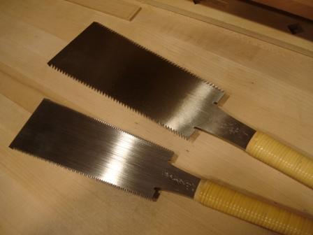

The saws that I got are the re-sharpenable saws. I have photos which I will post but they will have to be re-sized and done on my laptop.

Here are photos of the saws. I think they came from Hida several years ago.
