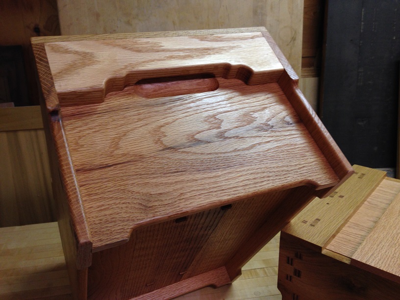

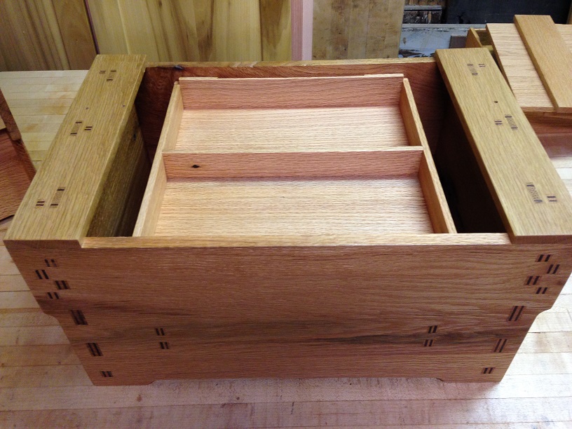

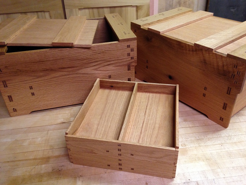

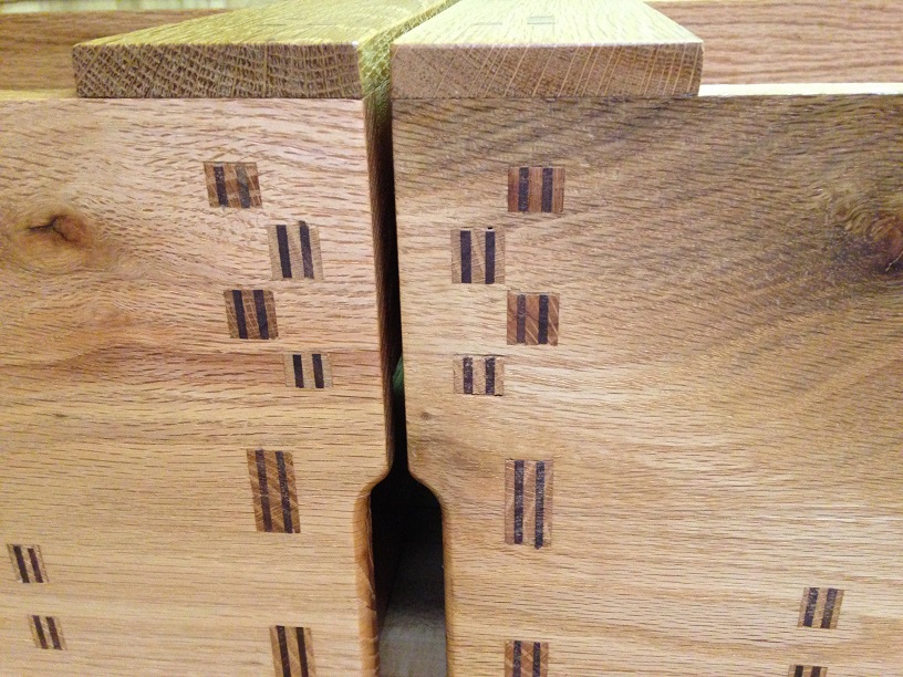

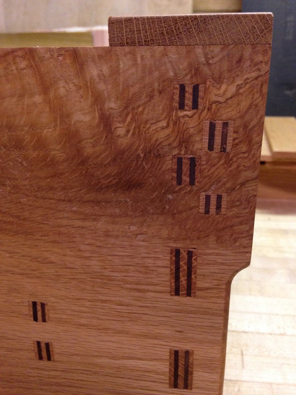

That is one very nice finish!!! I had already used the tung oil though which I may regret. Here is the finished box.
- finished 4.jpg (185.67 KiB) Viewed 22782 times
- finished 3.jpg (237 KiB) Viewed 22782 times
- finished 2.jpg (168.67 KiB) Viewed 22782 times
- finished 1.jpg (188.67 KiB) Viewed 22782 times
- End view with handles.
- finished 5.jpg (168 KiB) Viewed 22782 times
Re: Makin' Trays
I think that came out very well - appreciate the honesty of the close-up pictures.
