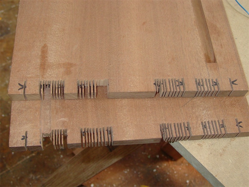

First I used the bandsaw to kerf the waste:
You could of course use a handsaw for the same thing.
Then I removed most of the waste, also using a bandsaw (you could use a coping saw or chisel):

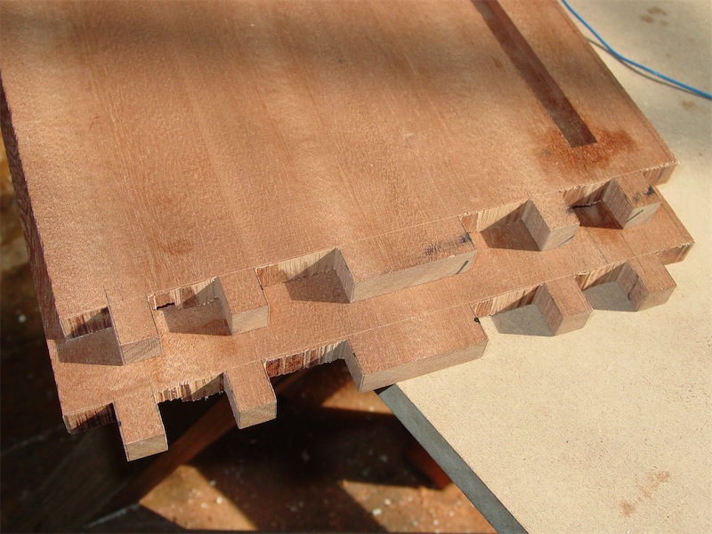

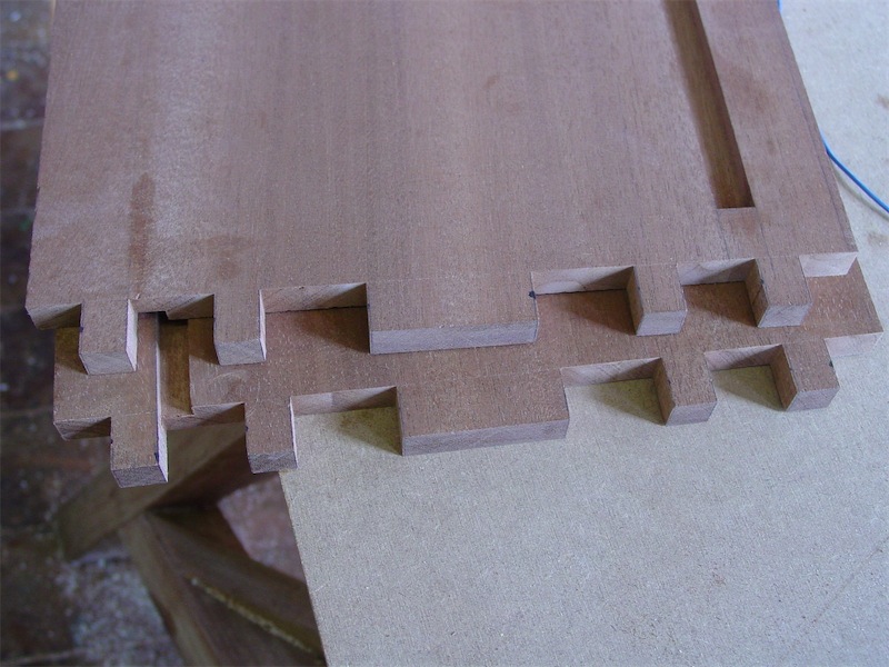

From here it is a matter of using a paring guide and a sharp chisel to trim the end grain clean, however I elected to use a router and cut the end grain directly using a bottom bearing bit. The result:

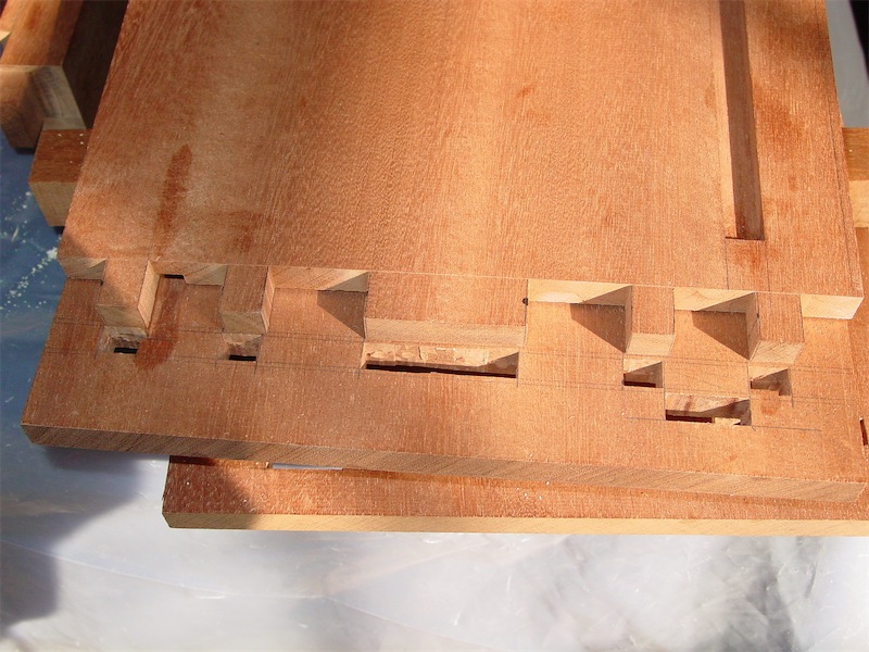

Here I've placed the tenoned end board atop the mortised side board. The mortises have not been trimmed clean yet, nor have the tenons been trimmed to a precise height nor have they been diminished by 1/16" each face to target thickness of 0.375" Things are at an intermediate stage.
I will do that tenon width dimensioning work on the router table sometime next week.

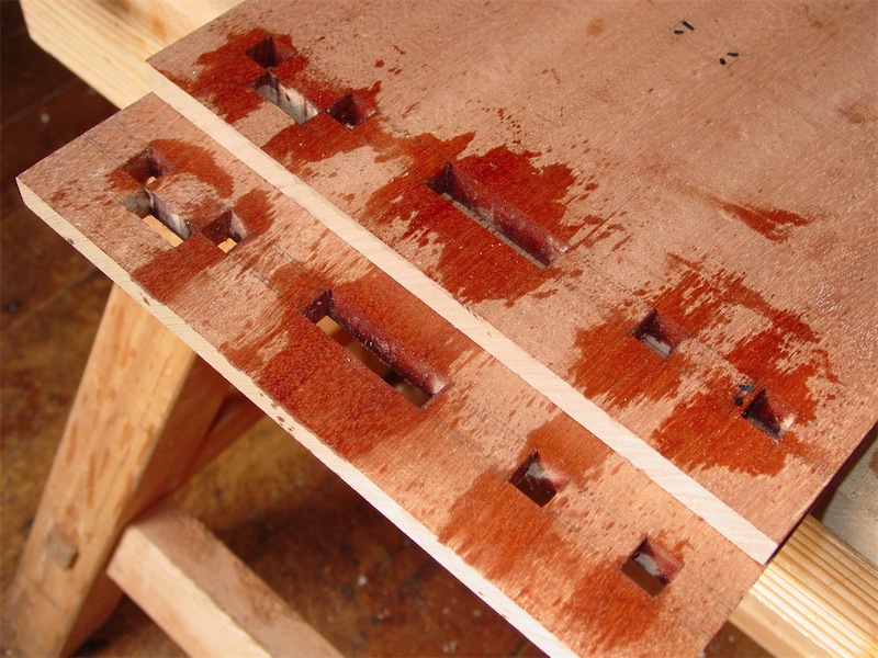

Next up was to shape the mortises on the long side boards for the wedged tenons. The boards are 0.5" thick, and the wedge will be 0.0625" (1/16", about 1mm) thick, one on each side of the tenon.
So, the flare is 1/16" over a distance of 1/2"

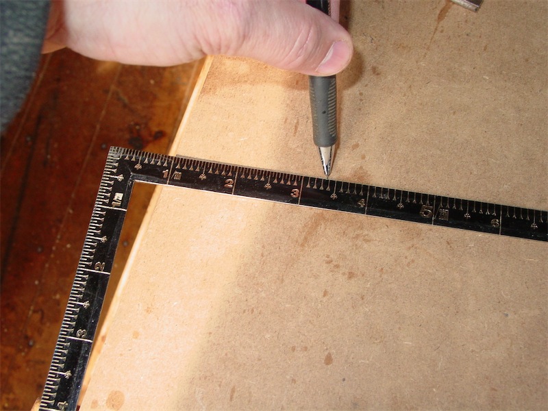

There are sixteen 16ths to an inch, so if I multiply the 1/16" by 16, and the 1/2" by 16, I will end up with a slope of 1:8

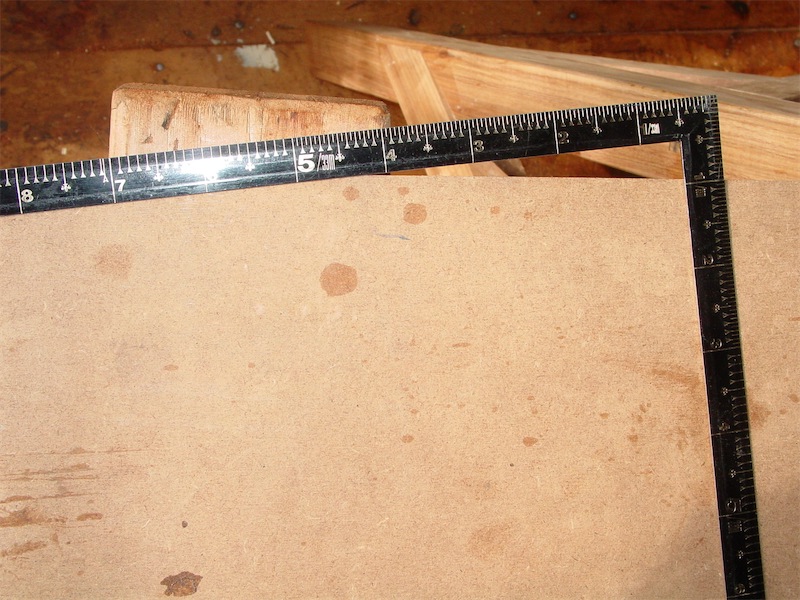

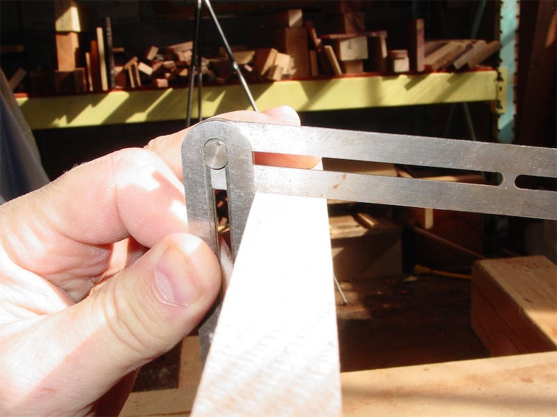

I then lay that slope out with the sashigane, 1 on the short arm and 8 on the long arm, on a piece of clean and flat scrap material (the transfer board):
If you are using a metric sashigane, I would suggest doubling those numbers, 2 on the short arm and 16 on the long arm.
I mark along the short arm of the square:

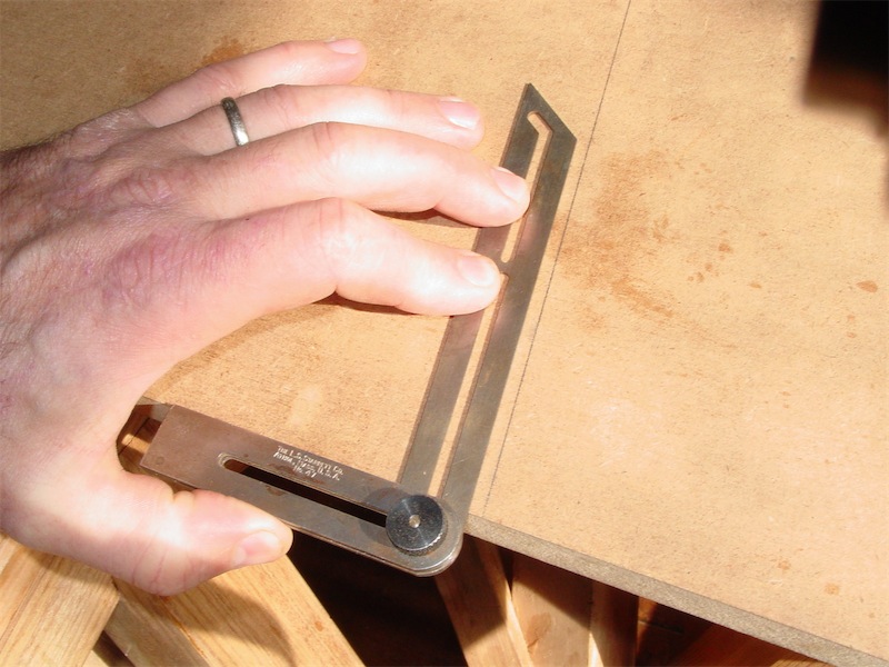

Then I set a sliding bevel gauge to the line just drawn on the transfer board:
I then used the bevel gauge to set the blade angle on the tablesaw, and then ripped a board cross-grain. I'll be setting up a paring jig, and I prefer the jig be durable so it is best to make the paring surface the end grain of the board rather than the side grain. If you lack a tablesaw, then plane the edge of the board until it is at the desired angle. When done, check to make sure you have the exact angle with your bevel gauge:

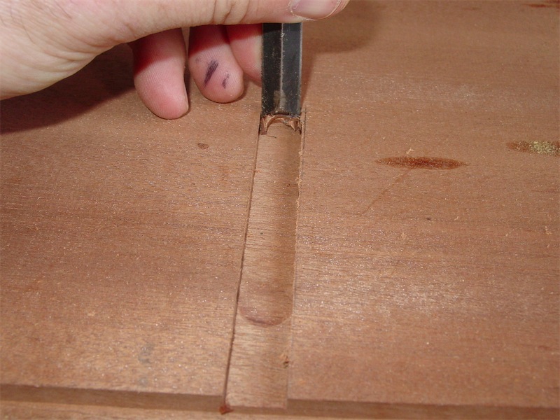

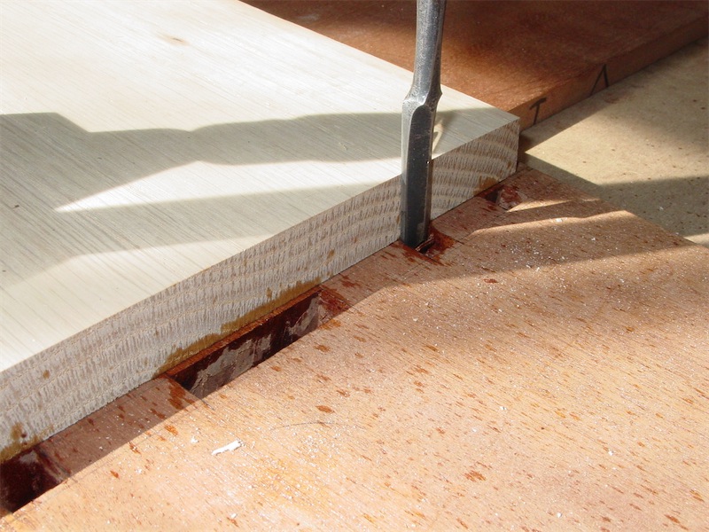

Once the paring jig is ready, I clamp the long side boards down and position and clamp the jig to the board. Be very careful to make sure that you have the outside face of the board up. You really don't want to cut the flared mortises the wrong direction!!

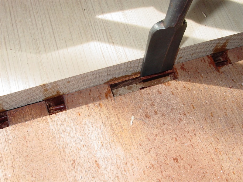

I go just a hair towards the inside of my marked line, making the mortise just a fraction tight. Our come the (freshly sharpened) chisels, and I process the cuts:
Remember that you will not be paring the mortises for the handle, as they are not flared mortises.
When all the chisel work is done, the flared mortises are complete, save for a final paring at fitment:
It's a good idea to mark your paring jig '1:8' so you know what angle it is for any future use that might occur. It's easy to forget later on what the jig was specifically used for.

Looks like your sashigane is set at 1:4.

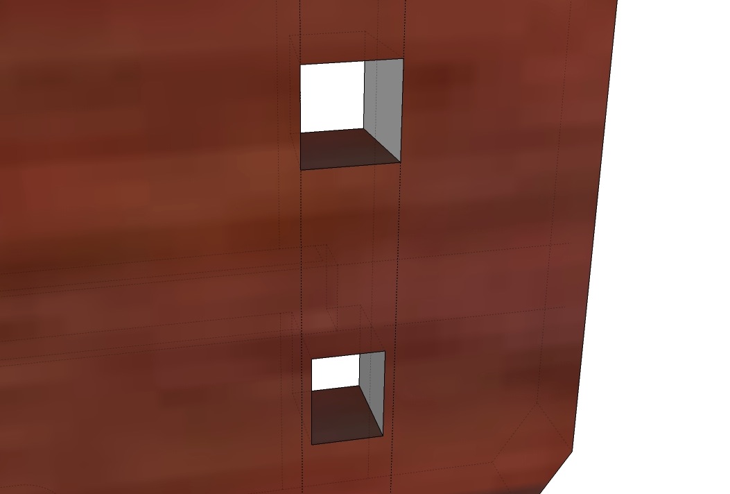

Can you show in the model how the flared mortices work? and the wedges?
Maybe a cross section through one?

look at the sashigane again - when setting a slope, the measures are taken along the outside edge of the square, not the inside:
I could have chosen a better camera angle. The line at '8' on the long arm of the square, to the left, meets the edge of the mdf.

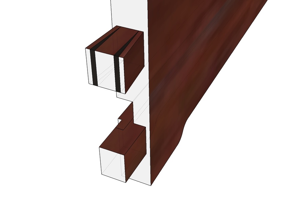

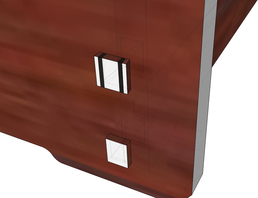

As for pictures of a wedged tenon, ask and ye shall receive. I modified the drawing to show one wedged tenon, so it can be compared with an un-wedged one below:
道具箱 wedged tenon 2.jpg (51.21 KiB) Viewed 154242 times
All 5 tenons will be wedged, however I am only illustrating one tenon as wedged at this point.
The mortises compared:
道具箱 wedged tenon 3.jpg (54.36 KiB) Viewed 154242 times
Assembled:
道具箱 wedged tenon.jpg (80.02 KiB) Viewed 154242 times
With wedging, the mortise and tenon finishes out as a square in appearance, 0.5" x 0.5", on the face of the long board. These wedged tenons will be trimmed flush once the assembly is done.
Did that make things clearer?

Thanks. Now the sashigane looks like 1/2:4 on the inside. Thanks for clarifying.

Tue Feb 21, 2012 10:42 pm
The tenons seem to be wedged on their long faces, rather than their short faces, as I had assumed.
The problem with doing it that way is two-fold:
- the pressure of the tenons being wedged outward would tend to crush the side grain in the long board mortises. This may result in a joint that is not especially tight, especially after a few seasonal moisture cycles
- the pressure of the tenons being wedged outward could possibly induce a split in the long board mortises
So, we wedge the tenons so that they press against the end grain inside the mortises. In joinery design, a general rule is to try an bear against end grain where possible with pegs and wedges, and even in certain types of connections such a scarf joints and those joints in trusses.

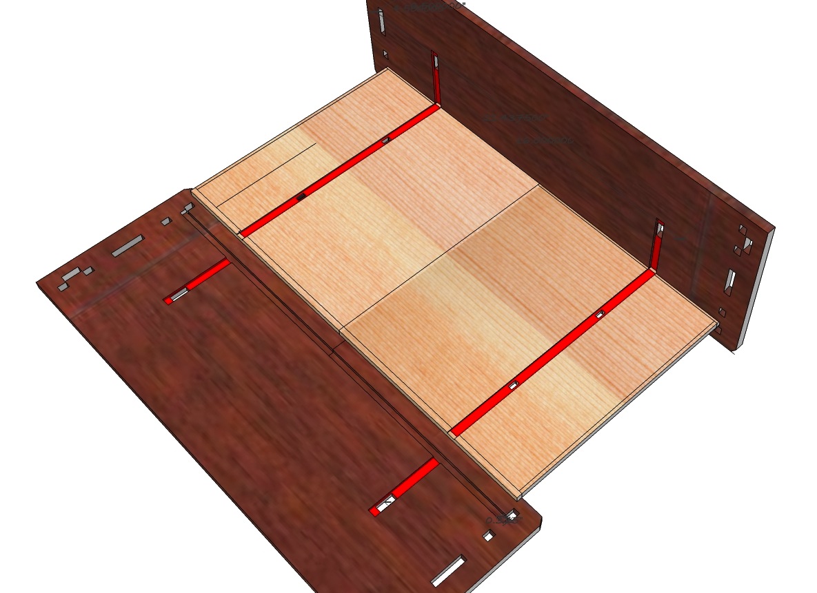

Next step in the work was to deal with the dadoes in the floor and long side walls of the box which receive the main partitions, shown in red in the following sketch:
道具箱 floor dadoes.jpg (182.81 KiB) Viewed 154223 times
The dado in the floor panel is quite shallow at only 0.0625" deep, (about 1mm) while the dado in the long side panels is 0.125" deep (about 3mm).
First I'll show some pictures of how I went about the cutout, and then I'll give some suggestions for alternative approaches.

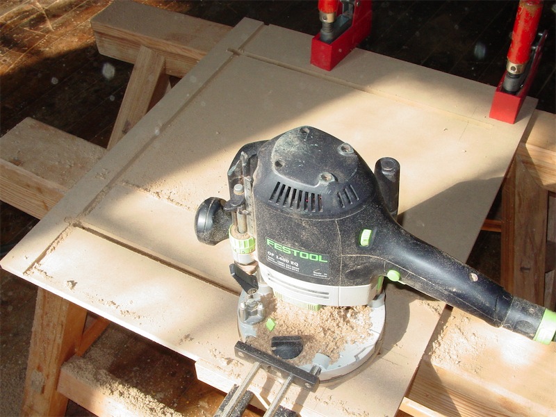

I did the dado processing with a router and a shop-made guide jig because I think it gives the most accurate result with the least fussing about.

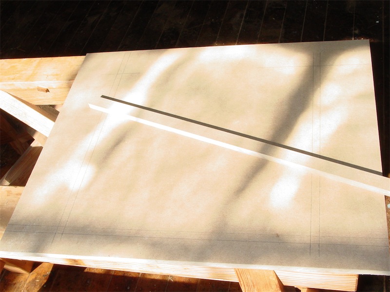

First, I bought a 2'x4' piece of MDF for about $9.00, which I then sliced into a couple of pieces for this jig:
The skinny piece will become a fence for the jig. A used the table saw to slice the main piece so that the edges were parallel to one another and were clean surfaces. I don't trust the factory to make the edges clean and parallel.
The important thing about these dadoes is that they be exactly the same spacing apart from one another on all three boards. If the pair of dadoes is offset to one end of the box or another some slight amount, it is less critical. If just one dado on one board is spaced differently apart than the others, you will have a spoiled fit, and troublesome indeed is the repair.
So I made a jig which would allow me to automatically form the dadoes the same spacing apart on all three boards.

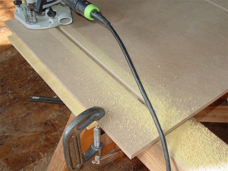

Then I used my mid-size router with an edge guide and 0.5" spiral shank carbide bit to mill a slot on each end of the board, taking a couple of passes to penetrate all the way through:
You can also see that cross-wise to the slots, I cut a dado across the board for the fence.

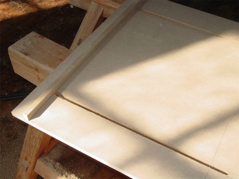

Here's the assembled jig, ready to go:

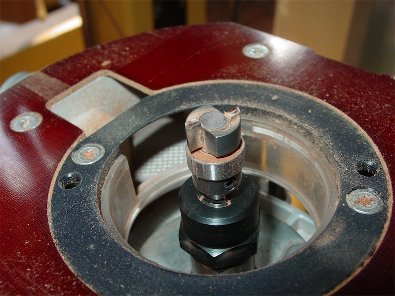

Here's the bottom bearing router bit I will use for the cutting of the dado in the floor panel:
For this cut out, I use my small Festool router. A trim router would also be fine.
I clamp the jig to the floorboard, making sure that the floorboard, which is longer then the jig is wide, protrudes an even amount at each end, and then I execute the 1/16" deep pass to make the dado:

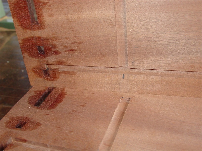

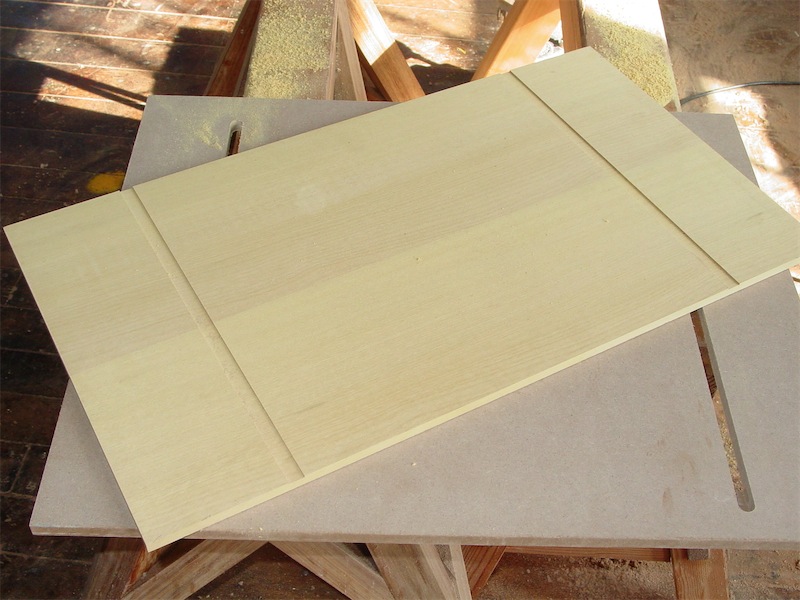

The completed floor panel dadoes:

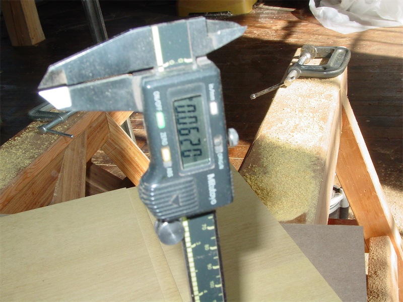

A check to confirm that I hit the target depth:
I'm not planning to plane the interior side of the floor panel, so I went to target depth.

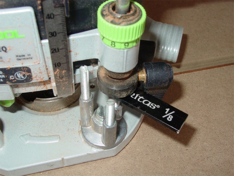

Then I reapply the same jig to the side boards. First though, I reset my router for the target depth of 0.125":
For the side boards, placed them together and made sure their ends were flush to one another and then cut the stopped dadoes on each board.
When the routing was done, I used a couple of chisels to clean up the ends of the dado:
The completed dadoes in the side boards:
