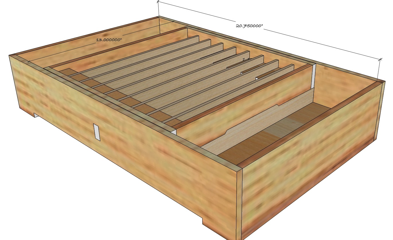

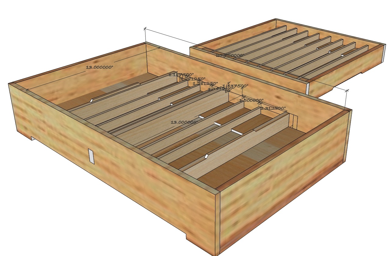

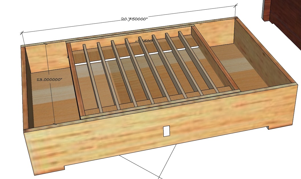

I bit more sketching and I have come to a different arrangement. I've centered the chisels in the tray, and the lower tray has a central partition which ties the tray long sids together and provides a handle. I'm toying with the idea of fitting a metal handle to that thickened partition that can be pulled up...
This configuration would make the whole works more balanced, and would provide room on each side of the tray for a couple more planes. Possibly I can sandwich a pair of hammers, one for planes and one for hitting the bench chisels, in between the two trays..
This part remains in flux - what do y'all think at this point? Have I gone seriously astray?

Schuyler,
yes, the box is indeed complex enough, however the interior bits, trays, etc., are totally up to the maker. I won't be covering the making of those parts in detail as they are completely idiosyncratic, so there's no 'overcomplication' effectively happening, at least from my perspective. That said, in order to accurately size the box however, you need to decide what you are putting in the box and, decide how you will arrange it. You don't want wasted space nor do you want the box to not allow you to store what you need. If you were to skip this step, 'complex' as it may appear, you may end up with a box that does not suit what you have to put inside. Imagine if the box was 1/4" too narrow for your chisels...
At this point, things are in the design phase and it is good, I think, to be open minded to various possibilities.

In the case of my box, If I arrange to lift one end of the tray (with a finger hole), tilt, slide it over towards the other end, then pull it out, the angle of tilt would be around 17 degrees. Depending on how the chisels are held, I don't think that is enough to cause chisels to roll loose. A modified arrangement would have to be made to the tray supports to allow it to slide. Not the most elegant solution, but workable.
