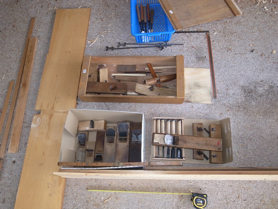

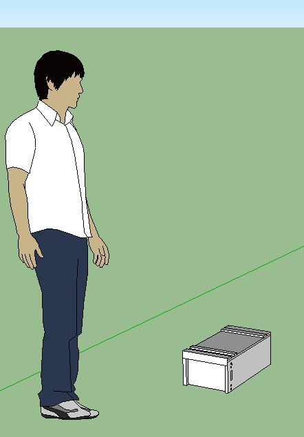

I've been trying to work out the scale of my box, I more familiar with the metric system, so didn't realize your tool box is quite big.
I've already got one that's long and narrow, so I want to make a shorter deeper one. I'm planning to store planes on the bottom, and leave enough room for internal tray which I may or may not build. the dimensions are about 11 inches wide (2 planes are that length, maybe a standard?) 18 long and about 7.5 high. looks like this next to the sketchup guy, and holds planes like inside the cardboard box:
- RIMG0490.JPG (206.87 KiB) Viewed 24482 times
- scale.JPG (28.63 KiB) Viewed 24482 times

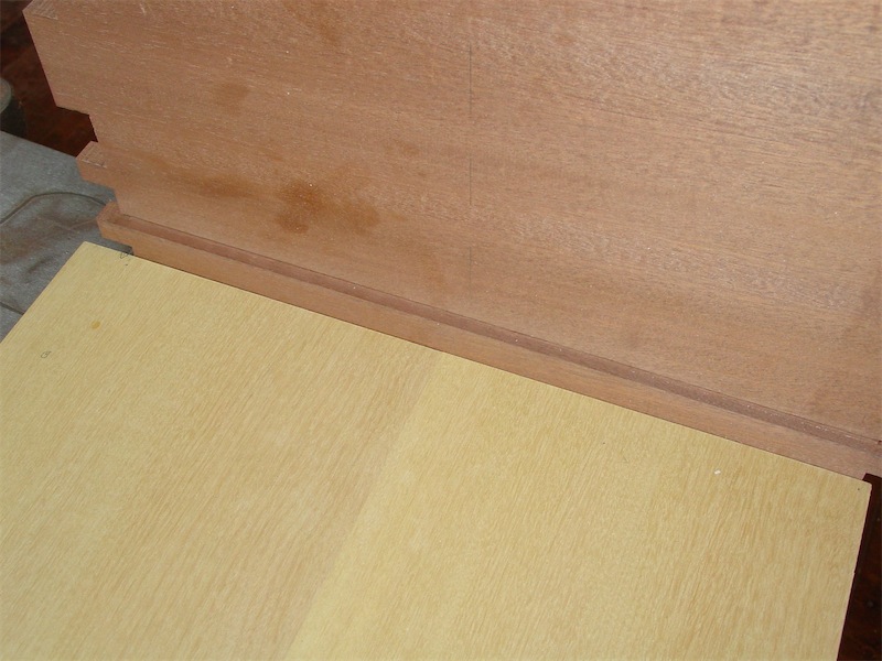

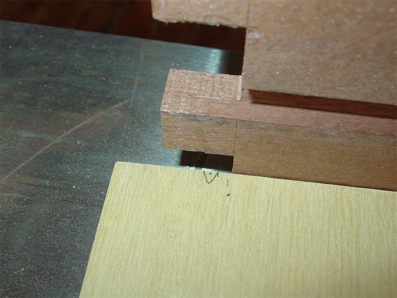

Another small step along with the floor panel today. I mark out the width of the panel using the end boards as a checking gauge. The width of the floor boar is equal to the inside narrow dimension of the toolbox plus the amount of tongue on each side of the floor panel. in this case, since my floor panel is vertical grain, i don't expect a whole lot of movement, so with a 1/4" (6.35mm) dado on the long sides of the box, I allow for a tongue which is 3/16" long (about 5mm). The inside of my box measures 13.75"; add 0.1875" to each side makes for a floor board which is 14.125" wide. Not only do I establish this mathematically, but I check the result against the end board's floor panel dado to make sure everything makes sense:
A closer look:
The little triangle on the floorboard marks the place to cut.
You can see I have about 7/8" of wood to remove off the edge of the board. This I did on the table saw (not shown). With a hand saw, you would mark the entire cut line and then rip the board just fat of the line and dress it to the line with a plane.
A closer look:

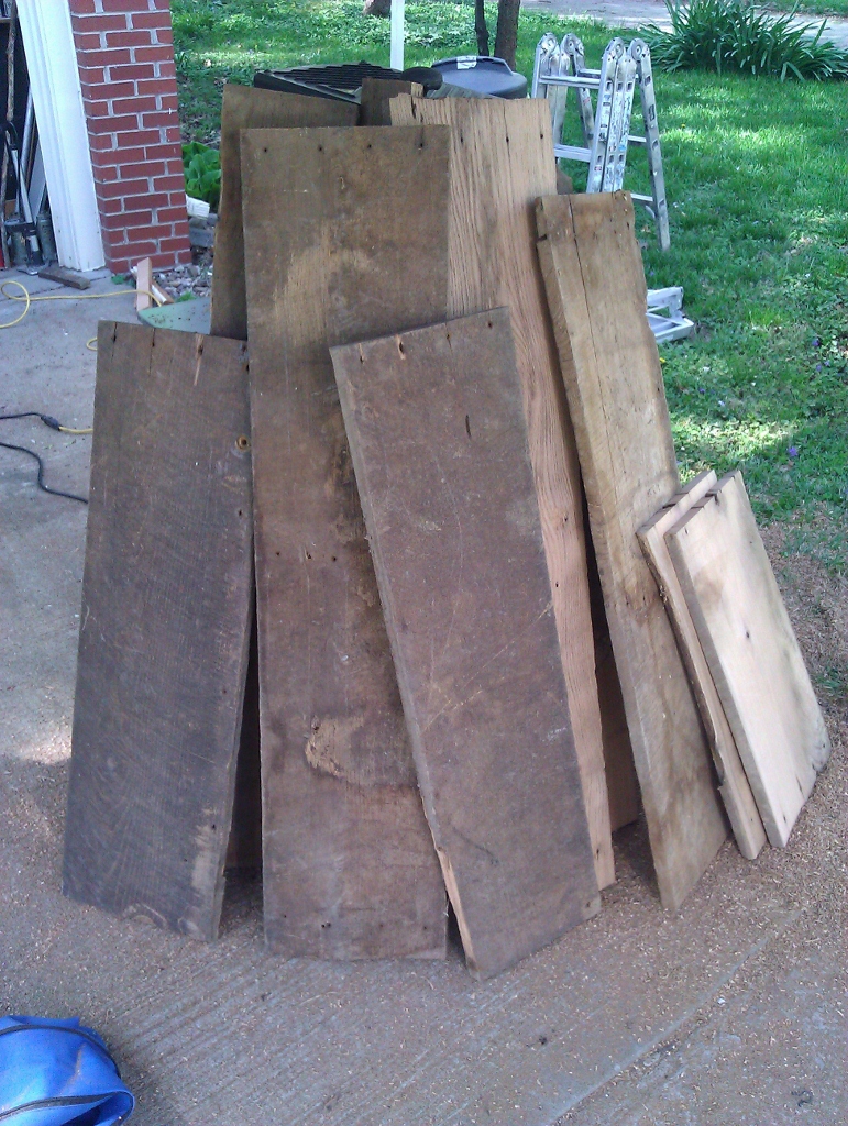

While you are approaching the "finish", I am finally able to approach the beginning. I am using oak salvaged from a horse stable that was being demolished. Normally I don't care to use oak as during milling it tends to smell like sour cow manure, but it can look very nice and is durable. I am going for a "sophisticated rustic" look but will not be surprised if that turns into a dismall failure.
- forum pic.jpg (970.76 KiB) Viewed 24420 times
