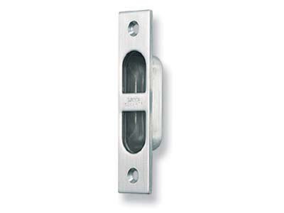

I've been doing some searching to see what sort of handles i can find, and looking for pocket door edge pulls has lead to a few possibilities.
This one is stainless and costs $6.00:
Find it at: http://www.knobsandhardware.com/pocket- ... 97062.html
Another one:
This one, which I kinda like, is only 0.75" wide and is solid brass:
It does require 1.62" depth, so no sure if that will work for my design.
It's available in a bunch of other finishes too, from brushed nickel to chrome, to polished brass. Available from:
http://www.handlesets.com/baldwin-0465- ... =615061243

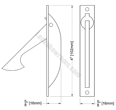

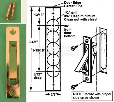

This one is a bit smaller, and only 3.5" long and only requires 0.75" depth - and it is spring-loaded:
Pocket Door Edge pull with install instruc.jpg (78.25 KiB) Viewed 25417 times
Available here: http://www.homebuildershardware.com/Poc ... -Pull.html

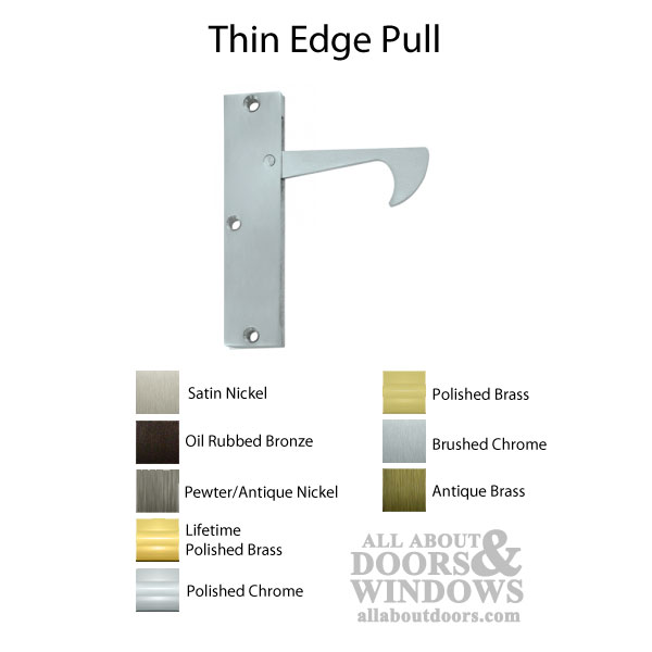

Then there's this one which is a lot skinnier:
Available here: http://www.allaboutdoors.com/product_in ... _id=368063

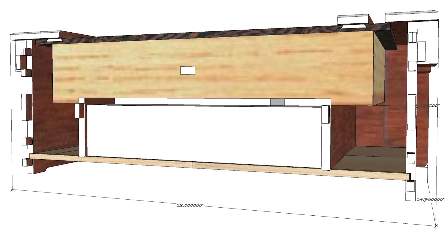

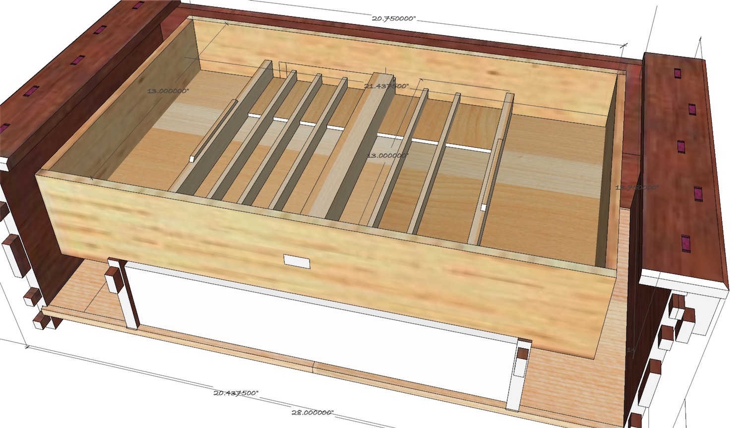

More slight revision to the design of the removable tray. I thickened up the central piece in the lower chisel rack so as to allow for a metal pull handle to be fitted. I also reconfigured the through tenon of that central piece so that it is horizontal rather than vertical:
道具箱 tray final 1a.jpg (292.32 KiB) Viewed 25403 times
That central batten is rebated at each end so that the tray above keys onto it and the top surface of the batten bears directly against the floor of the upper tray.
The upper tray nests on top, so to remove the entire tray, I pull out the small chisel tray first, then the main tray pull handle can be accessed. There is room on either side of the main tray for a 70 mm smoother, or a pair of smaller planes:
道具箱 tray final 2a.jpg (306.96 KiB) Viewed 25403 times
I should be able to carry 4~6 planes in the box and three rolls' worth of chisels.
I also moved the dovetail battens outward by 0.125" (3mm) each side, and made the caps 0.125" narrower, taking them to 2.625" wide:
道具箱 tray final 3a.jpg (141.73 KiB) Viewed 25403 times
The detail changes to the end caps, lid and battens gives the lid more purchase at the cap underside when the lid is closed, and makes the caps better at resisting a twisting load. Further, the narrowed caps give a 1/4" more room lengthwise for pulling the tray out. You can see in the drawing how the lid rests atop the tray, which makes the top of the box much more resistant to having weight put on it, and the lid in turn keeps the tray contents from wandering. I think the design is pretty much there as far as my tool box is concerned. I may do a few further tweaks to see is I can fit a couple of hammers to the box, but that's about it.

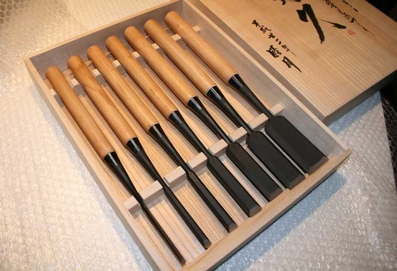

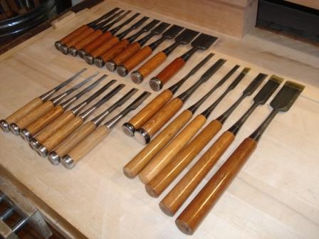

I don't have all Japanese tools but I do have a start. I am going to build the main box close to the way you have it laid out as that will suit material I have, tools I have or am going to acquire, and the joinery laid out. Here are some of the tools that I will store in the box.
For the present the chisels shown at upper left are a set and will be stored in the box in which they came.
The group at the lower left (assorted bench/dovetail chisels) and right (long paring chisels) will be stored in rolls.
I have basswood from which I will build the box. It will live in my workshop as I have no plans to transport it to a job site.
As my time permits for this project, I may develop trays for these items but I will make provisions for internal trays long term.
I plan to work up a drawing with some dimension changes from the suggested design.
Regards,
Thu Feb 09, 2012 6:30 pm
You're not exactly looking bereft of chisels there Jack! The basswood will be a very nice wood to work. I might get some too for the floor of my box, as I want something light in color. I'll see what they have a the local hardwood dealer tomorrow. I think building a tool box to accommodate an existing chisel tray is a good idea.

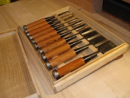

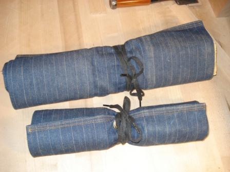

I like the idea of keeping the chisels in a roll to minimize movement, but this can make for a more bulky arrangement in the box. I like the clean look of the separated spaces for the chisels as well, but what do you all think about the chisels bouncing around during transport? I think I would cringe whenever I hit a pothole.
The "hold downs" in this chisel box seems a little more secure, but I'm sure even this would allow for more movement than we would like.
Any other ideas or opinions on this?
toolbox double trays.tiff
toolbox double trays.tiff (325.12 KiB) Viewed 25370 times
Sun Feb 12, 2012 9:54 pm
You sure don't want those nice Kiyohisa slicks hitting against each other but as longs that doesn't happen a little bit of movement is not going to matter much I suppose. You could come up with a solution of securing the chisels from any movement at all by locking them into place, but that would just mean another manoeuvre to get to the tool when you need it.
Sun Feb 12, 2012 10:26 pm
Or you could line the lid with thick felt or something similar so that when the lid was closed the chisels have nowhere to move...
http://www.carrycasesplus.com/custom-fo ... -c173.html
Perhaps foam inserts cut to the shape of each chisel/ tool being held in the tray .
In regards to the metal pull handle in the center of the tray ... a few things came to mind .
1) the tray will not be balanced as the weight of the tools in the tray will vary, picking up a tray weighted by tools by a single center pull may be inviting trouble.... this of course is completely untested and something that just came to mind when seeing this ... may be a perfectly viable solution .
2) Another concern I see with the metal pull in the center of the tray or being used in the tray at all is the possibility of sharpened tools edge making contact with the metal pull and causing damage to the edge which would mean more time resharpening a nicked edge..... also since this box uses no metal fasteners I feel that the metal pulls goes against the spirit of the design of this box with all it's intricate joinery .... since most of the details of the tool box have been well laid out ,I will put some more thought into the tray and it's removal ....
without the use of metal pulls .
