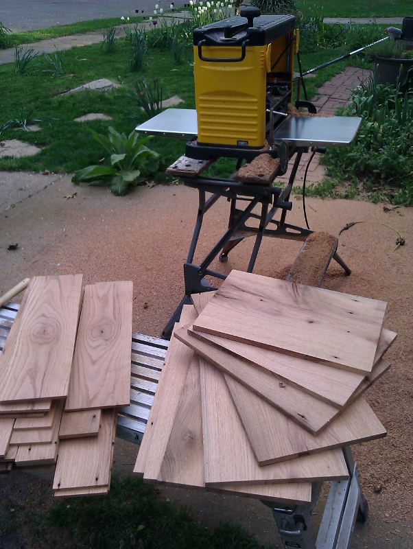

Re: Preliminaries - Milling
The material planed. The sides and ends are 9/16" and the material for the bottoms and the interior trays and dividers are 5/16". There was less waste than expected. I think the oak is going to look fine.
- 009 (602x800).jpg (781.05 KiB) Viewed 23936 times
Is that the Dewalt 12.5" shoebox? That's a great little planer.
Good to see things underway - nice work!
Originally I wanted the Makita, but this has been a great planer. I have put miles of wood through it and it has been a money maker. I found a nail in this stack of wood. I thought I was so careful. I have 3 sets of knives so there's no down time. I just completed a planer knife sharpening jig modeled after one I found on the internet. I will have to give credit to the guy when I refind the site.

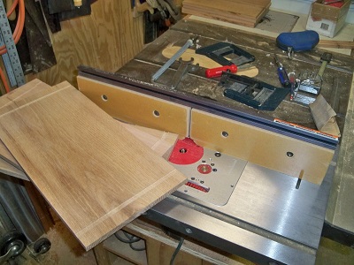

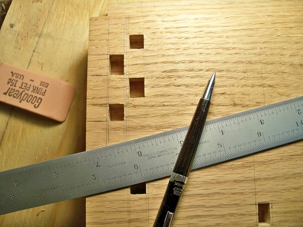

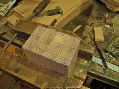

Here I have started milling the ends, sides, and handles.
- test 05.jpg (177.04 KiB) Viewed 23898 times
- test 04.jpg (182.92 KiB) Viewed 23898 times
- test 03.jpg (143.02 KiB) Viewed 23898 times
- test 02.jpg (182.93 KiB) Viewed 23898 times
- test 01.jpg (176.33 KiB) Viewed 23898 times

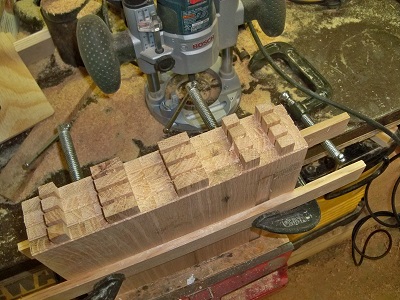

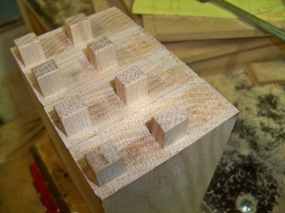

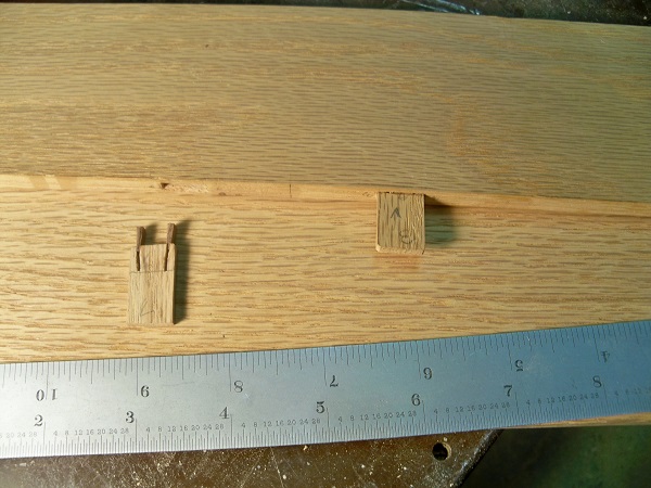

I am continuing to mill the tenons. I am thinking any wood would be better than this wood as it has a tendency split when routing on end grain.
- test 09.jpg (181.79 KiB) Viewed 23898 times
- test 08.jpg (190.72 KiB) Viewed 23898 times
- test 07.jpg (182.04 KiB) Viewed 23898 times
- test 06.jpg (184.99 KiB) Viewed 23898 times

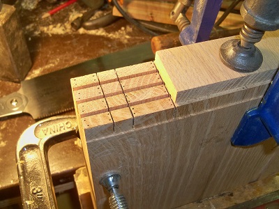

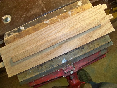

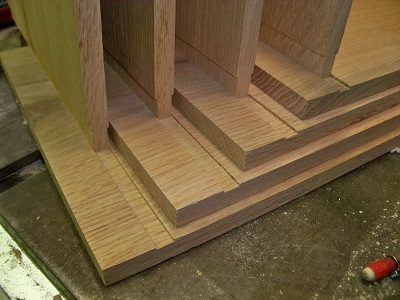

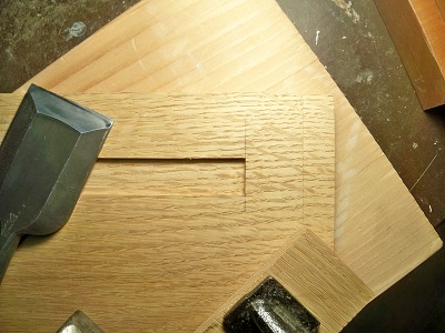

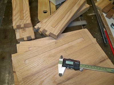

In between paying projects, the toolbox is progressing nicely.
- Captured tenons on dividers/tray supports.
- new test 2.jpg (192.77 KiB) Viewed 23891 times
- through mortises before cutting tapered sides for wedges.
- new test 1.jpg (240.58 KiB) Viewed 23891 times
